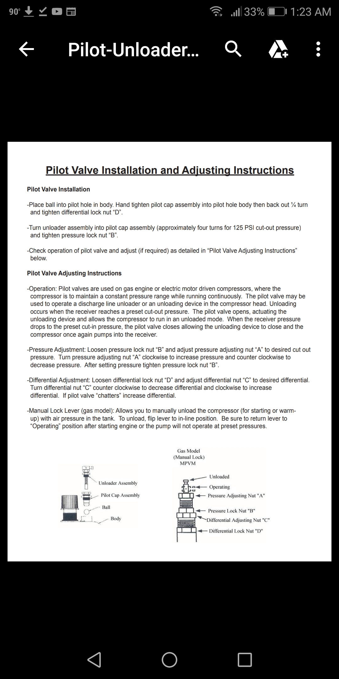

My brand new gas engine powered air compressor is giving me problems. I’m stumped and looking for some help.
It sounds like there’s always air leaking. I’ve tested all the joints I can reach and nothing seems to be leaking.
it cycles between running and idling even when no air is being used - verifying air leaking?
It will run for a couple of minutes (cycling between full and idle the whole time) and then just shuts itself down.
FYI, the regulator is set to 90 psi if that matters.
I’m waiting for the manufacturer to weigh in but does anyone have experience or some ideas I can try in the meantime?
