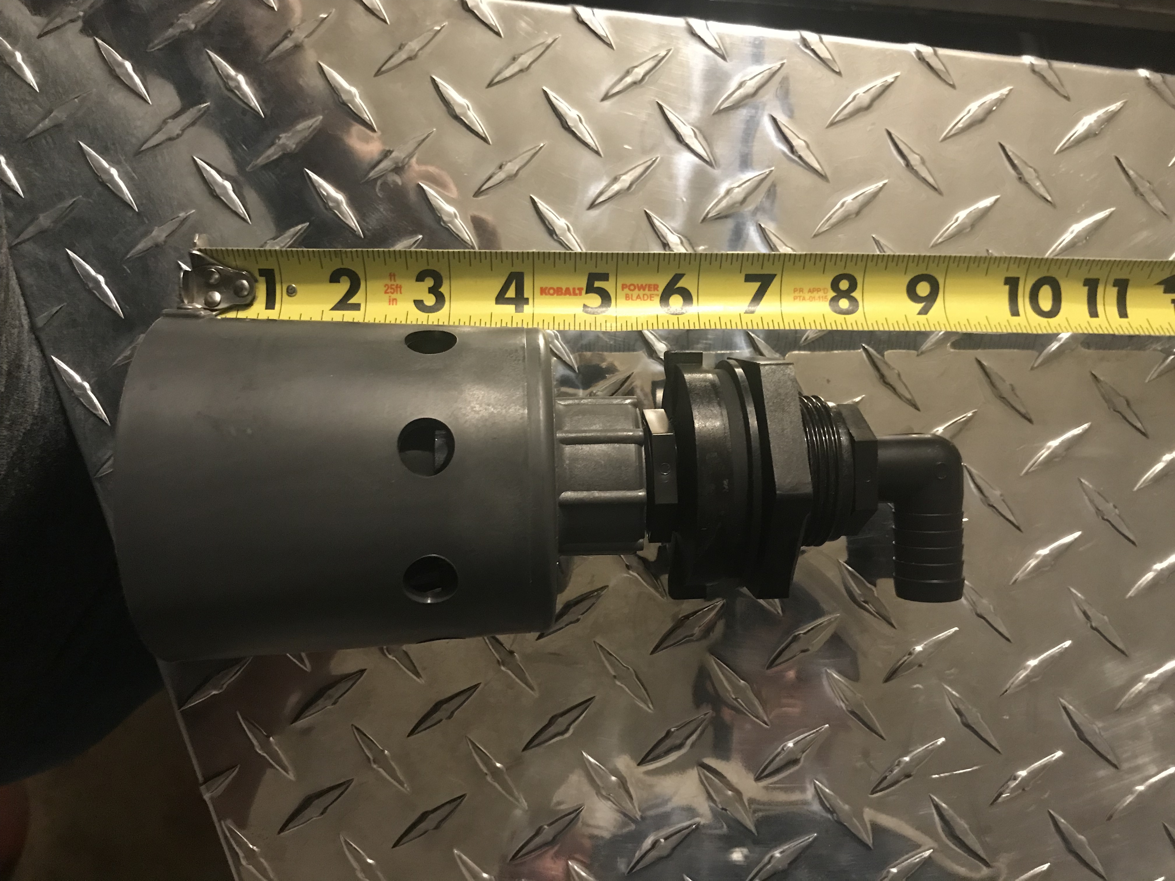

I’ve been reading about Hudson float valves but I haven’t been able to find how much capacity I will lose. 325 gallon horizontal leg tank 69x38x43. Does anyone have any idea with the valve what I’ll actually have?
About 6 inches. On a leg tank of that size you really won’t be loosing much capacity. It’s when your trying to run a smaller leg tank that it would be a concern.
