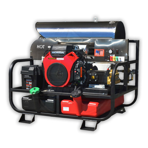

I am Building everything on a flatbed truck with two tanks totaling 500ga and a 1290 series Hotsey (5.6 GPM 3000PSI). Hotsey isnt cheap I know, anyboy have any comparable alternatives?

If you’re main thing is fleet washing then I’d go higher on the gpm and lower on the psi. 3000 psi will clean concrete. Definitely over kill for glossy painted aluminum. Not that you need any more gpms but you can definitely save money on the psi. Youd be fine with a 4 gpm machine. Hotsy is a great company and makes a good machine but you could do the same work with a good pressure pro. I just bought a new hot 8 gpm and did quite a bit of shopping around and found the big name brands ( Hotsy, landa, hydrogen, etc…) To be extremely expensive compared to what’s available online.
