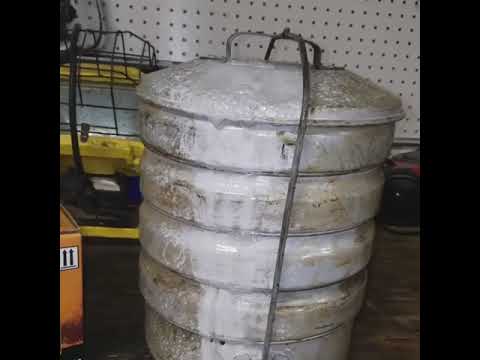

That chem looks wicked! But laffeyete is a far drive. In the second video that guy isnt wearing any gloves :disappointed:
That’s the least of the concern in the second video. Please know what your doing before just spraying acid on someone’s truck. It might be different if it’s your own neglected trailer. He might as well have painted that fender white not to mention his technique is horrid. That video and this one should be labeled what not to do. Simply amazing aluminum brightener!!! - YouTube
So much for the nice polished aluminum toolbox. Although I haven’t been able to find one I’m pretty sure there’s a part two where he paints the toolbox black since he basically prepped it for paint in the first video by acid etching it and ruining the polished aluminum. At least there better be a part two…haha
@Rusty
Thank you!!! it makes my skin crawl every time someone mentions “brighter”!!!
X100000000 on painting it white!!! :rofl::rofl:. People have no idea what it takes to fix aluminum after 30 seconds of liquid destruction!!! I’d much rather have road film than crusty white “clean” tanks.
Just a few applications and the aluminum looks like the surface of the moon…
