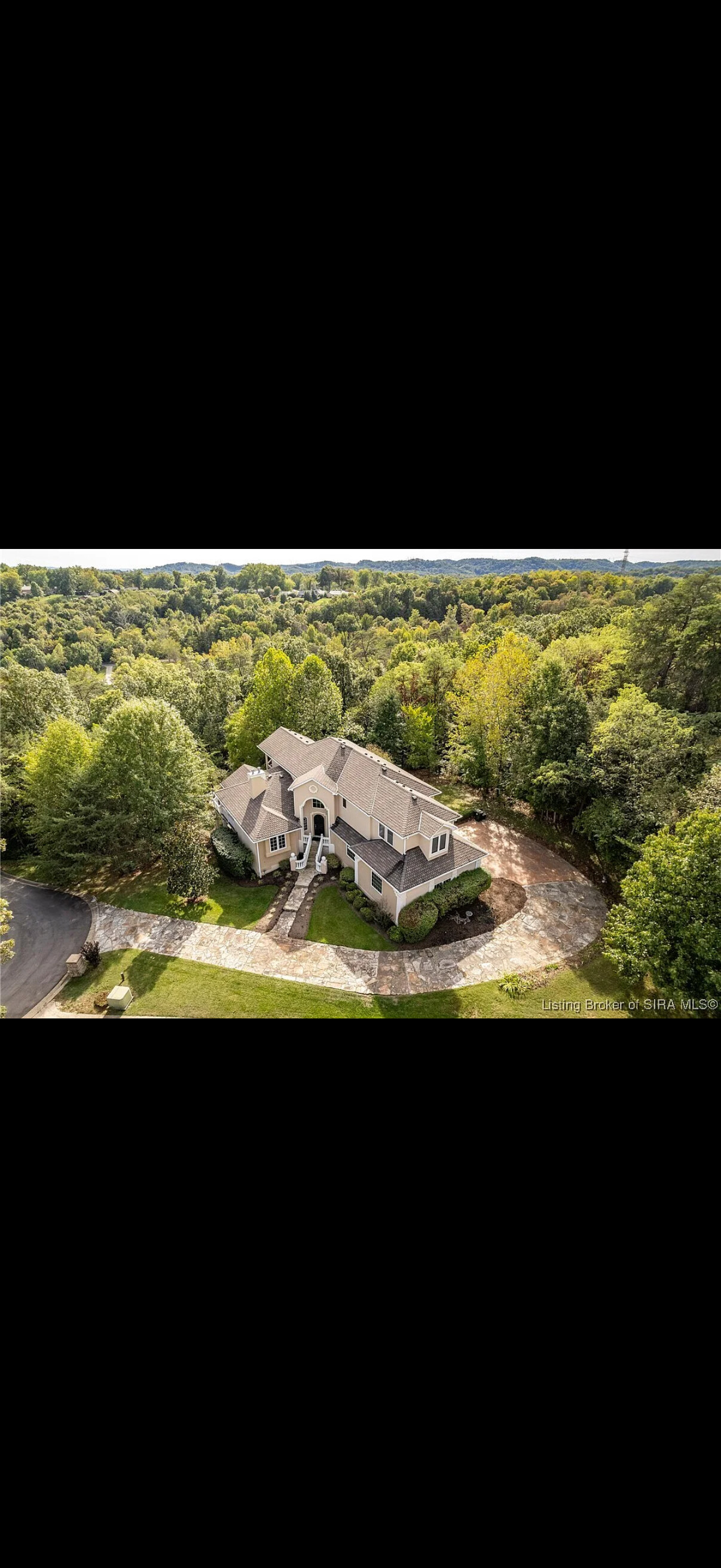

I was contacted to bid this driveway, he refers to it as ‘flagstone’, and before I make a major mistake i thought you guys might want to have a look.
I’ve read threads about flagstone, some say the usual surface cleaner under 2500psi, others talk about high percentage SH and rinse but I’m not trying to kill his grass.

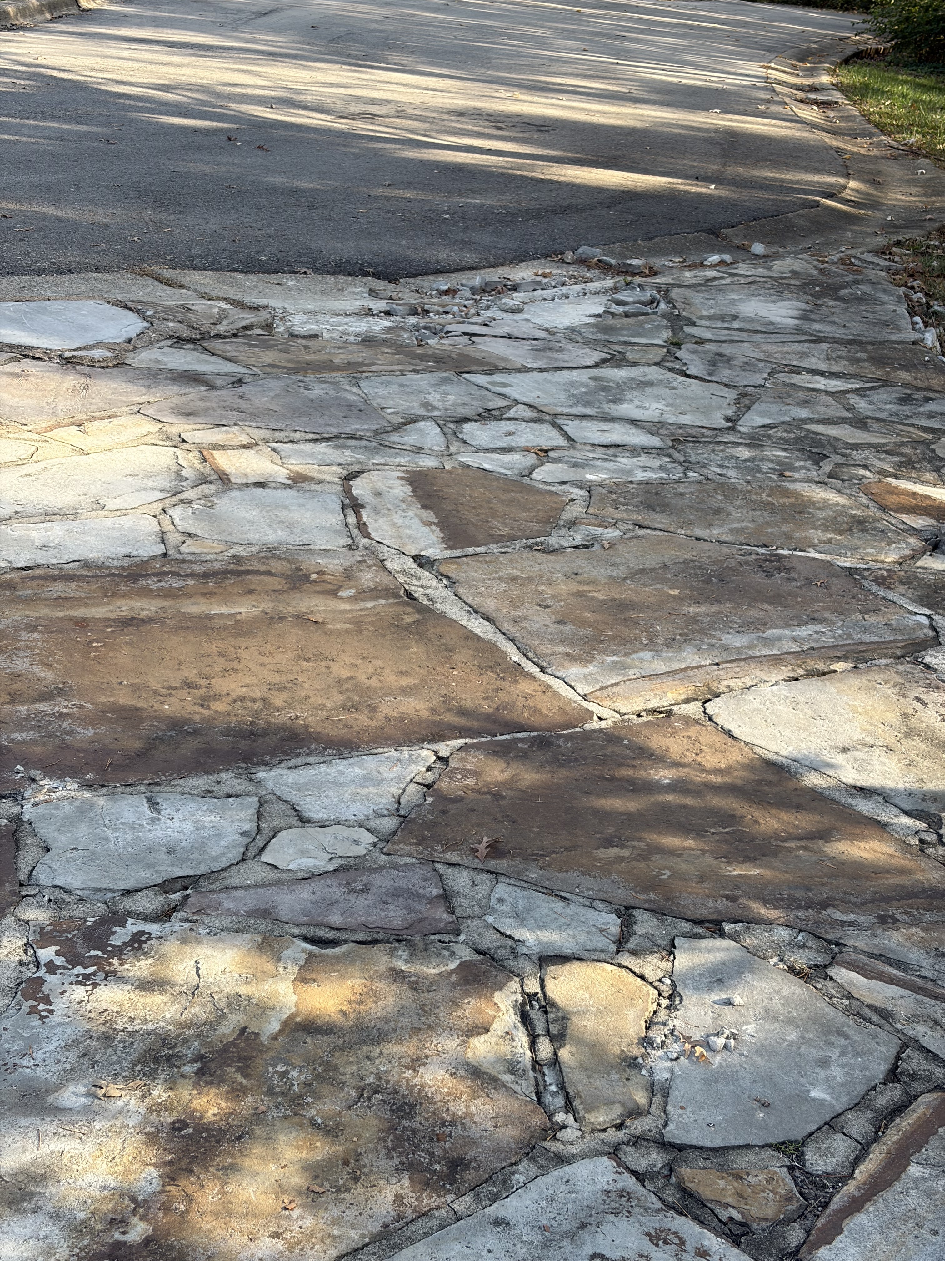

Those pics make it hard to tell if it is real, but it is definitely dirty and the concrete is colored and dirty too.

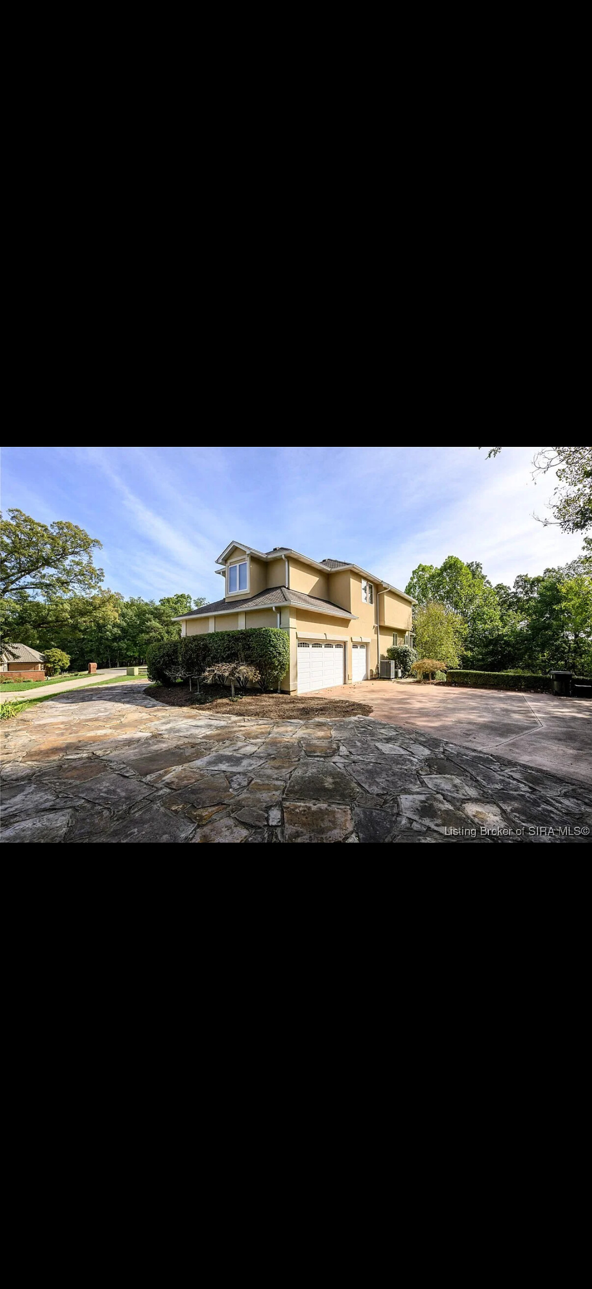

I did the estimate today, what a mess. He called a company to repair the mortar damage but they told him to get it cleaned first before they can repair it. It’s close to 4000 sq/ft including a bunch of stairs and a down the hill patio.

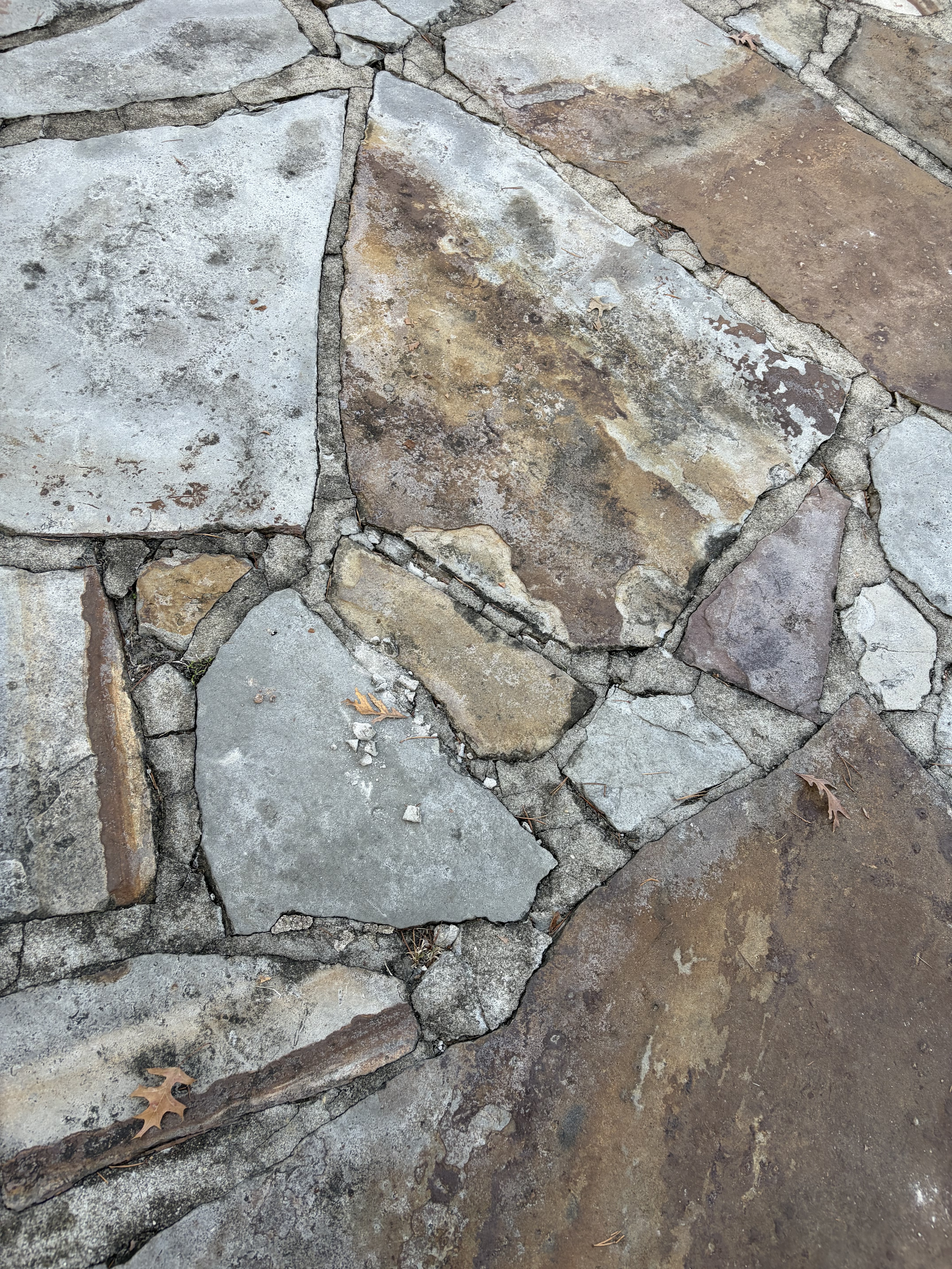

I’ll be honest I’m not sure how to approach this one. Some of the patio and driveway can be surface cleaned but this stuff is just gonna wreck it
Interesting conundrum: can’t clean until it’s repaired, and won’t repair until it’s cleaned. I would suggest that perhaps he found a lazy contractor (the repair guy, not you), and maybe get a 2nd opinion. Then maybe offer to treat it and rinse it lightly to kill biological growth to prep for repair; then give him a quote to clean as you had planned after the repairs are done PROPERLY. Tell him he has a lovely home with a potentially wonderful drive, set expectations and let what happens happens. From what I see, doing more would be exposing you to a potential experience you won’t want to share on here or anywhere else. Just my take…
That looks rough to clean….going to kick up a lot of mortar. Almost have to nuke it and rinse carefully, see what that looks like. Set expectations and cover your tail on those mortar joints.
I’d want some clarification on what their expectations are for “clean” and what they plan on doing afterward. Hot mix and rinse repeated 3 or 4 times should take care of the cleaning, but do they expect all the crumbled pieces to be removed? Is that your responsibility, are they planning to remove everything and refill it to make it uniform again, or are they just going to patch or pour directly over what’s currently there?
If they’re going to be replacing or refilling it anyway, using a surface cleaner on everything might not be a bad option. It can’t get much worse, and if they’re redoing it regardless, any additional disturbance/removal of debris in the joints probably won’t matter much but would give them a better starting place.
Brock- For the right price and based on how busy you are- I would consider offering to remove all the loose mortar- blow, spray, surface clean, turbo, sweep - whatever it would take. Collect all the loose mortar bits and remove.
Then nuke the stone and rinse or SC as well. Leave it ready for the company to come in and re-mortar.
