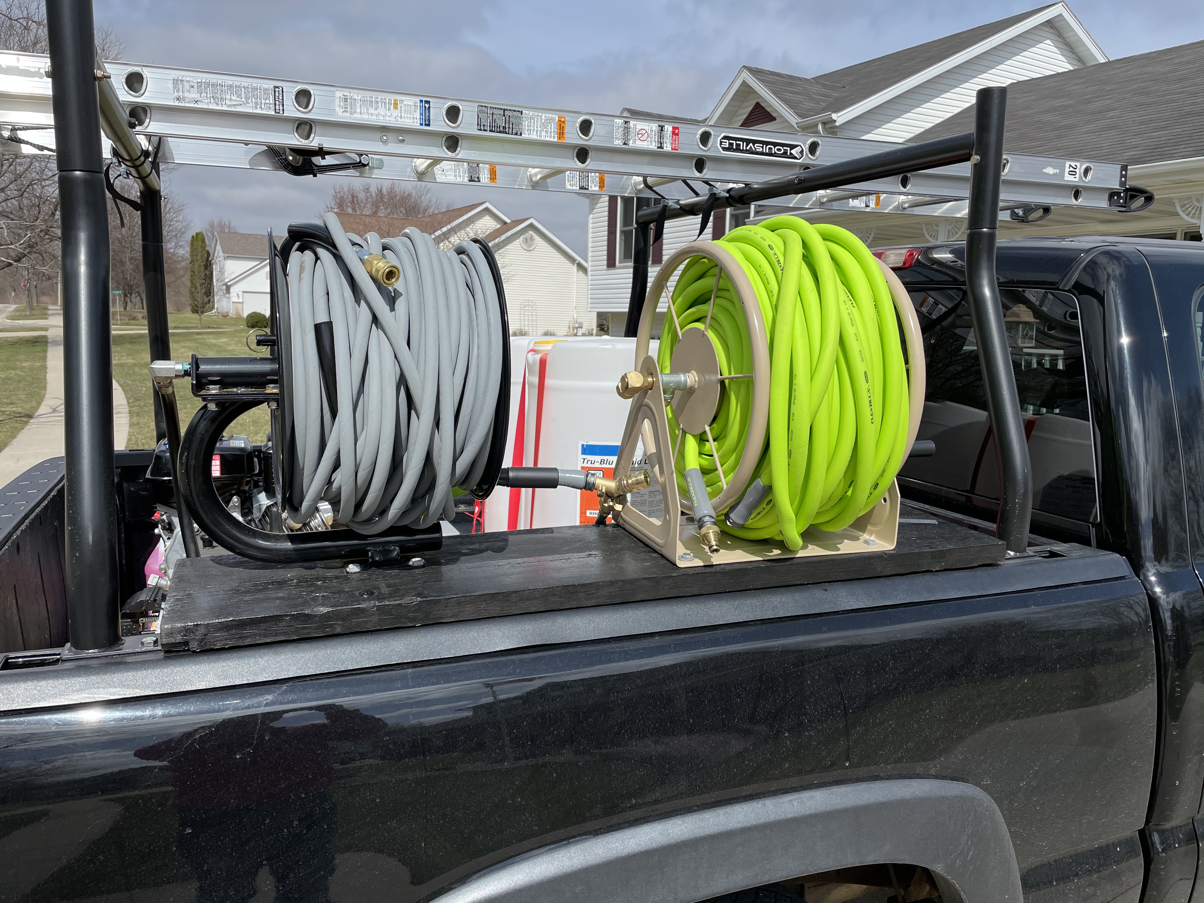

You really need to find a vendor that will set that up correctly for you
Once I have money I want a skid for sure just working with what I got at the moment I know it would be much more efficient.
It hurts looking at how those hoses are so messy on the reels.
Fix the hoses make them neater
Thank you I did that this morning looks way better thank you guys.
Good luck to you this year wish you the best
Thank you very much you as well hope to have a skid sometime this summer as this set up sucks.

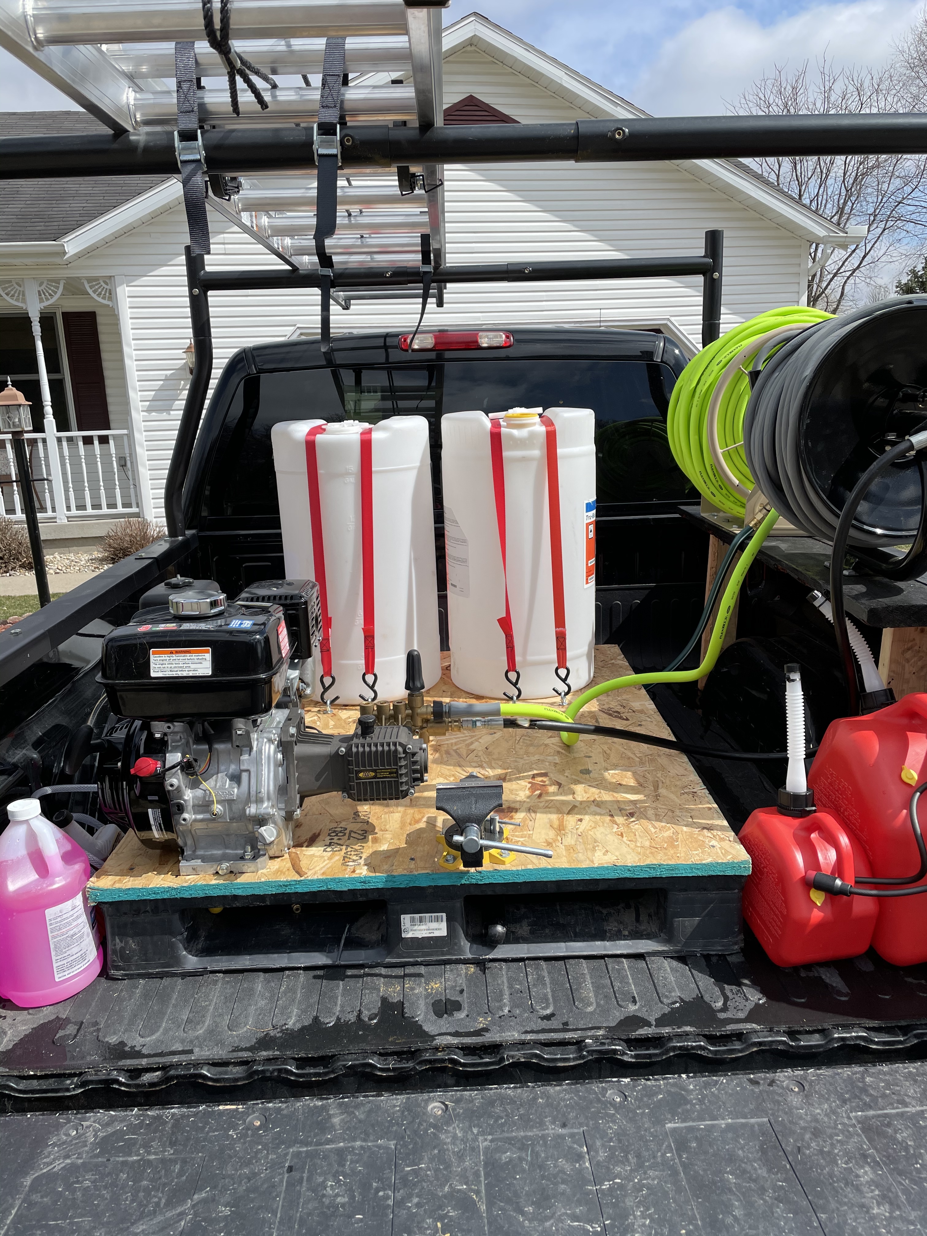

You really need to shorten that supply hose on the direct drive, ok if you have a buffer tank that compensates loss but I wouldn’t feed it with that much hose.
Thank you do you think 100 would be safe ?

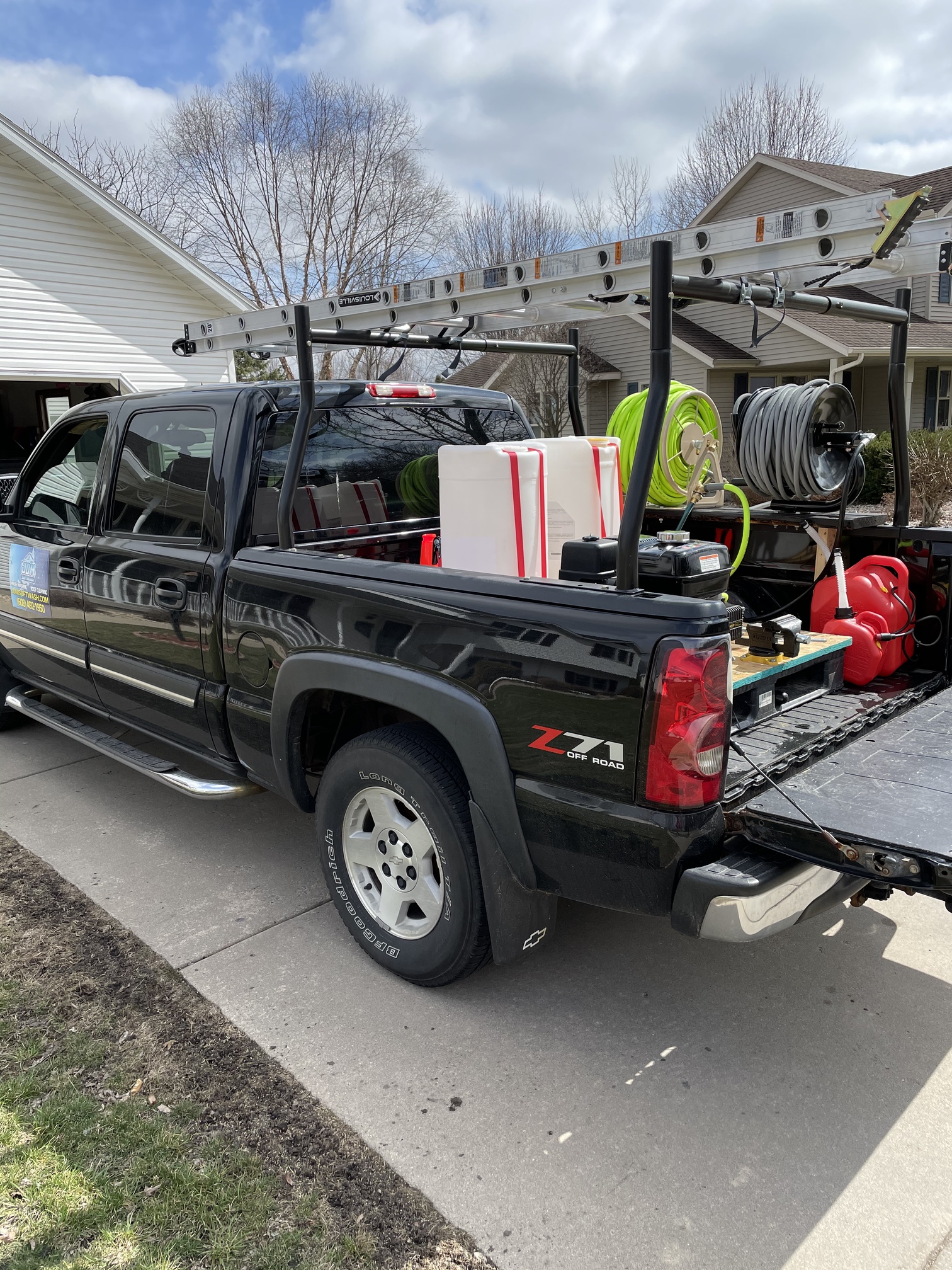

How has that truck been treating you? I always liked those models!
It’s hard to say how much you need as areas vary in accessibility, key note being that friction loss and hose kinks are real and pumps need good water supply.

It’s been great man got a very good deal 120k miles for 8k.
That particle board should be the 1st to go. Get some steel tubing and cut it yourself to make a skid frame that you could bolt everything to, and have someone weld it together in the very least. 2x4’s with screws could work too, but it should be deemed very temporary.
Thank you I was also looking at an aluminum pallet possibly and getting a aluminum mount for the pressure washer with rubber feet for vibration.
