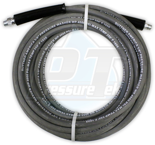

200 ft of suttner hose (I’ve already got 100’ of yamatic):
