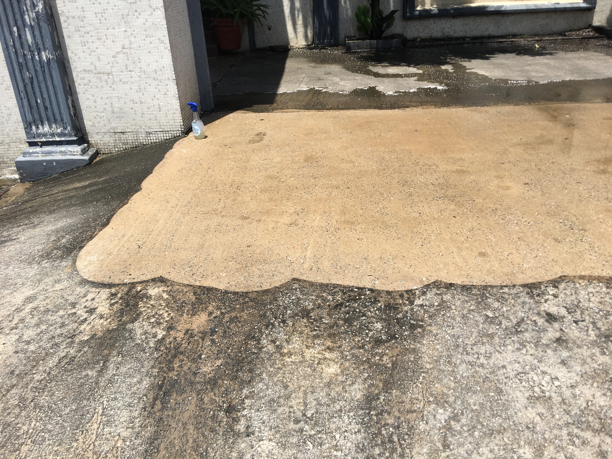

I have done a test wash with a mix of basically about 5% SH and no surfactant added. I also did a test patch of the obviously dirty concrete floor. I haven’t yet been given the floor job but i am hopeful that the walls will come out much better than it presently is and would subsequently land the massive floor job.

Wow, is the entire building covered in those tiles? Also that floor test spot was a great idea show them what it could look like.
