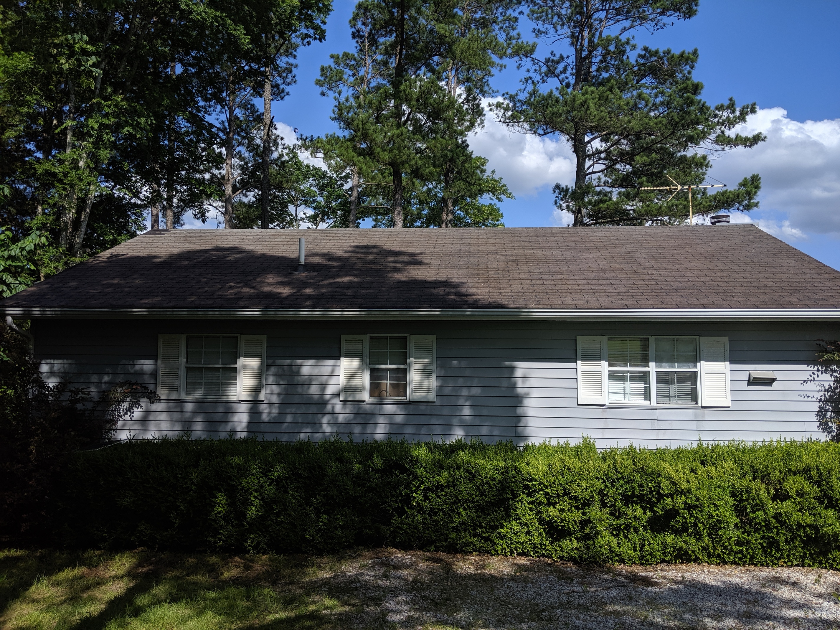

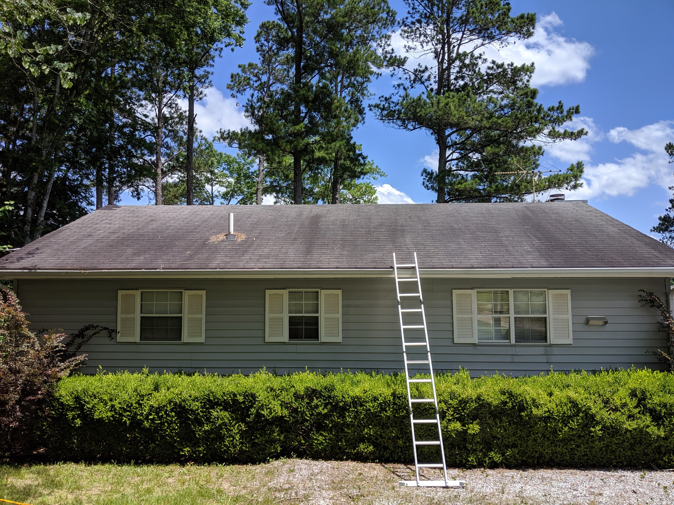

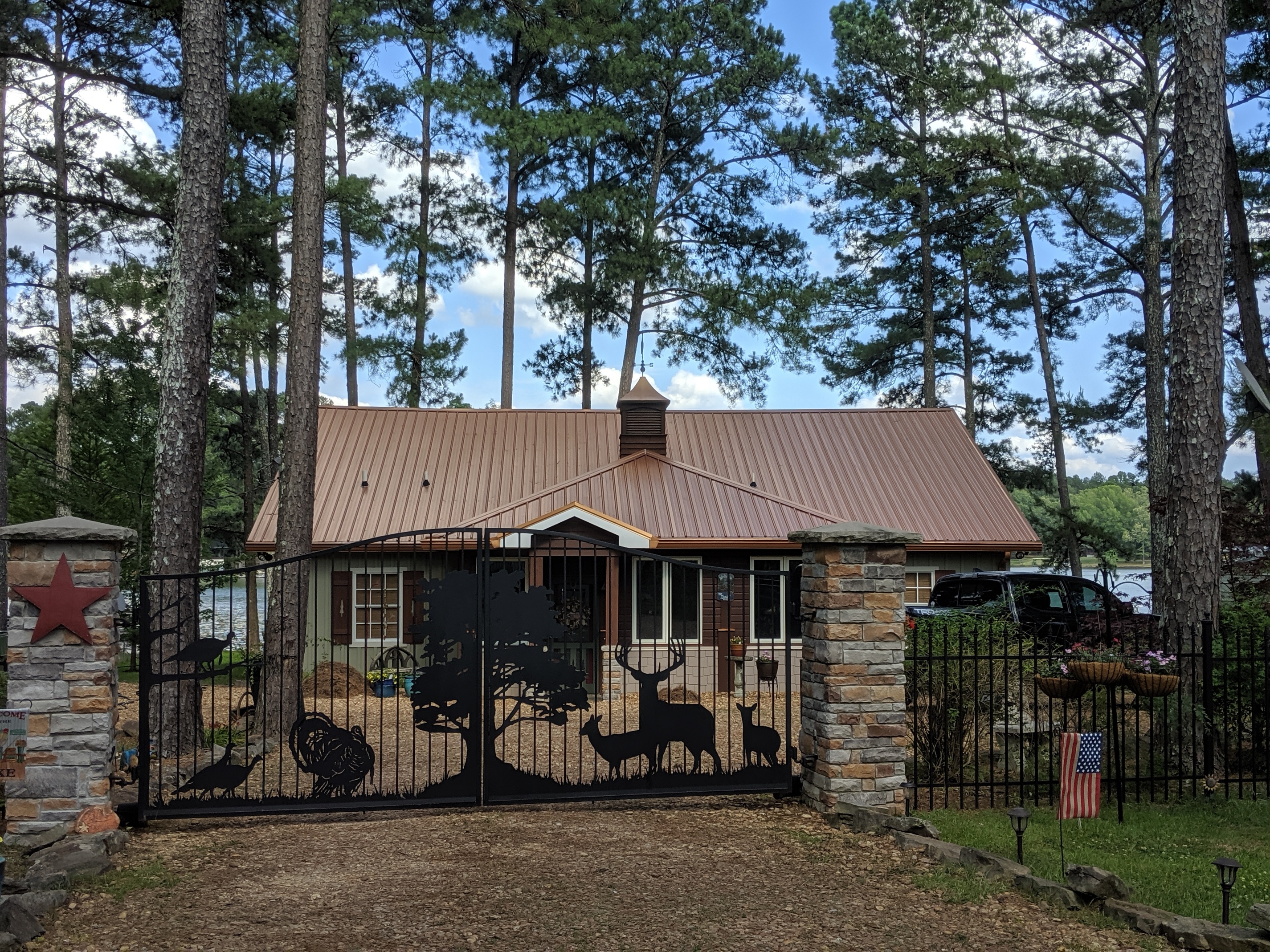

Alright I did my first pair of roofs today. One was copper-colored tin or aluminum and the other was standard shingles. The client was very happy but I just want to get a little feedback on my results and pricing.
I quoted $500/each for house wash and roof wash, and one had a small wooden deck and the other had a small stone walkway. Each house is 1 story and in the 2000 square foot range. I used a Fatboy setup with a Pro-Mix-A-Lot.
Here are the before and after pics.
I had to hit the shingle roof a 2nd time and had to do some small retouches on the copper one. I’m not sure if that was because my surfactant wasn’t strong enough but I was using cling-on that’s been sitting out unopened for at least a year. The first time on the shingle roof I walked it and sprayed standing up but the second time I bent down and really got close and that got it a lot cleaner.
Also, what do you do for a slippery roof that you also have trouble reaching the peaks on? I slipped and almost fell off trying to walk the copper roof and decided to hit it from the gutters but I had a really hard time getting the peaks.

Both look good. You got good money on both. Pine needles can be a pain. Be careful with your ladder, esp how you have on the shingle roof. You want it about 75 deg. A lot of ladder injuries come from kick out. Stand with your feet at base of ladder and lean ladder out till your arms fully extended - that’s about the angle you want. Get you a stabilizer too.
Keep up good work.

Yeah…never walk a metal roof more than just a gentle slope. Even a dry one has dust and pollen on it, and those ordinarily sticky soles on your shoes turn into ice skates once they get coated.

Technically it is a 4 to 1 ratio for the ladder. 12 ft up, 3 feet out. 16 ft up, 4 ft out…eg. Sorry…I am a SH Manager :sweat_smile::sweat_smile:
