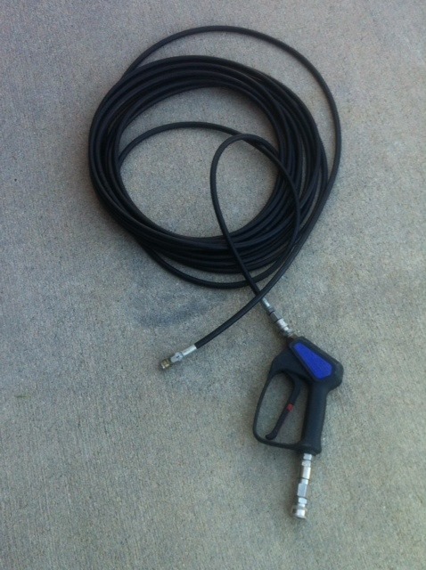

I use this!

Cdubbs where did you get that or was it home made.

Can’t remember we’re I got it, but most places have them. 50’ jetter hose and drain jetter nozzle. Attach to gun with quick connect.
