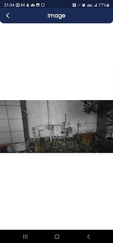

We need pics.

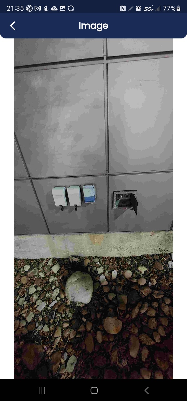

In the last picture, you can see the Aluminum (?) Panelling and the size of the stucco panels. Im gonna test spot alot but figured just some sop and water on the metal panels, save the SH for the Stucco…

Def. test those panels well, but it looks like you’ve got that covered.
You have a pic of building or any pics taken in daylight? Other than concrete what you have doesn’t help a lot. How much of the building is the Aluminum looking panels? They’re probably Alucobond and you don’t really want to use much SH on, if any There are special soaps made for them and in nearly all cases you will need to brush. Stucco in pic doesn’t look that dirty. Most you can probably ds.

As far as daylight pics, sadly not…Im a Paramedic so that was the only time we could sneak away and get any pics and do an inspection. As for the metal panels, I wasnt planning on using ANY SH on them at all, just water and some soapy soap, I have a ladder and a couple of wall brushes with poles for some light agitation at eye level and above. The overall building really is mostly clean, minus the junky walkways…I Am curious to see how a SC on a 4gpm does compared to a 2 5gpm. Any advice on getting tire rubs off the curbs? Never had em before…I was gonna just turbo nozzle em and see what happans, but wanted a backup idea. Client stated she really doesnt care about the curbs on the far side of her lot, so I figured Id play some mad chemist for future learning!!
