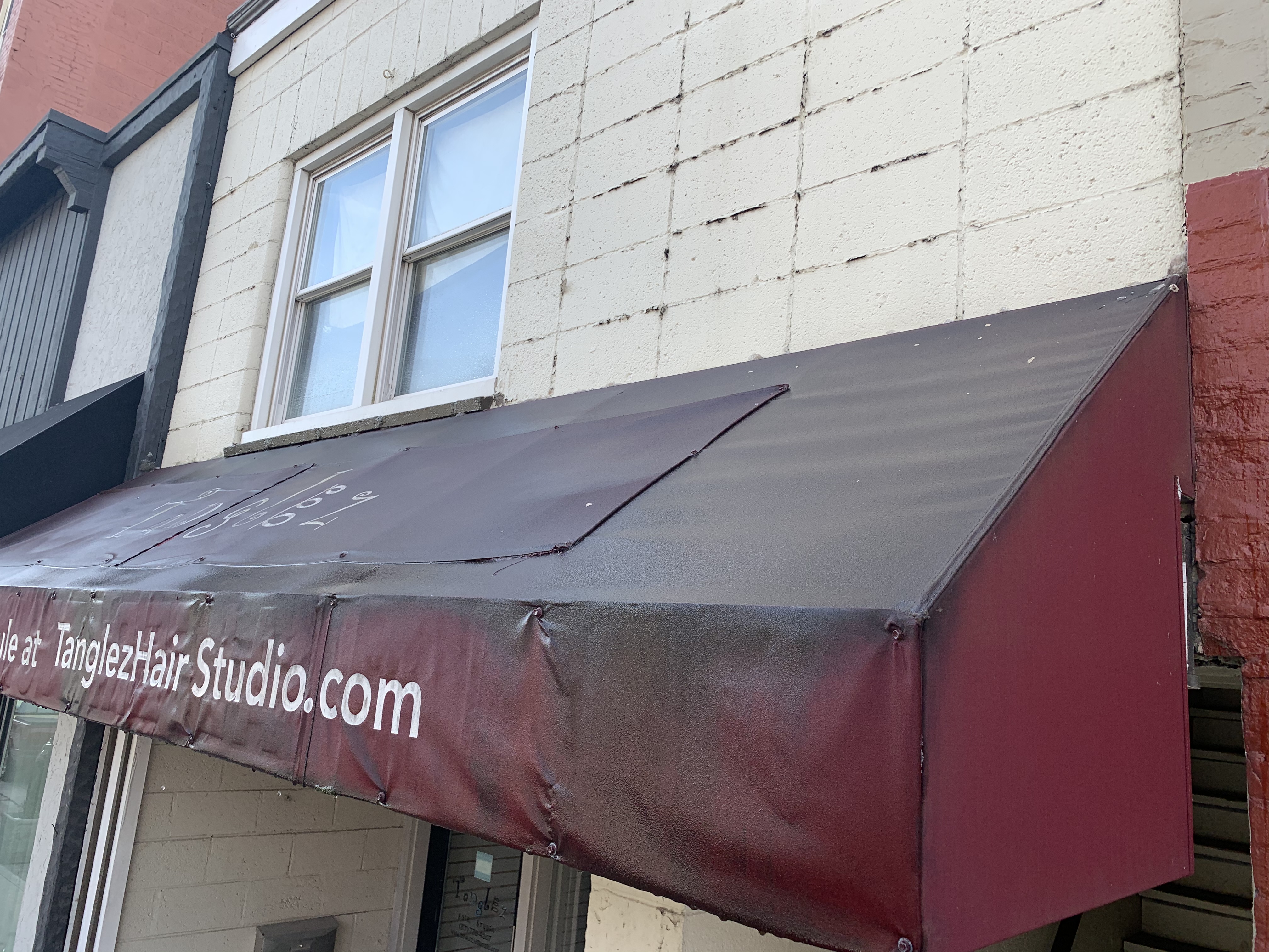

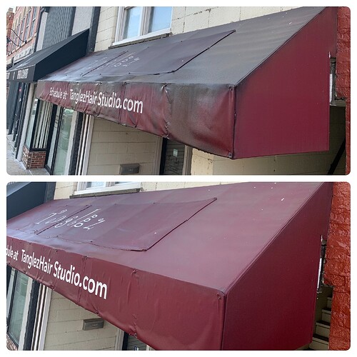

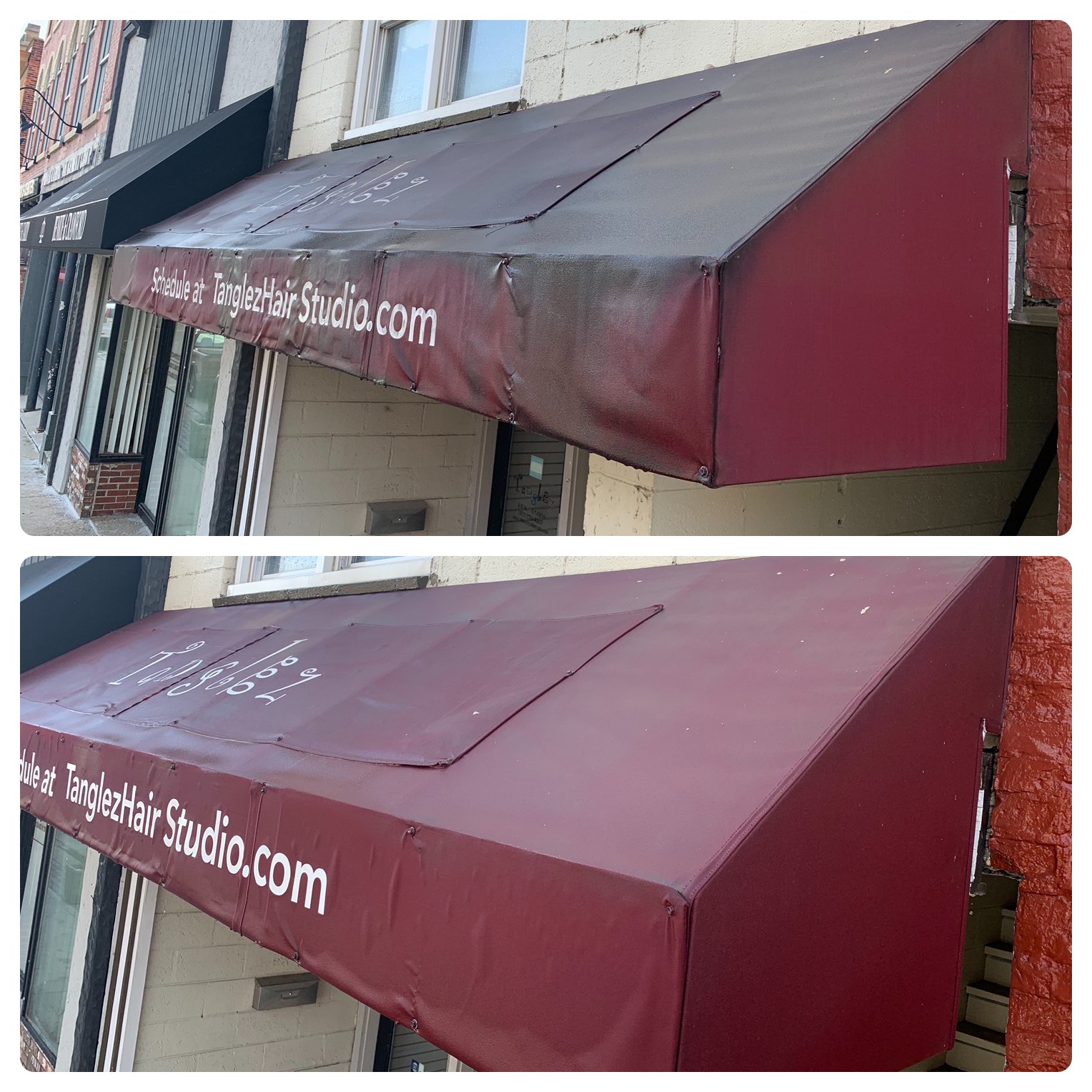

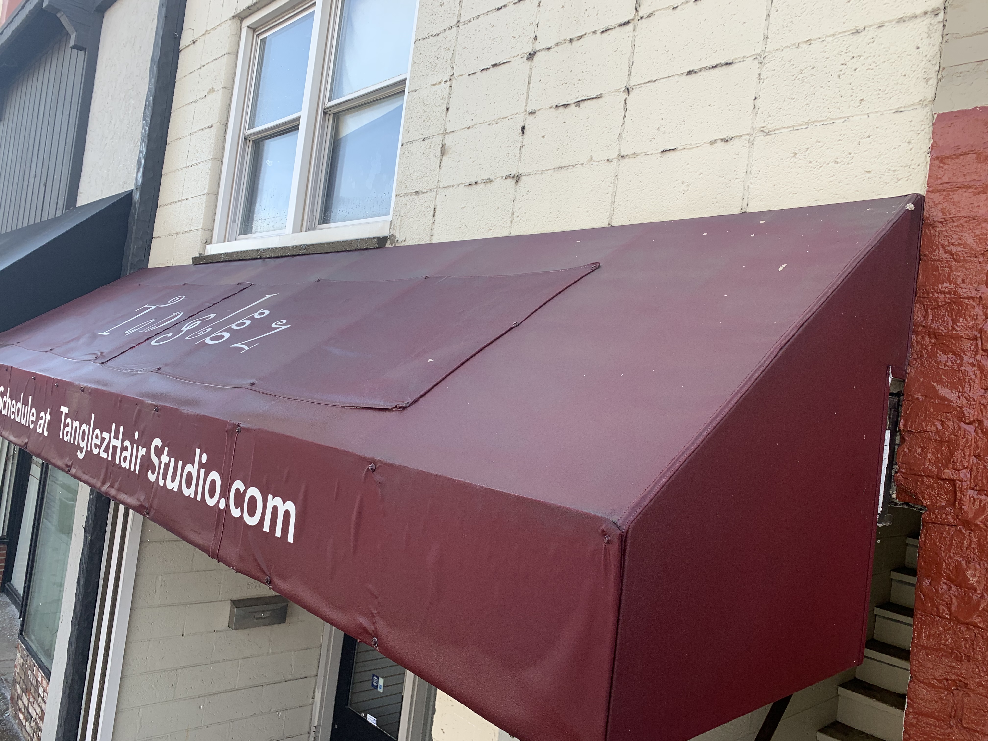

Got my first awning cleaning. It has been 6 years since she put it up and it was pretty bad. She was thrilled and I was eh. I watched @squidskc video and some others. I wet it down, hit it with 50/50, agitated and rinsed and did that about 3-4 times.

It looks great. Remember you’re a pressure washing company not a awning company. It’s not going to look brand new, because it isn’t. You did a good job cleaning it. Now you know what to expect in the future.
I appreciate the kind words. I may have had my standards set too high on this, and most my jobs. I was hoping that red would pop again. But I think it may have been neglected for so long it’s just trying to polish a turnip at this point.
The red may have never popped. If the shop owner is pleased you should be too.
It looks good now. But will pop a lil more on the color burgundy after it dries. Well done man.

It should look a lot better once dry

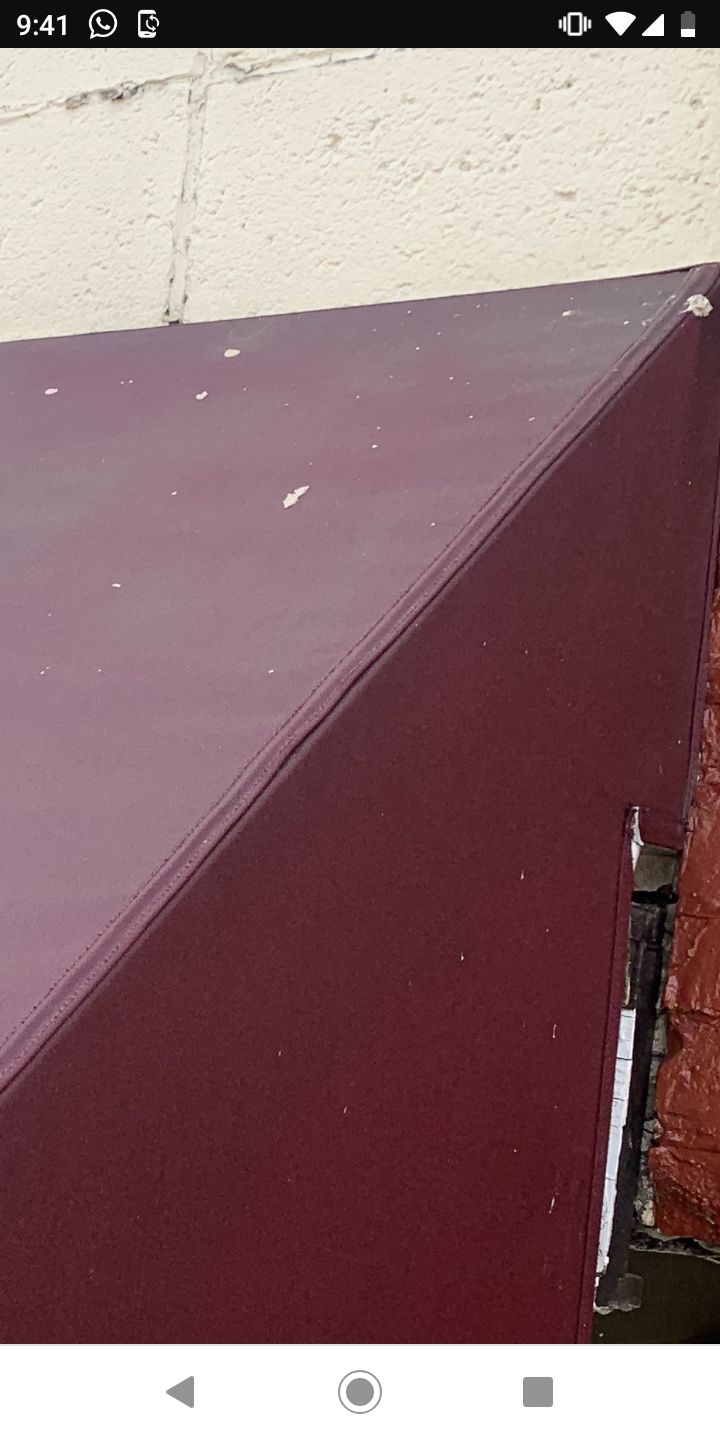

Those little white bits are chipped paint from above the awning. I used 50/50 12.5% with a pump sprayer. First I wet the awning down, applied the 50/50, dwell for 10ish minutes, agitated with a brush and rinsed with my 12v. Repeated 3-4 times
