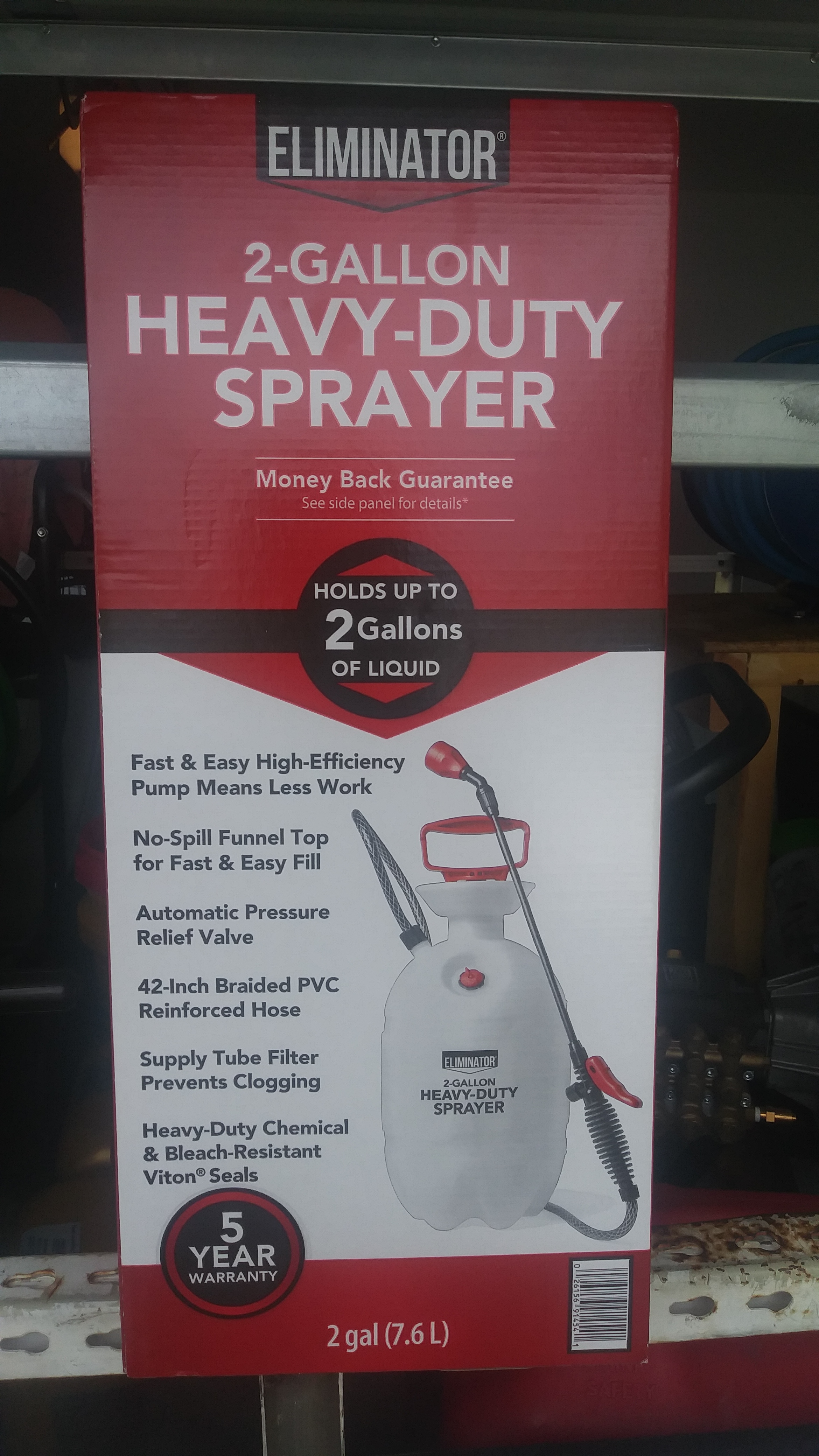

Hey guys I found this at wallmart, it has a 5yr warranty and they approve the use of bleach with it. It was about $20.
I have been having decent luck with Chapin bleach pump sprayer
I just picked up a couple of the two gallon sprayers from walmart the other day. You must live in California or Canada because they’re only $12 here though.
I’ve been using the one gallon size for oxalic, one for degreaser, and another for sh since the beginning of the season. They spray for a good amount of time with little pumping or at least compared to other cheap sprayers I have owned in the past. The one gallon only has a 2 year warranty but for $6 they’re basically throw away. I especially like the pressure release valve on the side.
I also have the Chapin sprayer that Surface Therapy mentioned. It’s specifically made for bleach and have been using it since last summer. I’ve had sh in it the whole time and it still works fine. It has brown seals so I assume they’re viton.
