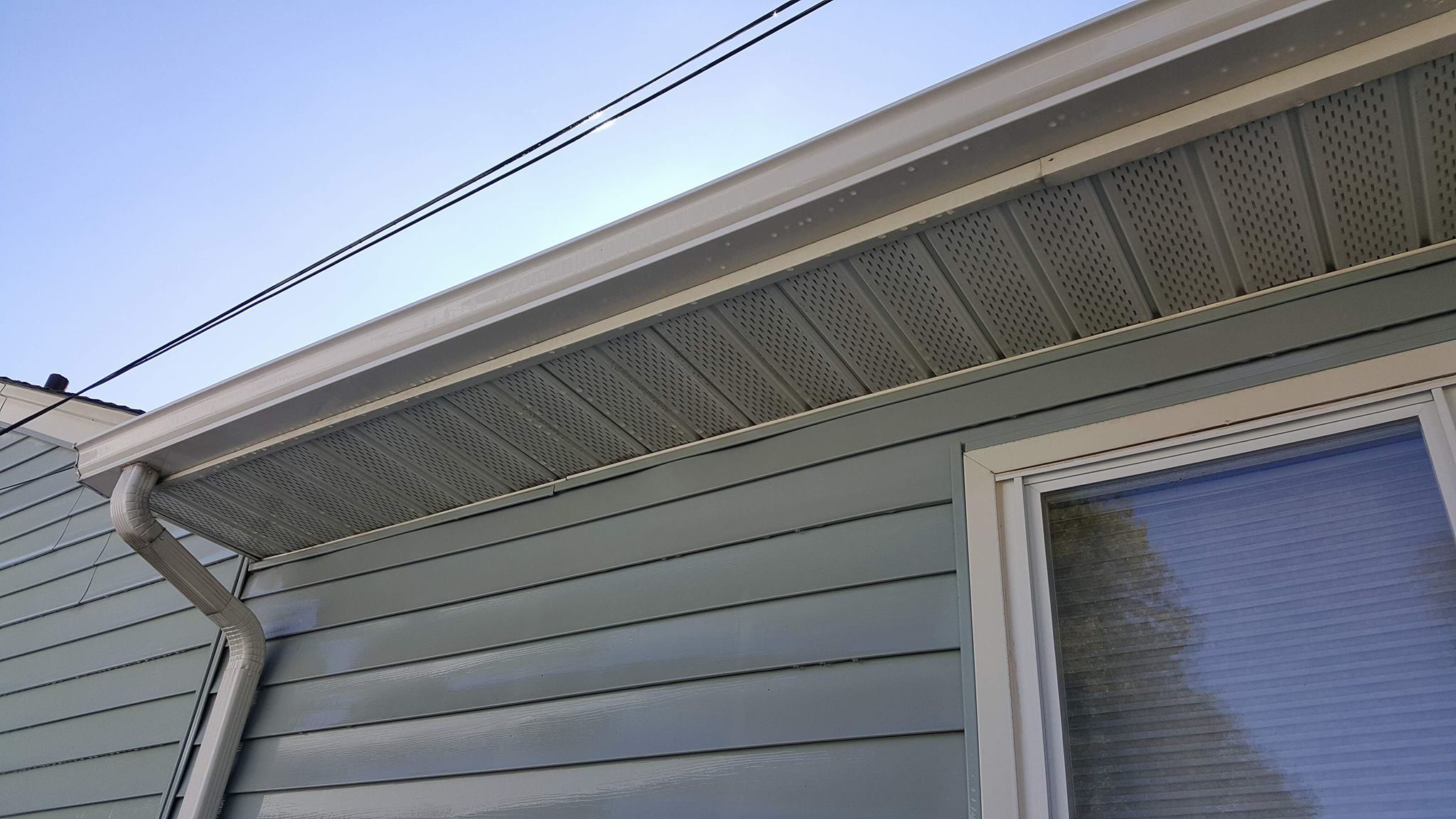

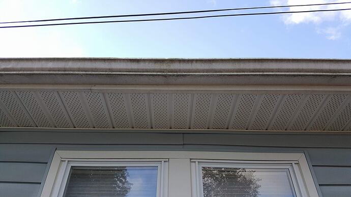

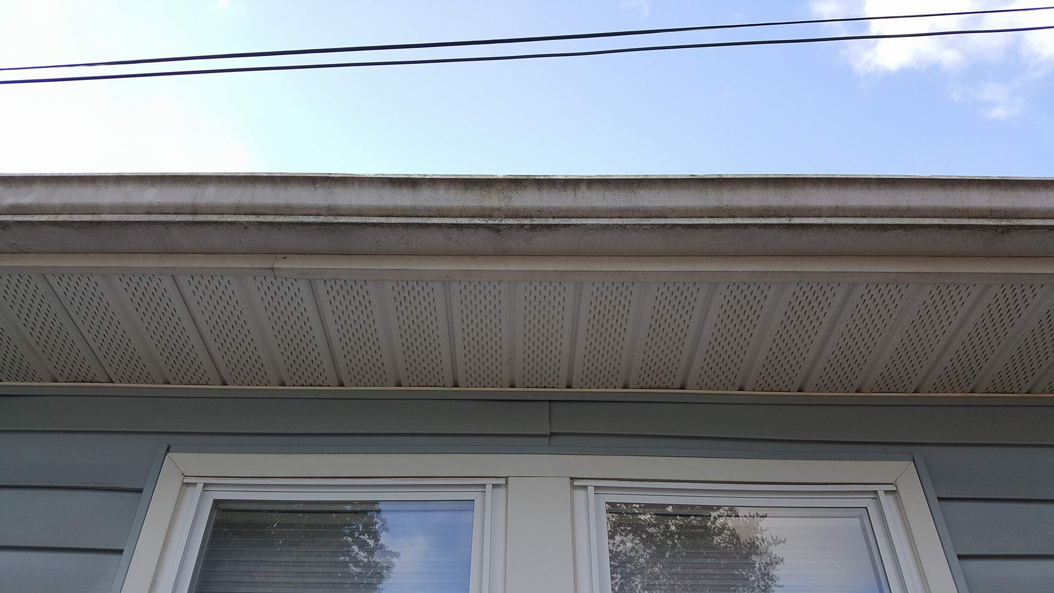

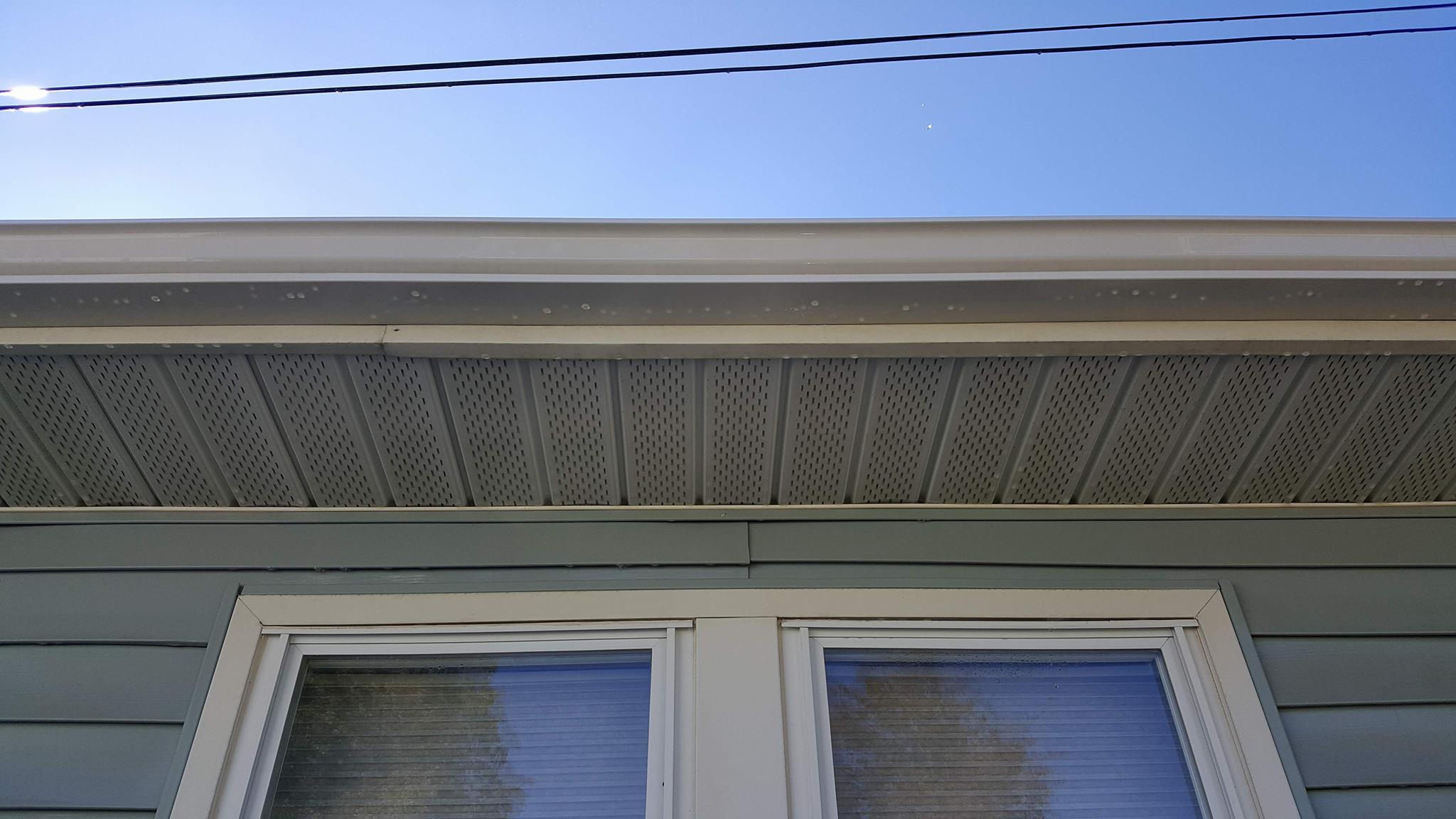

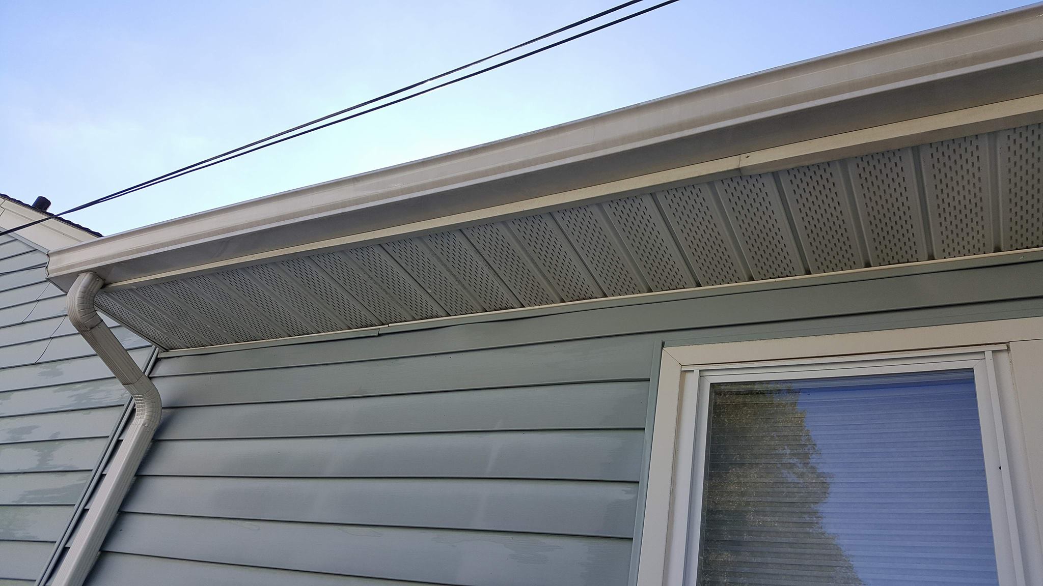

Before:
After: Cleaned with bleach and then f-13
Before: only cleaned with bleach. Probably some oxidation showing.
After: f-13 scrub
You have 3 pics that are clean. so ur saying the first clean pic is one that u used just sh on? If so I wanted have wasted the time with f13 bc it looks pretty Dang clean.

Gutters look good tho can’t tell much difference in the 3 clean shots

Just a little oxidation. It was more noticeable in person.
