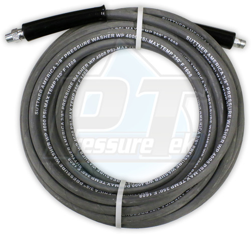

I want to extend my pressure washer hose. I have the 50’ hose that came with the unit and was thinking of buying a 50’ hose to extend to 100’ Is this ok? If so, what’s the best method to connect the two hoses?
PRESSURE PRO 4000psi 4gpm unit
This is the 50’ hose I want to buy.

You should be fine. You can use quick couplers if you want to take them apart or a JIC live swivel if you don’t.
Steve
July 24, 2017, 5:55pm
5
Actually, that hose in the picture looks like it already has a swivel and fittings so all you would need would be a female to female coupler.
