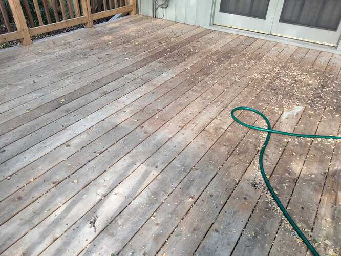

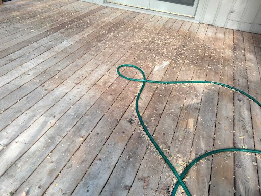

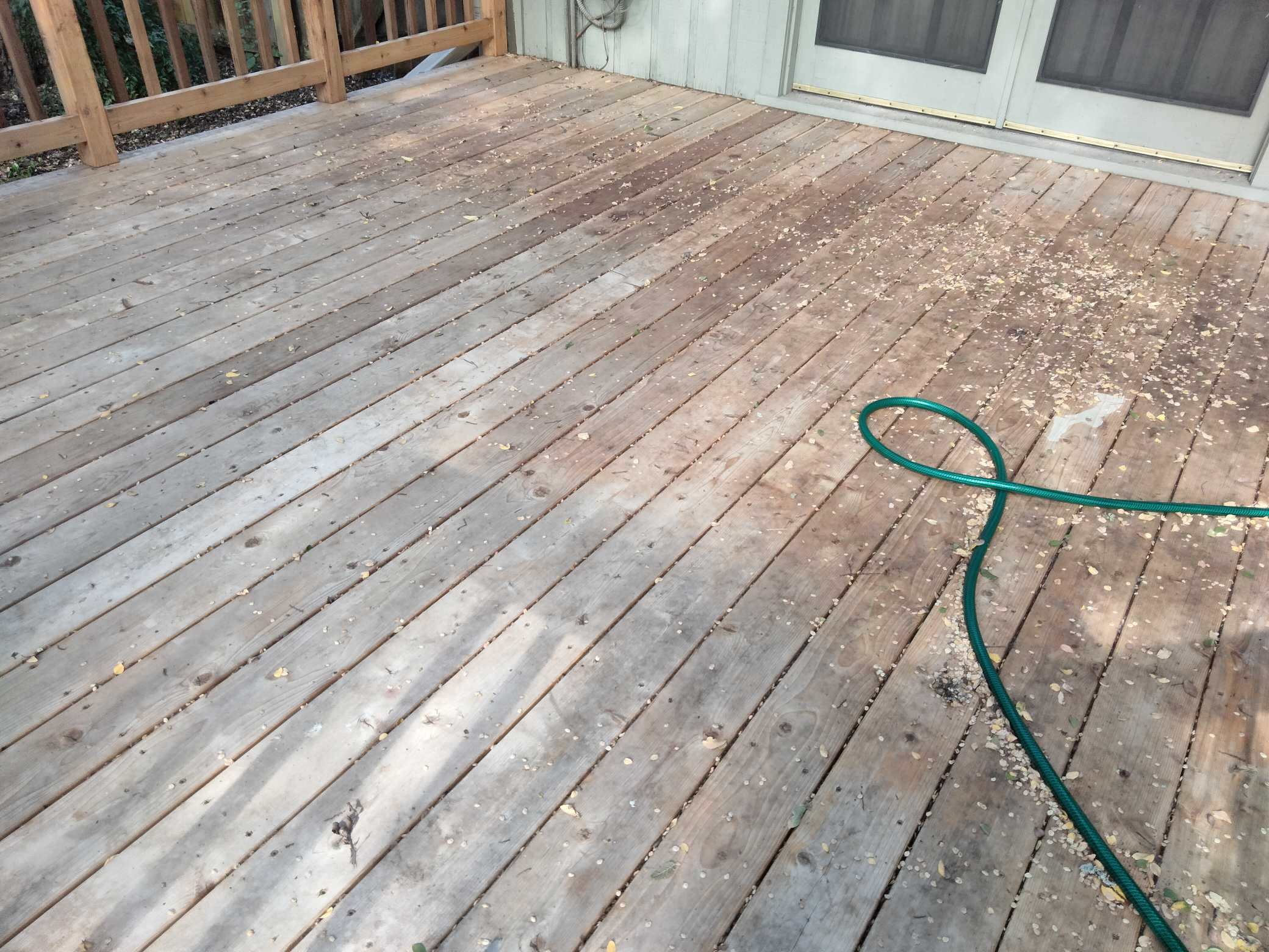

I have a customer who I followed up with to see if he was happy with the work we did on his chimney 2mos back. He replied saying not only was he unhappy with it but that he thinks i damaged his wood deck’s finish. See pictures. NOTE: The white dots are leaves.
For context, I was soft washing his limestone chimney and to hit the back of it from the ground my SH/surfactant mix was rolling down the roof above the deck. There was a gutter catching almost all of it but I also covered the deck with tarps. Again, this was 2mo ago.
Reviewing this again, I’m not confident this is damage from me. The graying looks like natural color change from UV. The reddish parts sees like the finish is just about to turn gray. I can’t find many bleach damage photos for the life of me, but it seems like those would be much more white and blotchy. There may be a small white blotch at the right of the second photo. Otherwise, natural color fading.

Hard to see anything in that photo with the debris and shadows.
What is he asking for to make it right?
I don’t really see any damage? Did you take before pics? Did you wet the wood down real good. I don’t use tarps to cover but even when we do roofs, we soak the decks down good and it seems to do the job. I soak them too if we do house wash too, just out of precaution. Not sure what to tell you, not sure why he wouldn’t have told you after the job. You having to call as a checkup then he says that, seems weird? Hope you get it resolved.
What it is is clean spots on the deck from the SH compared to the older dirty part of the deck that’s gray. Eventually it will turn gray again and all match. If the guy wants it to look uniform you may just have to wash his whole deck. There isn’t any damage though.

I think the important takeaway is to always take lots of photos of the condition of everything in the area before you touch or do anything. You know… cover your butt. Also, in my view, tarps on decks aren’t the answer. Where they meet up against the house there will always be a chance for the runoff to leak under the tap, where you then CAN’T rinse it off.
Without any other info, to me it does look like the decking has been discolored from your SH runoff. I’d probably just offer to clean the homeowner’s deck to get things to look more uniform in appearance. Don’t beat yourself up over this, just learn and move on. We’ve all been there or somewhere similar.
To those implying that “discoloration isn’t damage,” I kind of disagree… and so does the homeowner. Getting the right color and appearance is a huge part of what we’re paid to do when cleaning bare wood. Leaving it blotchy isn’t cool.
