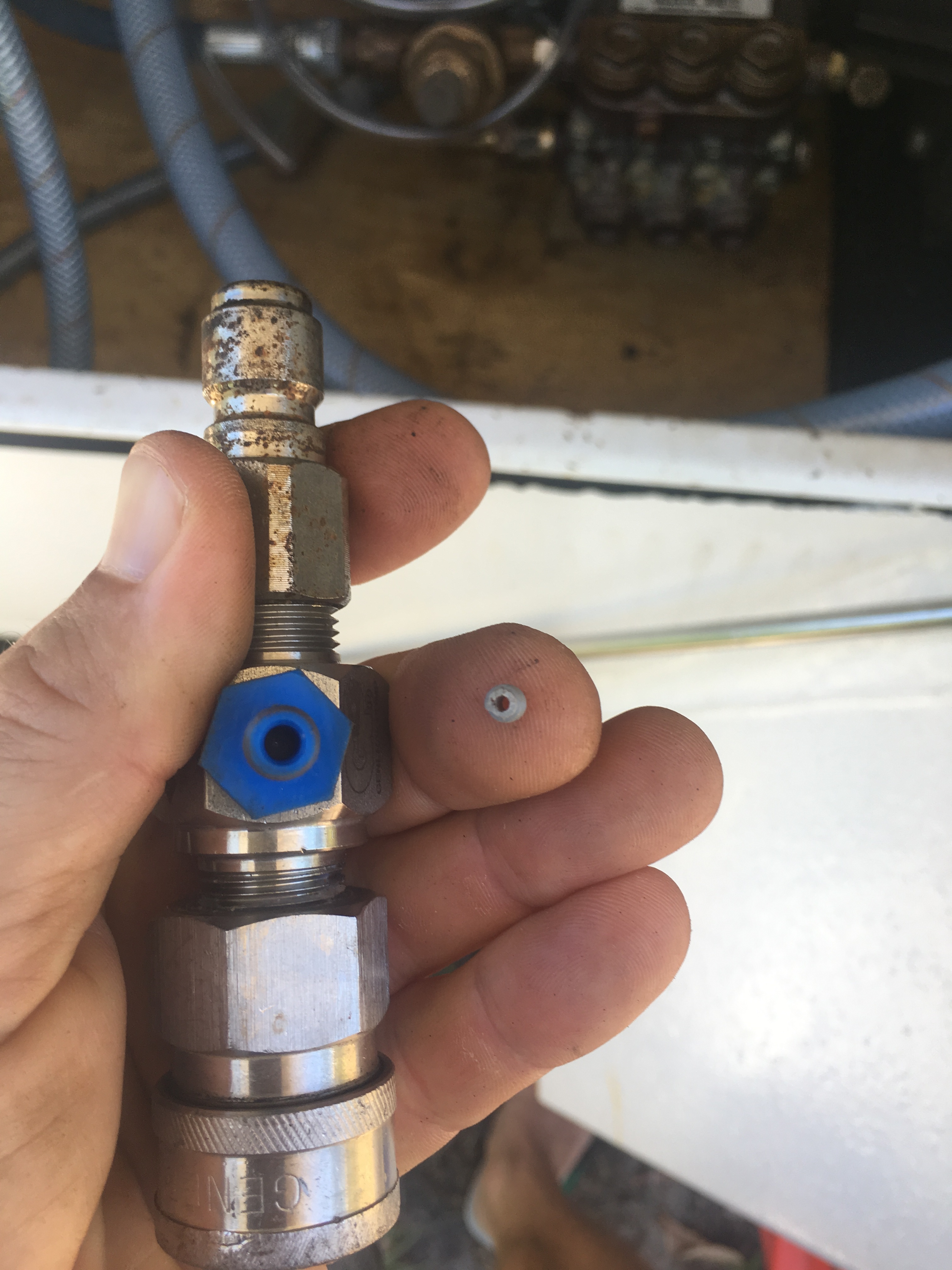

They snap off easily in the Barb. Drill out all of them to the same size as the grey one.
@Innocentbystander did you actually drill them or use something like a dremmel tool?
I pinched them in my fingers and ran a drill bit thru them. 5 seconds. I did a couple with some small round files for my welder but drill is quicker

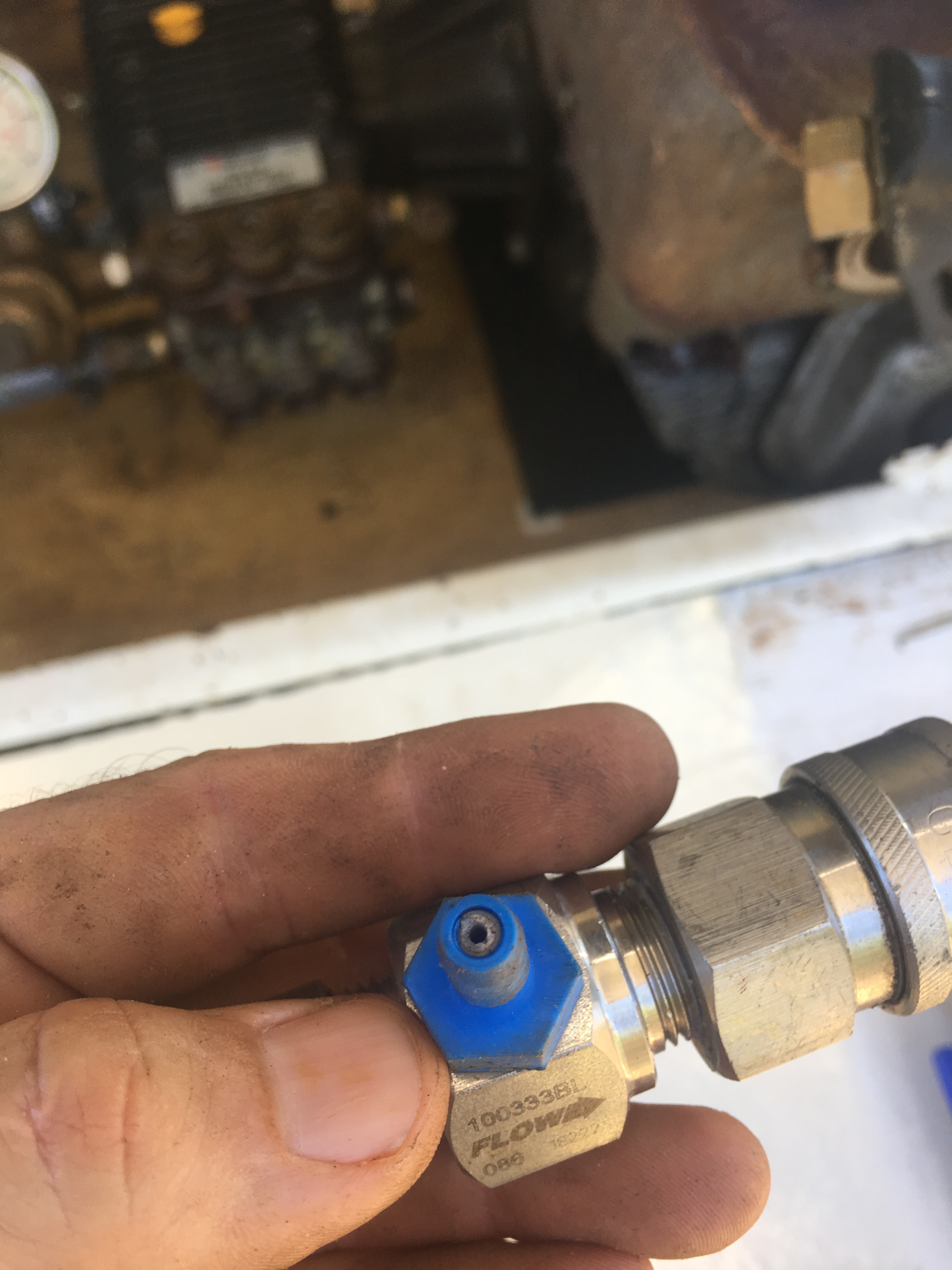

Just thought I’d share the metering tip break and also the difference between the grey tip and no tip at all. It’s a huge difference.
Explains the rapid drain of my chem tank!
You have the injector plumbed backwards I believe. Male end leads
Told ya! Everything is backwards on my set up!
