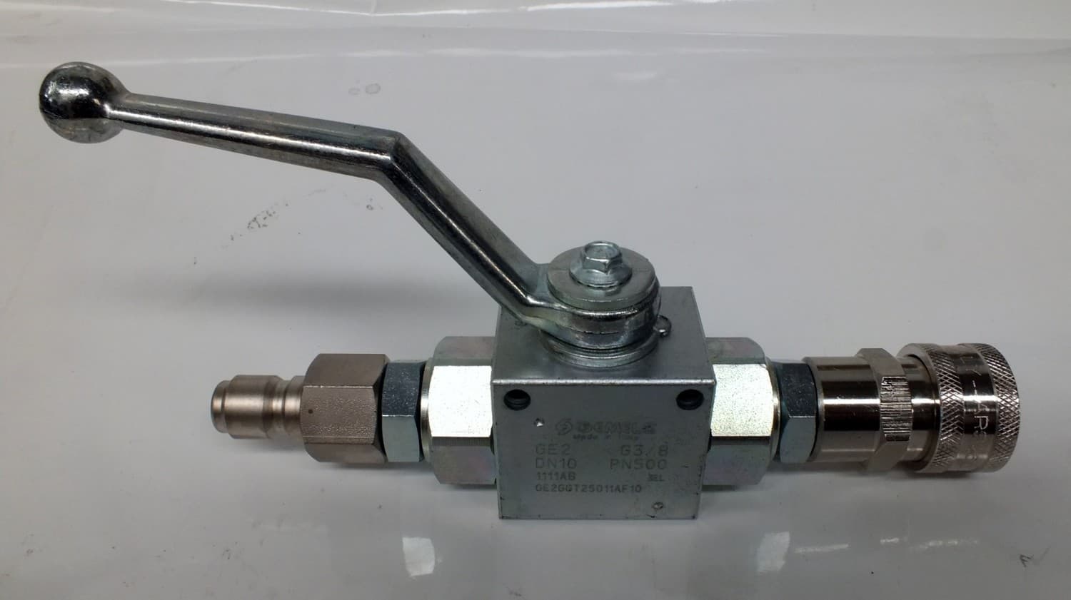

Are you keeping the trigger open while you’re trying to start. If it ran fine for 45min find it hard to believe that all of sudden your valves out of adjustment. or you have oil in the carb. Easy to check the oil thing though. sounds more like you’ve got vapor lock. Keep the trigger open or your ball valve until you get water running thru it.
Just take the gun off, yiu wont jave to press the trigger.
Used to do that before i got my 8gpm and buffer tank.
If you are referring to after shutting machine down, then yes, I do that as well. I just let it flush down a curb at the end of the driveway.
