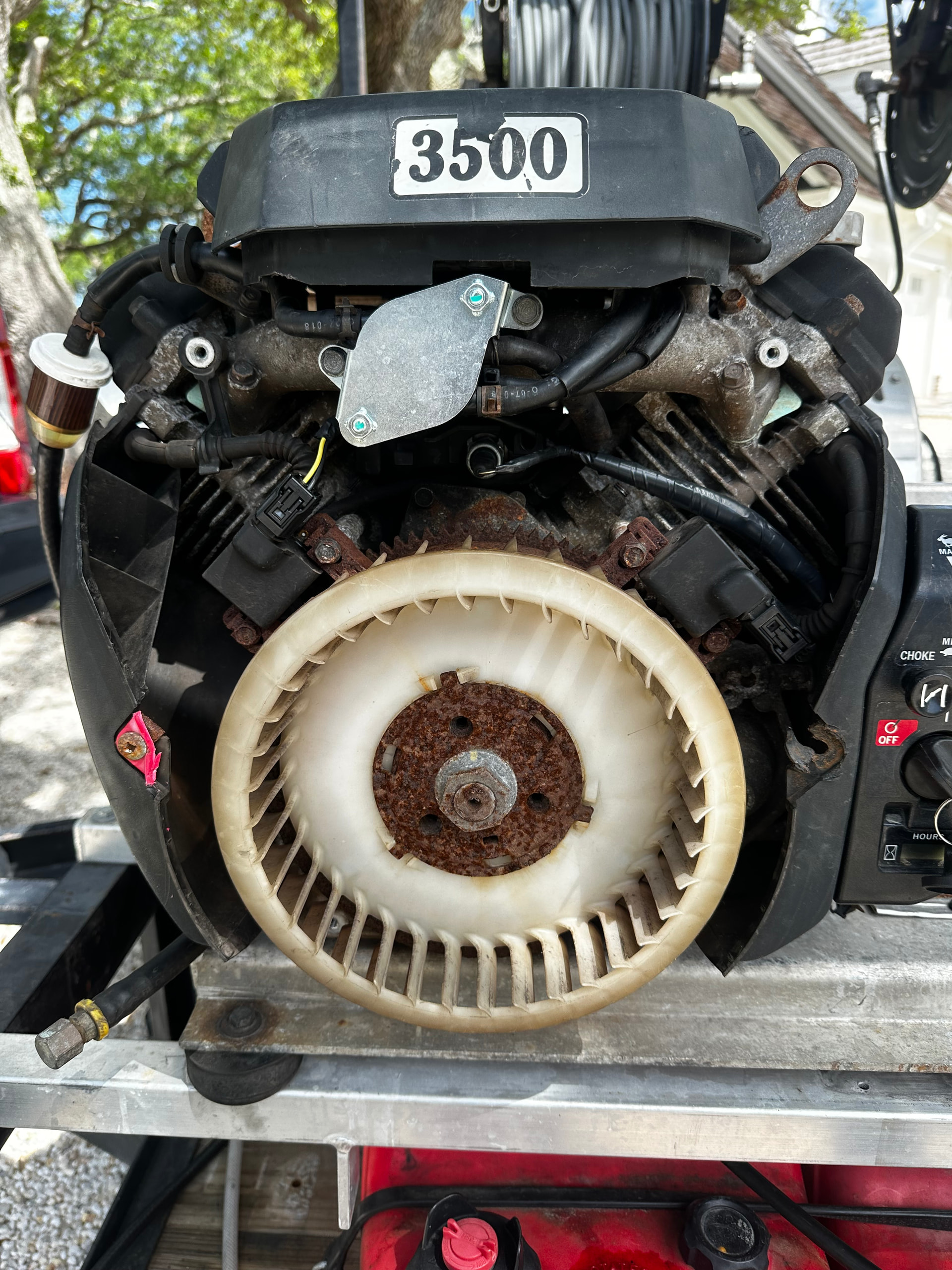

Honda Gx690

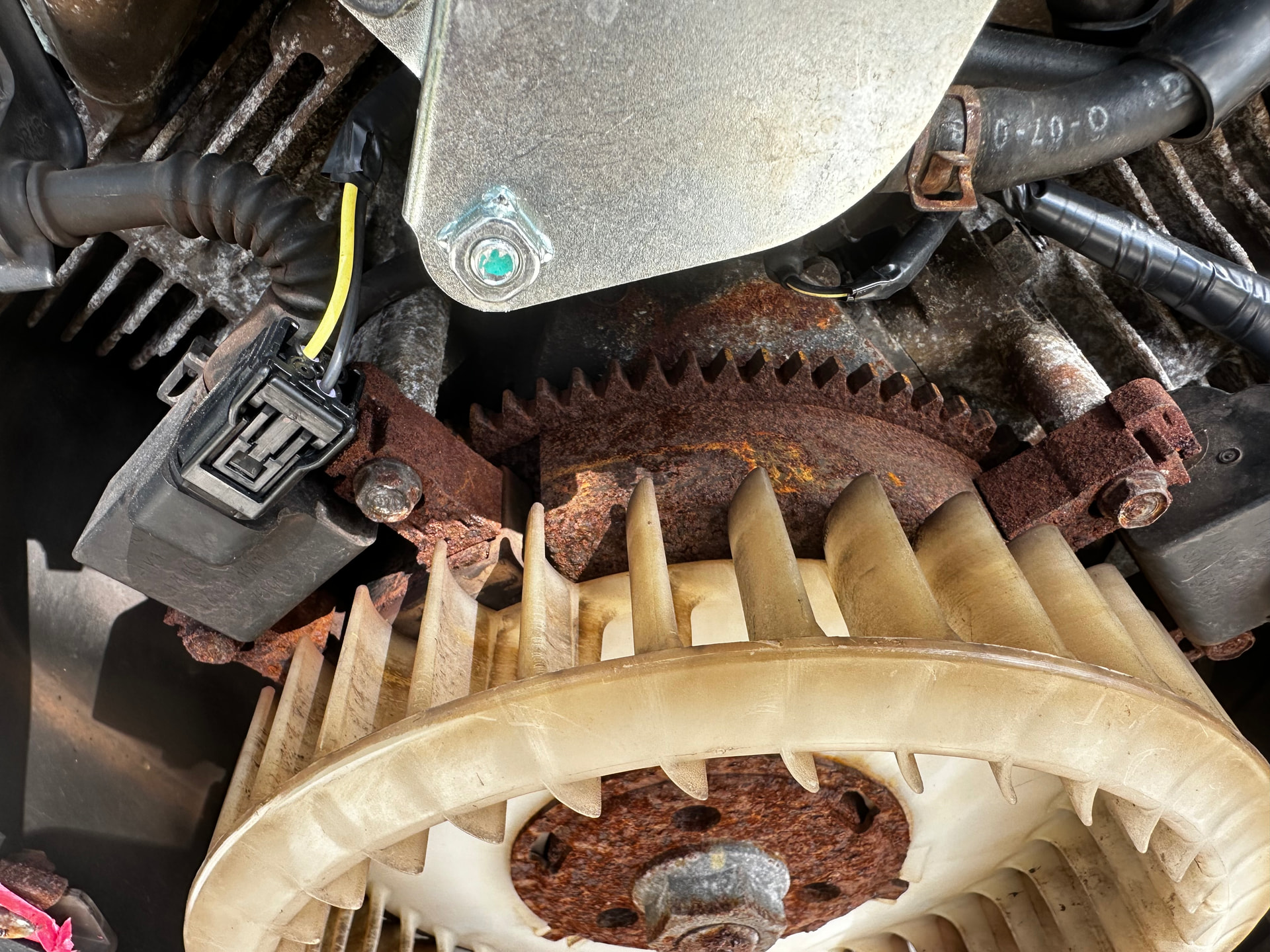

If the engine is still dying under load after you verify air isn’t getting in your fuel lines, pull off the fan shroud and see how the coils look, if they are delaminating and splitting at the edges that could be why it’s shutting off.

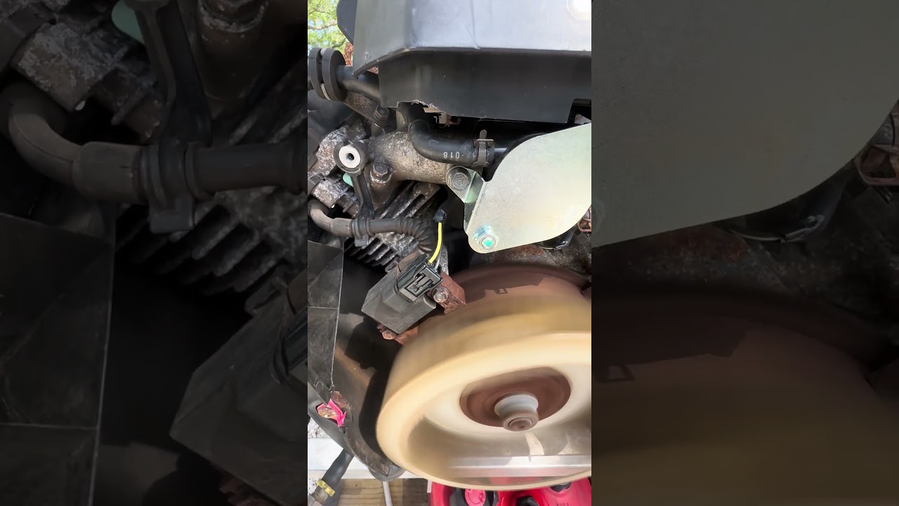

Hey guys. Trying to upload a video. I appreciate everyone’s input. Got it running, but still dies with trigger pull. Tried adjusting the unloader but it dies before I can.
New carb. New spark plugs: gapped to .030. Not sure what else. No bubbles in fuel filter now.
coils
had the same issue and it was a coil. The engine was running off one cylinder which was enough without a load but then when you put a load on it the engine would die.
Copy that! I’ll get the coils ordered. Thank you gentlemen for all the input and direction. I appreciate it!
