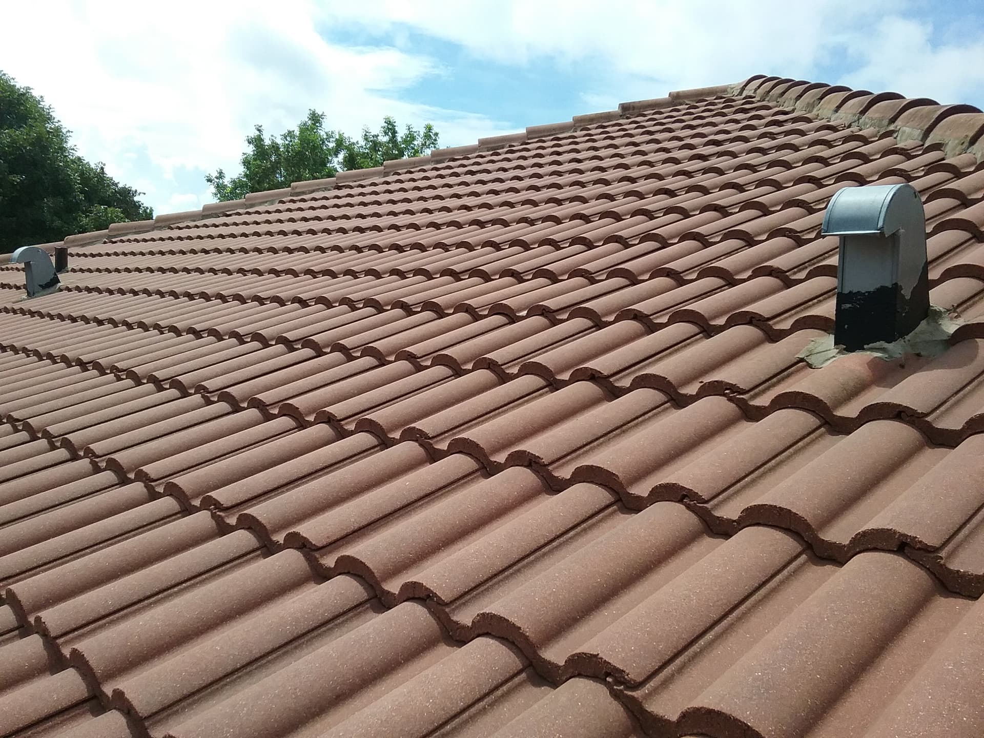

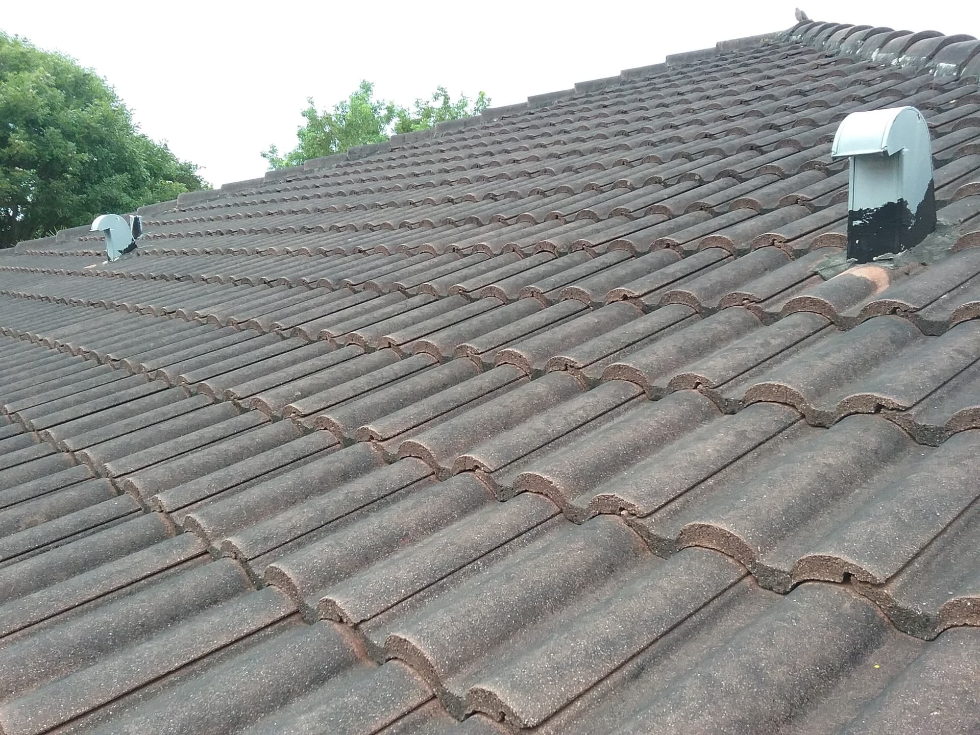

My final exam on roofs is going to be this week.
Barrell tile roof about 1500 sq. ft.
Going to 12V w/ 50/50 (6%)
I have two containers of Cling On ordered but may not be on time
The question is can I use Elemonator??? and still get the job done correctly???
I don’t know you enough to know if you can do the job correctly, but using one surfactant over another isn’t going to make a difference. Elemonator will be fine to use.
Elemonator will work fine, I’ve used on roofs, no issues…
I got it done. I am pleased w/the results.
