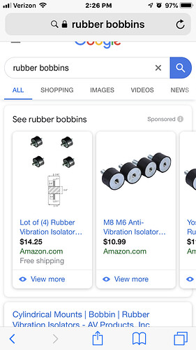

I can’t for the life of me think of what they are called, the rubber isolating bolts to mount the skid! Someone help! Lol!
Kind of. Lol. Looking for 2” stud on one end and 1” on opposite (length). 7/16” stud.

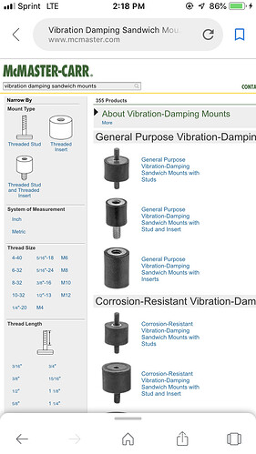

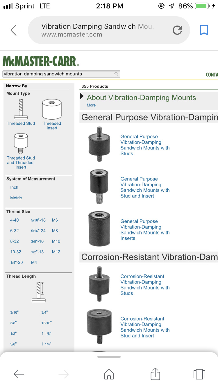

I genuinely thought that’s what you’re looking for. Check with McMaster-Carr. They have EVERYTHING. Lol
I don’t think I’ve seen the ones you’re talking about with two different studs though. If you figure it out I’d like to see it.
No that’s exactly what I’m looking for, I was just messin with you. I’m just looking for something that would reach through my trailer floor on one end and through the skid on the other. Looks like I could use the double female ones and use the correct length bolts to go through.
BOBBINS!! that was the name I was trying to think of.
Thanks @squidskc. And yes on McMaster Carr, I just never set up an account w them. I have one of their older catalogs in my shop somewhere. And yes, the have EVERYTHING!!
