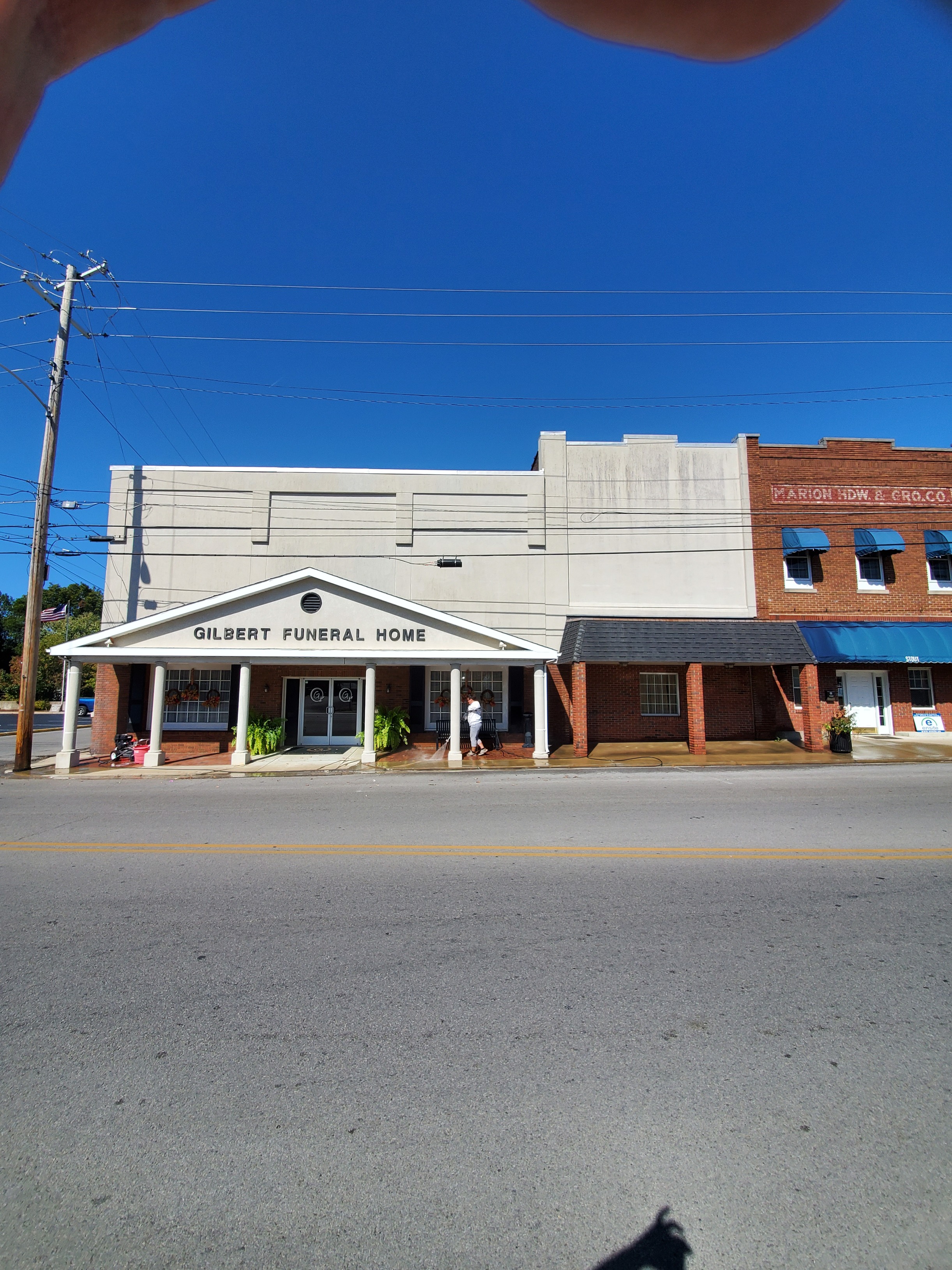

This dryvit didn’t clean up from Downstreaming…How do I add photos???
Downstreaming sometimes isn’t enough for dryvit. Literally tons of info already on this.

Search washing stucco. You’ll find a ton of info on how to clean dryvit.
Ya need a 12v set up to get a hotter chem mix dude. Or cheap X jet. But it’s a PITA

Hit it with about 3%-4%. Might take a couple times. If you’re in a hurry and you don’t have an xjet or 12v I’d see if there’s a roof access or use a ladder and just use a pump up. I

As stated, a quick search on here of how to wash stucco and dryvit will show you what you need to know to do the job right. There is one wacko on here somewhere that claims you can DS all stucco… don’t listen to him lol.
