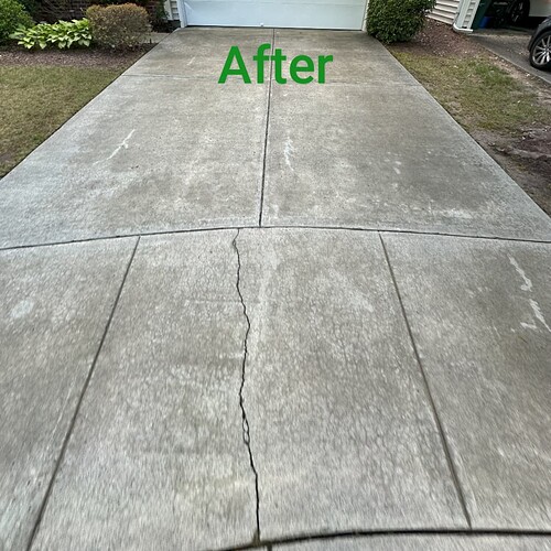

Hello, I’m Alexander and I’m excited to get started in this community!! I did a driveway pressure wash the other day and it was a very dirty driveway. I put a 1.5% SH mixture on the driveway. Let it sit for 10 minutes. Then pressure washed it with a wand and surface cleaner. My machine is 4000 PSI and 3.5 GPM which I understand isn’t very powerful but I went very slowly and I did multiple passes but the driveway just wouldn’t get cleaner then this. Any suggestions would be greatly appreciated :slight_smile:
Do you have any before shots? Did you let the SH dry during that 10 minutes? Is this photo from when it was still wet/damp? Looks like that concrete is just old and has wear and discoloration to it. Only thing I would add is that on really dirty driveways you may need to post-treat closer to 3%.

And also, I did let the SH dry while doing nothing to it for 10 mins and the after picture is from when it was still not fully dry. A little damp.
Cheapest way would be to use a pump up sprayer, but on large drives that sucks… x-jet or batch mix/proportioner would be the more costly but efficient ways to get a hotter mix.
Don’t let it dry unless you’re post treating. The hotter a mix you hit it the less dwell time it needs.
Based on the before it looks like that concrete is just weathered/aged… also since it was still wet it will look different once fully dry. Go back and take a look, and if need be clean it again.

Something’s not right here. That driveway doesn’t look touched at all. Either we are getting our leg pulled or that’s the worst case of magnesium I’ve ever seen…well, 6 years worth anyway.

doubt you can do anything to that drive except seal w/color acrylic sealer like eagle sealer
looks like it’s been torn up over years and probably sealed without cleaning
Get you a pump up and go back out there and spray a little section with straight SH, let dry and send us a pic.
