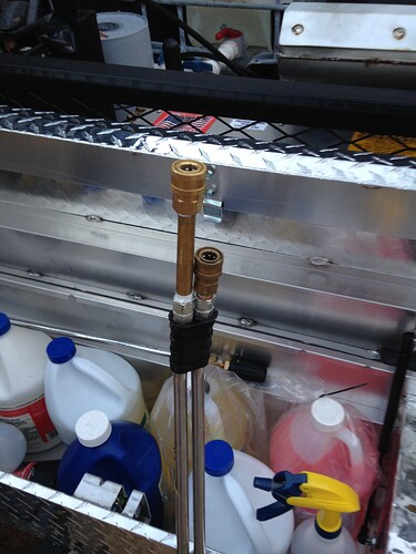

I would like to share my outcome with this issue and using 4 banger w/ soft wash tips for 8 gpm unit.
I took my duel lance and added 2ea. 1/4" couplers, one of course with extension. I am now able to use soft wash soap and rinse tips as needed without pulling chem hose from soap bucket back at trailer. The only hiccup I have is that the nozzles for height spray together when applying soap ( so extra usage has to be in mind). No big deal since it is more convenient to clean lower areas. So when you are 250ft to 350ft. from your unit and do not want to make the walk. It works very well!! Hope this helps…!
It makes my arms hurt looking at that
Gotta man up… Its Not a Jack Hammer at least.
My landa guy made one that is about 18 inches long but that’s still way to much weight and wand to drag around and into breezeways for me and my crews. Glad to see someone tinkering though and making something work for them
