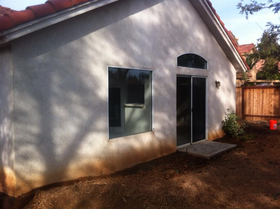

Here’s a couple pics of some bad mud stains on a surface more difficult than yours.
Sent from my iPhone using Tapatalk - now Fr
Stucco is tough it sucks in all the dirt. Only to true option is repainting but that looks pretty good. F9 barc?
Stucco is the worst! You’re right, it is absolutely porous and sucks in mud stains like a sponge.
This product is our newly released F9 Efflo, completely different than F9 BARC… Except for a little bit of water, that is.
We mainly use it for hard water stains, calcium carbonate and efflorescence.

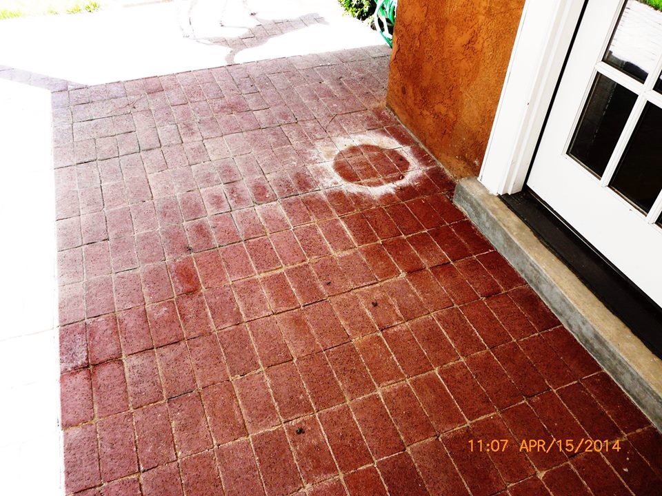

Hello Folks-
I live in Arizona and I am seeing staining like this everywhere outhere. There is A LOT of wind and dirt, so I am thinking it is minor red clay staining. What are your thoughts?
