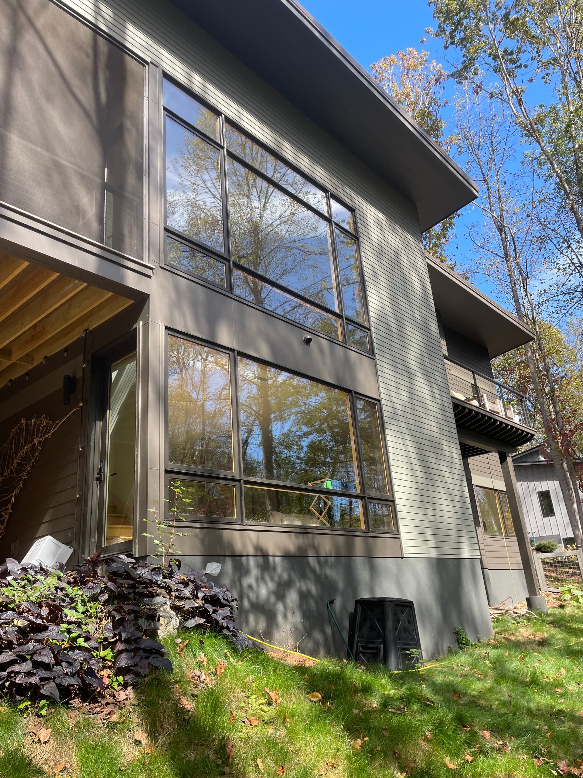

Here’s a typical house around here. We sure do love our glass around these parts :smiling_face_with_sunglasses:

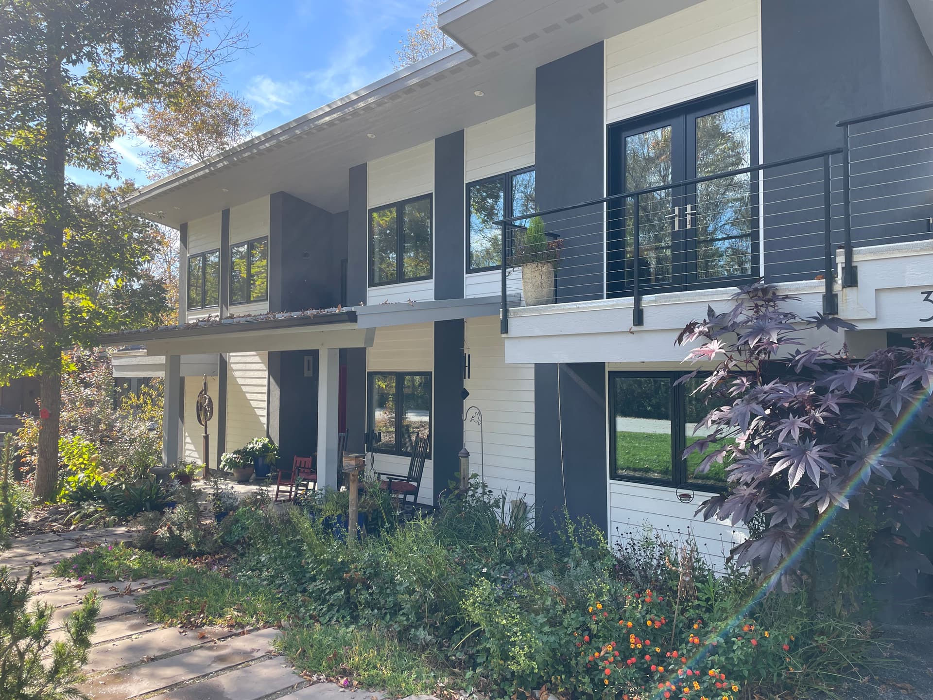

I don’t remove screens. I inform them about that beforehand. If they want to remove the screens then I welcome that but if they’re on when I get there then that window gets a DI water spray and that’s it and I move on. Its a moot point anyway because most of the homes I work on have huge picture windows. Today I was pretty dialed. I had 3 houses and each took sub 60 minutes.
Here’s an example. Screens aren’t really a thing on this kind of house.
