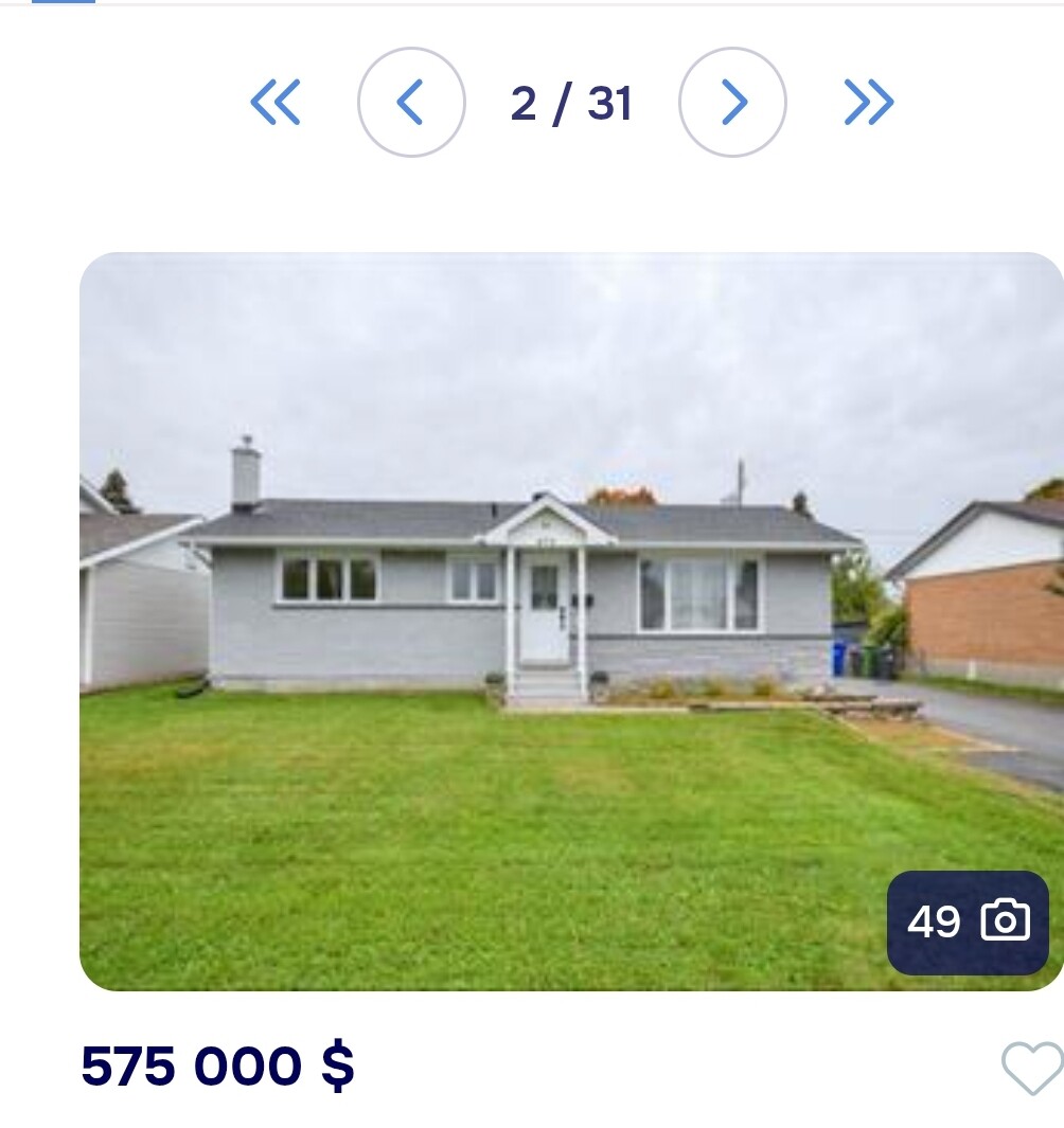

500k is high-end houses in your area? Man! There’s hardly anything at all under that price here…
That’s pretty sick. Louisville has a lot of decent houses for around 200k
