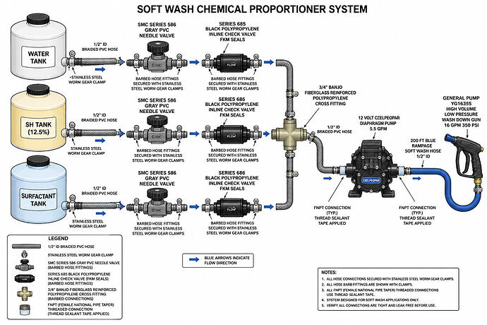

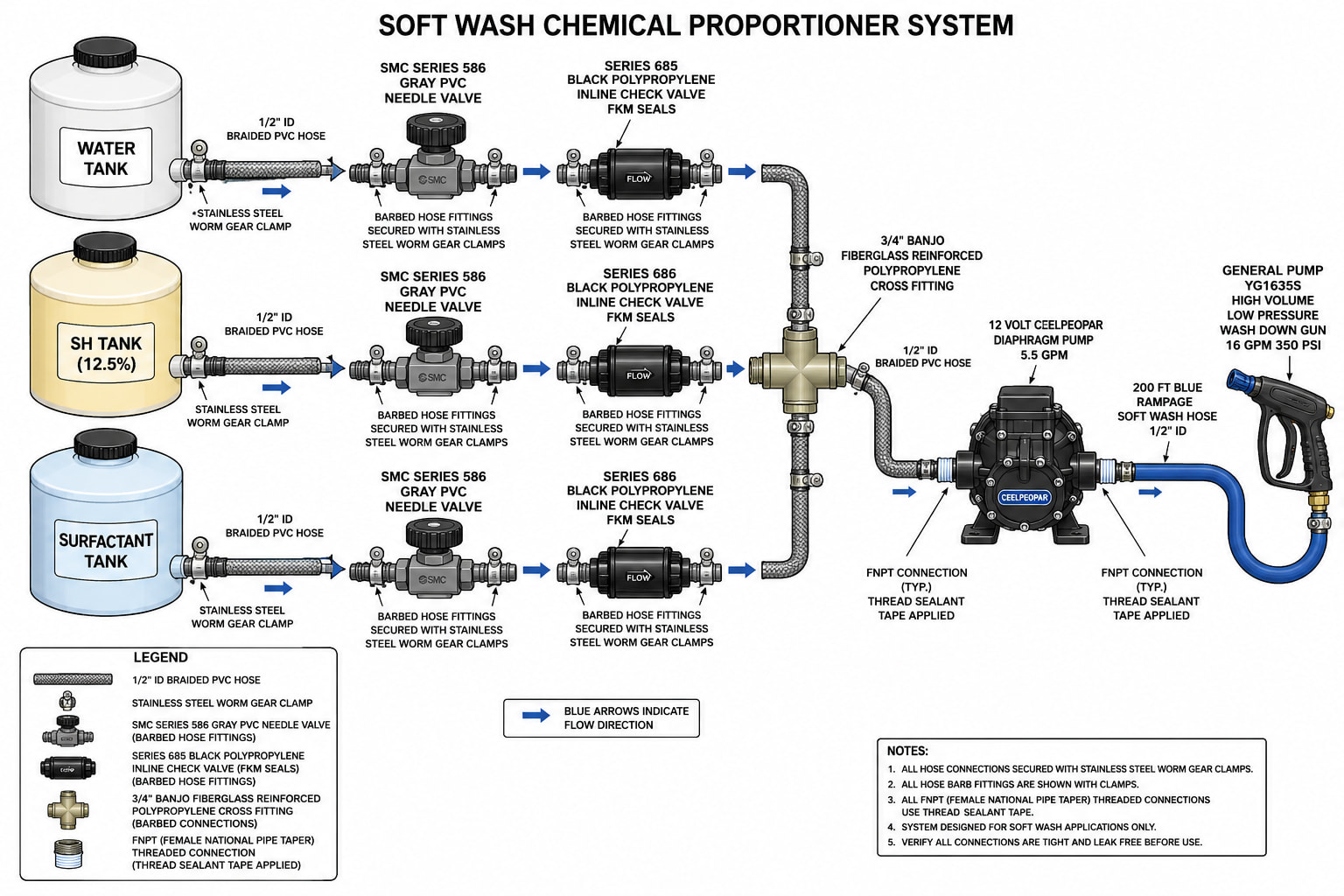

Hey everyone. I’m making my own soft wash system and have a bunch of stuff in my cart and I decided to get AI to make a diagram so I can see exactly how everything will fit together. let me know if it looks right. This is my first time doing this and funds aren’t something I want to make a mistake with. Thanks in advance!
And if anyone is curious I’m spending about $647-664 on everything from the tanks to the gun and j-rod before tax. This will be my entire soft wash system until I need to upgrade.
