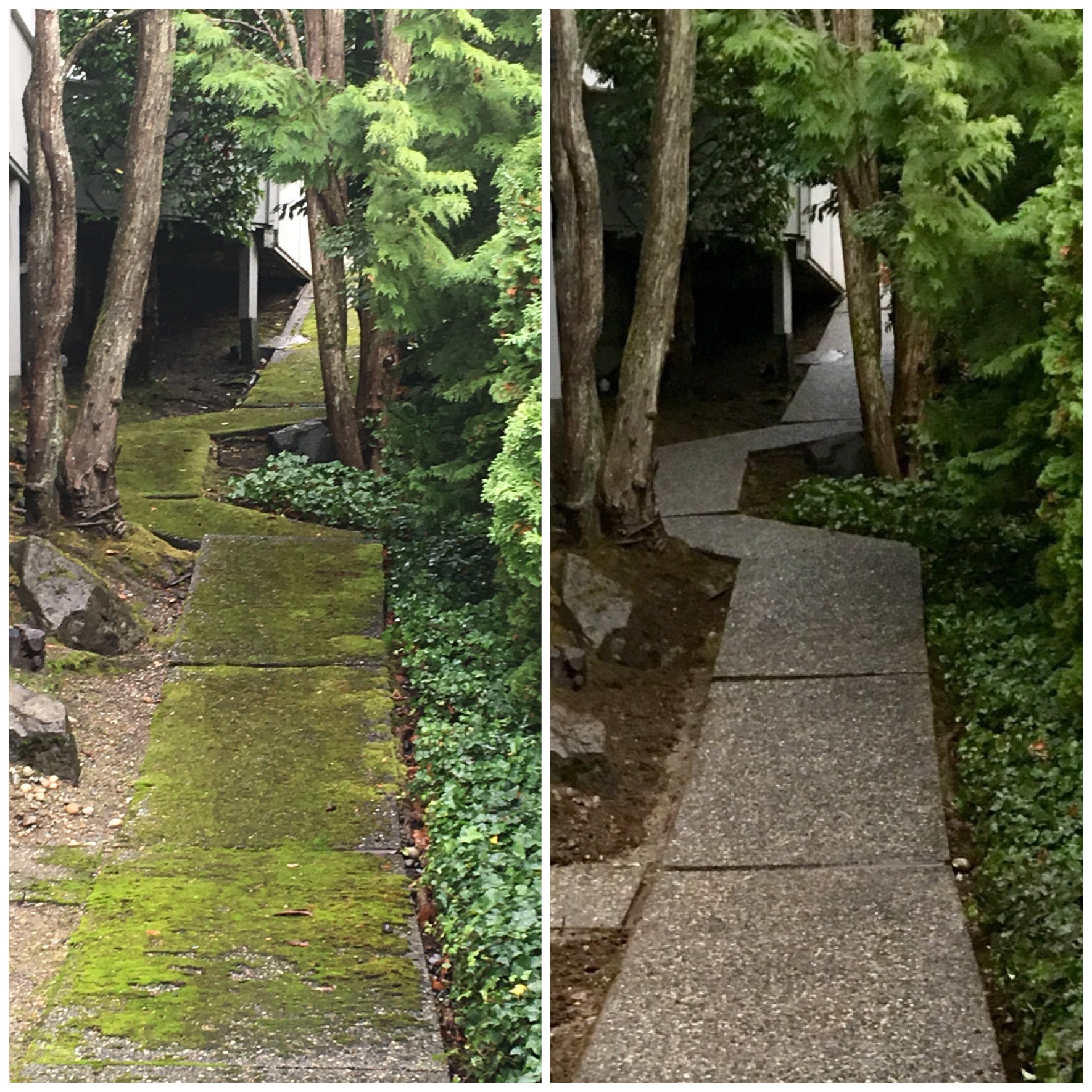

What happened to the trees in the second pic?
I have 5 grinders. Lol. Still life changing. Discs break, flap wheels lose their grit, and wire cups lose their needles.
I was wondering the same thing. But if you notice the window and the mismatched boards are the same.
Well spotted! The trees/shade were the cause of the mould, so they chopped them
