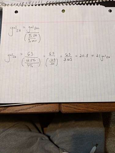

There’s a 128 ounces in a gallon, so a gallon of 12.5% SH would have 16 ounces of actual SH to a gallon. If I want a 5 gallon pail of 3%, I would need 19 (approx) ounces of SH to 621 oz of water. Thus I would put 1.2 gallons of 12.5% into 5 gallon pail and fill the rest with water.
Sorry didn’t realize you had already provided a scientific answer I thought you were still asking for one. I made this out which works and I think is much easier to grasp.
And the knowledge about specific gravity is great, but like IBS said, just add more bleach. We’re not doing an experiment where quantities have to be so exact that you need to account for that.
