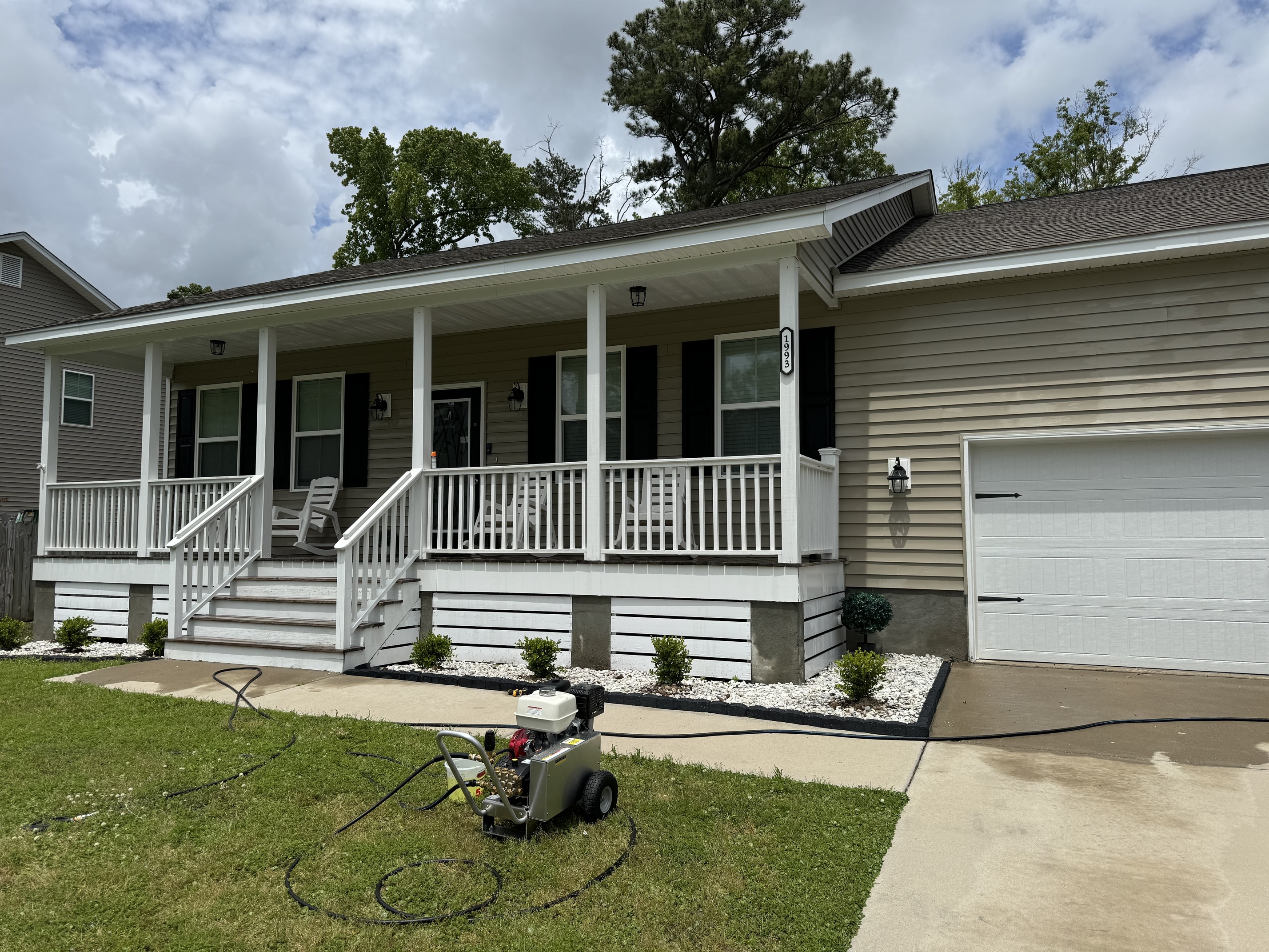

Did my first house wash!
It was my own house! lol
I decided to try this out after like 5 months of research.
Got a deal on a belt driven 4gpm/4000 psi GX390. It came with a 2.1 injector, wand, tips, hose. So I went and got some SH yesterday and washed my house today.
Did a bucket test and it filled up a 5 gallon bucket while sucking about a quarter gallon bleach. So I figured one gallon of SH to every 20 gallons of water meant I was diluted to about a 20:1 ratio. I know that’s super low, like about 0.6% SH, but I figured sure whatever I don’t really know what I’m doing anyway besides researching forums and YouTube so let’s just try it.
House came out pretty good. Definitely cleaner. I’m like 85% happy with the results.
The PW came with tips and the guy gave me some 25 degree tips for a 6.5 and 8 gpm that he used with a 4/4 and said it works to soap.
Even with the 8gpm tip I felt like I was just atomizing water lol and any of the other tips made it even mistier. So I kind of went back and forth between the 8gpm 25 tip and no tip at all. The only way to hit the peaks of my house were with no tip. Is this a problem with me, the gun setup, or the pressure washer setup? Should I swap pumps to like a 5.5/3000? I considered maybe an M5 twist would work better for reaching higher but guys I’m new so I don’t really know so I wanted to ask what y’all thought could help me control the spray and maybe reach higher? Thanks
