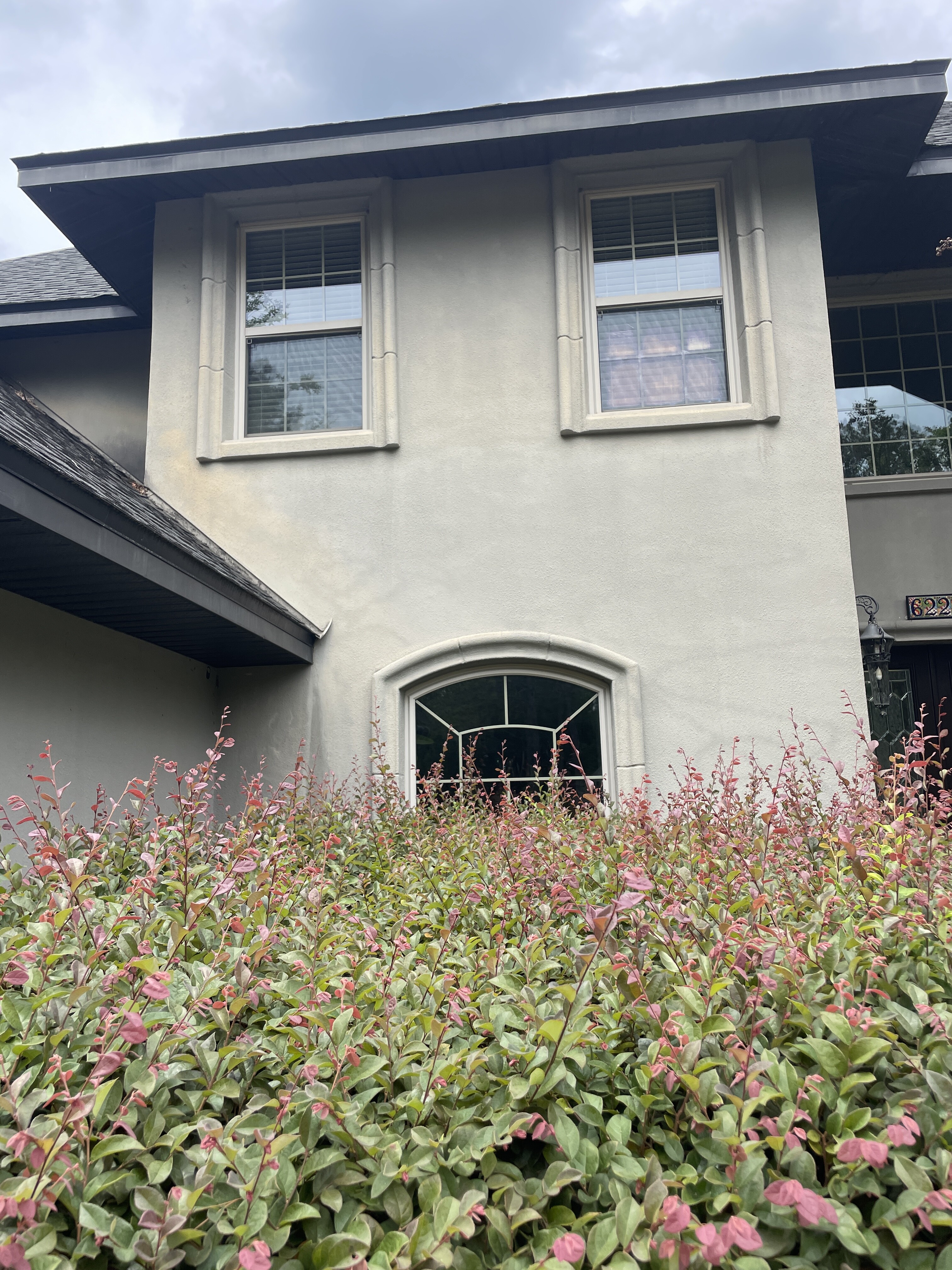

Recently had an employee softwash a stucco home using an xjet. Are these spots from improper rinsing? Is the only way to remedy this by having the house painted? Please help with any advice.
Sorry I’m not seeing the spots. Theres a spot where the water runs off the roof and down the siding that doesn’t look cleaned but that could be just the stucco wore down from the water. Oh I see a few squiggle lines now down lower on the house. Whas he using the 0 degree with the xjet? Maybe go back and try to fade out those lines or use some cleansol bc for oxidation removal
That employee was you, wasn’t it? I find it hard to imagine someone who needs help fixing this runs a company with employees. First step to freedom is taking Ownership!. But either way, maybe cleansol on that whole facade would help, maybe.

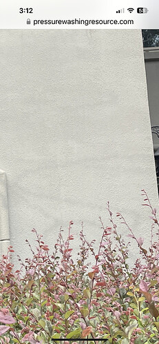

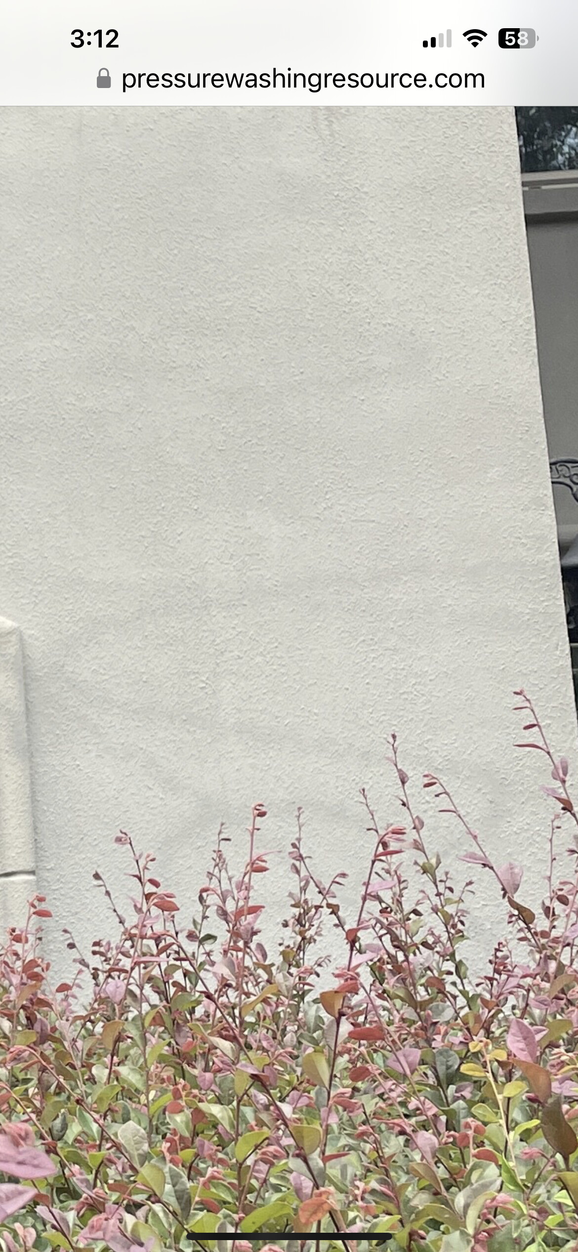

Is this what you’re referring to?
Got any before pics?
You or the homeowner ruined the paint. Time to break out a roller and brush and a ladder.
