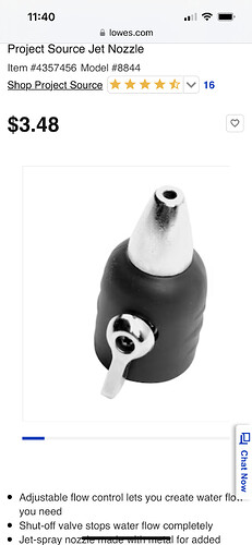

Don’t take this as snarky, but seriously after soaping you will get a whole lot more rinsing power just using their garden hose and a good distance nozzle. 2.5gpm is about what my kitchen sink puts out, a typical outdoor spigot belts out at least 5.
Just a thought until you get that snazzy 8gpm machine.
This is a pic, used it many times to blast off pine needles from glass enclosure patios.
Obviously don’t use it up close but for the higher stuff it’s nice.
Awesome thank you, will get.
