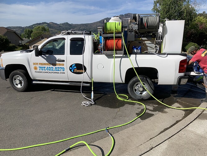

What I have done is installed a dedicated 18 inch reel that has 300 feet of flexzilla. I pull off the first 100 feet and connect it from the spigot to my splitter on the truck via a camlock. The water can go to my buffer tank, over to another splitter before the hose reel to switch between straight to the reel or over to My DI Tank via a three-way splitter. I can then send water either directly to the hose reel to use the 200’ flexzilla hose as an extra hose around the property for my tech to rinse plants or the Wall or whatever. Or I can send it to the di tank then to the hose reel. I use the same flexzilla to connect to my 50’ 1/4” wfp line. It seems to work fine as the 1/4” reduces flow when it drops down. This way I can leave everything mounted to the truck and with the couple turns on the splitters I can just pull my hose From the reel over to wherever I want with wfp and not have to cart around the filter.
Pic?.
This is now before my new unger ultra 1 stage comes in next week. I am going to permanently mount it in line and add the splitters. Then in the future when it’s time to detail the windows I just flip 2 splitters, unroll the reel and connect to my wfp!

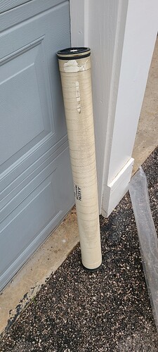

This ro membrane was 3.5 years of service… noticed we were burning through resin too much…
No parts replacement for around 3 years? No maintenance other than sediment and carbon filters? Is this right? Then the membrane is around 2000$ or so?
RO membrane was under $400 to replace…
