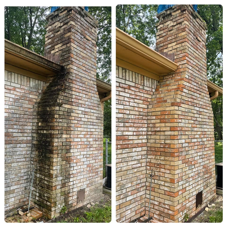

I find most of the time the black streaks on chimneys are organic and 3-4% takes care of it
Yep, may have have to hit several times, but same here
Ditto. Hit that sucker.
You’re lucky. All the ones I get like that are like 40 feet tall, so I’m standing directly underneath trying to hit top with a roof mix and 1/2 of it coming back down on me, lol.
Yes, that definitely looks like organics on that chimney. But I’m talking about soot that accumulates at the TOP of the chimney from burning wood.
