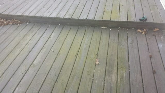

Here is my question though the deck on Tuesday (also a friend) in stained, but they do not want to restain it. It has mold on it and normally I would use house wash and a low rinse tip, but is there a better way?
I assume I do not want to use F18 because I do not want to strip the stain. So what wold you guys suggest F10/F8 or Sh/F8, or just Sh?

Here is a picture
House wash mix strong enough to remove that mold has the chance of removing a little stain as well. It won’t be like you stripped it, but it may need some touching up.
The key to maintaining a stained deck is to have it washed before it’s green. A milder mix for maintenance cleaning will be less likely to remove stain.

Just an update on these. The deck in the picture I just applied a HW mix to and let it set about 10 minutes. Low pressure rinse and it turned out very nice. It lighted up a shade or two, but I believe that was mostly all of the dirt being removed. Buddy was very happy.
