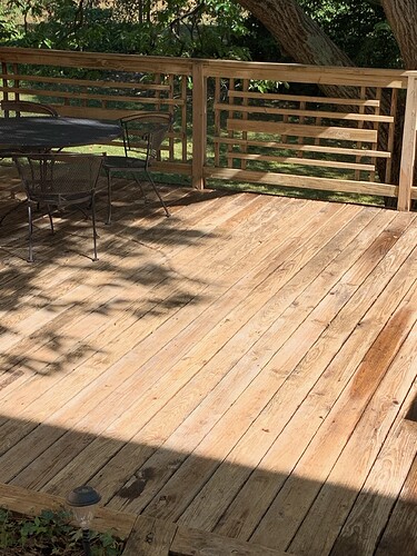

Haven’t been on here the past couple of days. It’s good to see you’ve gotten the right answers to your questions. Keep in mind SH does not strip stain that is in good condition, what it does do is break down UV damaged wood fibers and help kill organic growth in the wood. On older decks or fences that is what most of the color is so it appears to stripping the old stain when in fact it is bleaching out whatever does not have intact stain on it. Too hot a mix and too much dwell combine to create that white fuzz you are seeing. Though it could be it is probably not uniform since the stain was intact in varying degrees, wherever the stain is intact the SH wouldn’t do much. You are probably going to have to sand and restain that deck because unless you are going with a solid water based product the fuzz will show through. Sodium percarbonate with a scrub brush followed by an Ox rinse would probably have been a better way to go on that deck. I think I wrote in a previous note on here somewhere that I adjust the way I clean based on what the desired end result is i.e. solid stain, oil based penetrating etc.

Ok so here it is dry. It is pretty white. Should I do an oxalic or citric acid treatment on it next? Would that help bring back the original wood color? I offered to stain it for him to make it right, but I want to start with an original wood color before doing so.
You can try using Oxalic or citrus on it to see if you get some of the natural color back. It does look like there is still some of the old product on the decking along the edges so that will be an issue depending on what stain you are going to use since that old product will probably show through anything but a solid stain like SW Super Deck. If you are going to use a solid it doesn’t matter what the boards look like when you start as long as the surface is stable.
Finally got some pictures of it dry! The customer texted me the receipt for the stain he bought. It was called cutek extreme oil stain. Here is a link to the webpage: http://www.cutekextreme.com/
When he sent me a pic of the receipt the date was cutoff, leading me to think maybe it was older than 4-6 months like he said. Wouldn’t it be hard to strip this stuff off with a 2% mix that kept getting diluted over the 1 to 1.5 hours it dwelled?
