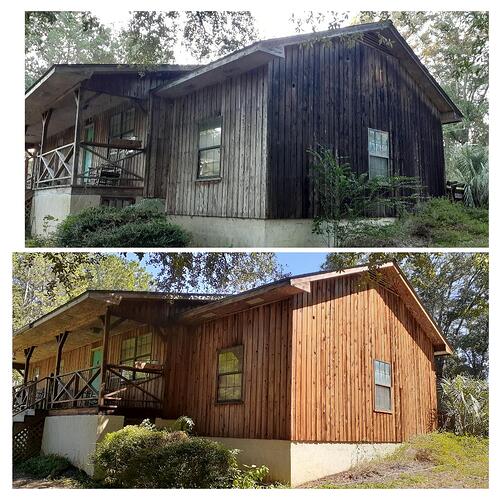

I Didn’t do a deck but I did a wood house using the same procedure in post one almost… i Only used 8% Oxalic no bleach … can I post pics or is this for decks only… I don’t want to dilute this thread if I can help it . lol
Sure, post it. It’s mainly decks, but most things wood related.
Learned from You Racer… customers where THRILLED! It was my First Wooden house I was Nervous as a Turtle on a Freeway lolol. But turned out Great… They Stained the house them selves about a month later… This was Year before last. This was the same day… She never sent me the stained pics like she said she was… I use this pic on my Web Page.
I believe I could have done a lil more on that roof line. But like i say it was my FIRST wooden house using this procedure.
@Racer rick I think that looks pretty good sir. I think wood cleaning and wood restoration are two different things. I’ve got about 200’ of fence coming up to do for a friend and I’m torn between doing it right or just getting it done. You in Charleston next week? Lol
Looks good. Going to steal ‘turtle on a freeway’, LOL

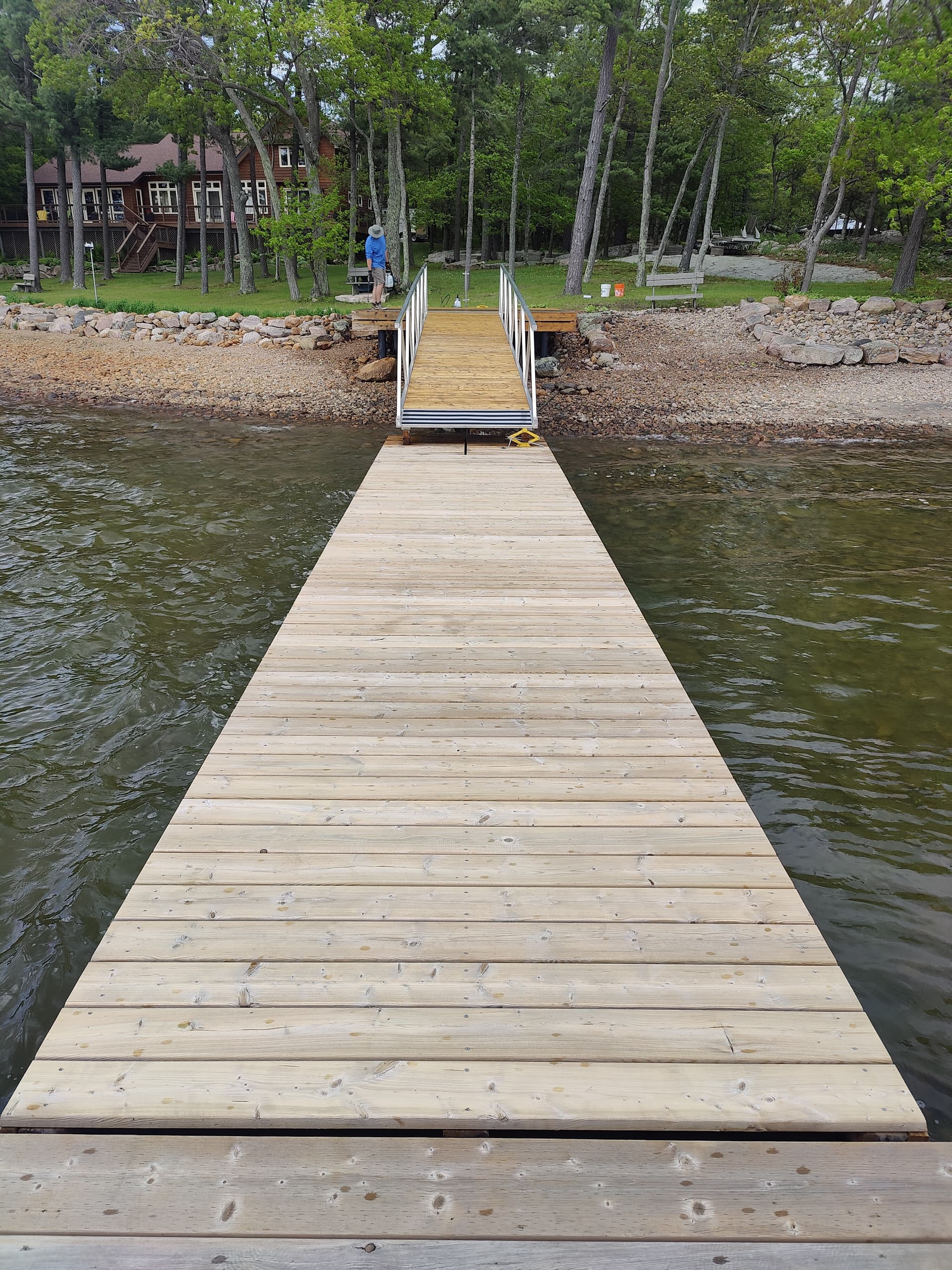

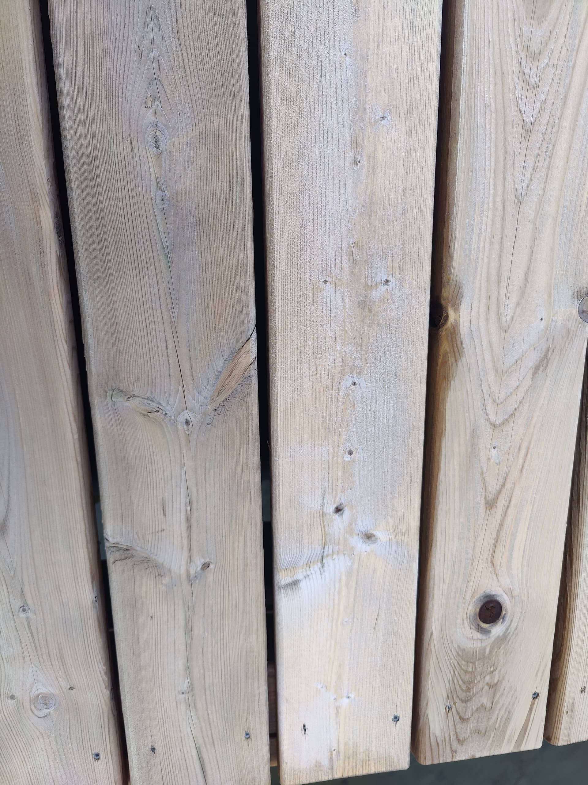

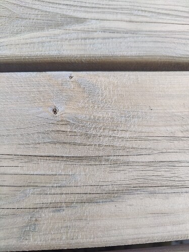

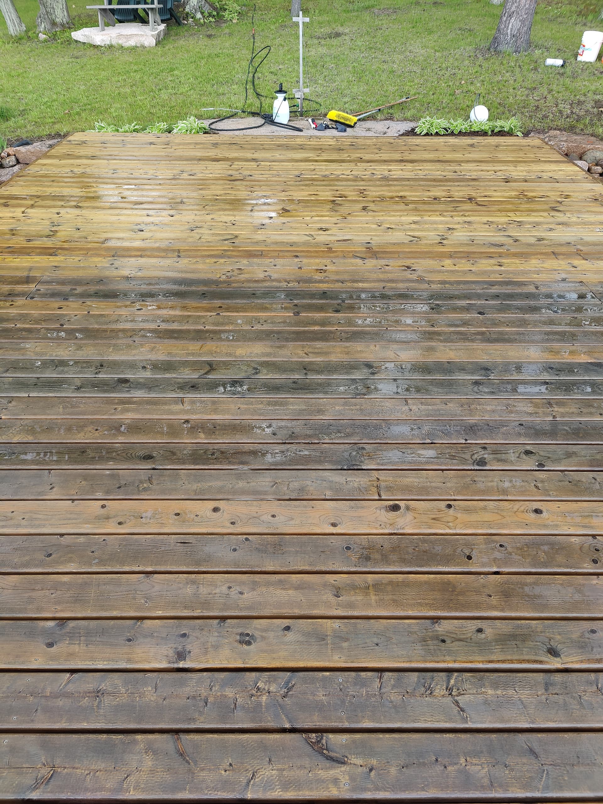

I have a few wood restoration projects coming up…I’ve cleaned and sealed a few successfully last season. I wanted some advice on why the wood is furring up. Not sure if it’s too much pressure, or not enough to wash away the dead fibers. Any advice would be appreciated?
Method.
SP @ 1 cup / gallon.
Dwell 10 mins.
Brush with deck brush
Rinse with M5 on my 8gpm machine.
Hit again with SP for 10 mins, scrub again since deck was still dirty.
Rinse again.
Citric acid for 10 mins at 1cup / gallon.
During, after and close up photo attached.
Seems like the nuts of the wood also stay white / grey after drying.
Thank you!
To be honest, a little bit of furring is almost impossible avoid. My humble opinion only.
What type of wood is the white looking. The only time I’ve seen furring like that is when I left about a 3%mix on some cedar way too long
It’s pressure treated pine.
It wasn’t in the worst shape by any means, just a bit dirty and grey.
