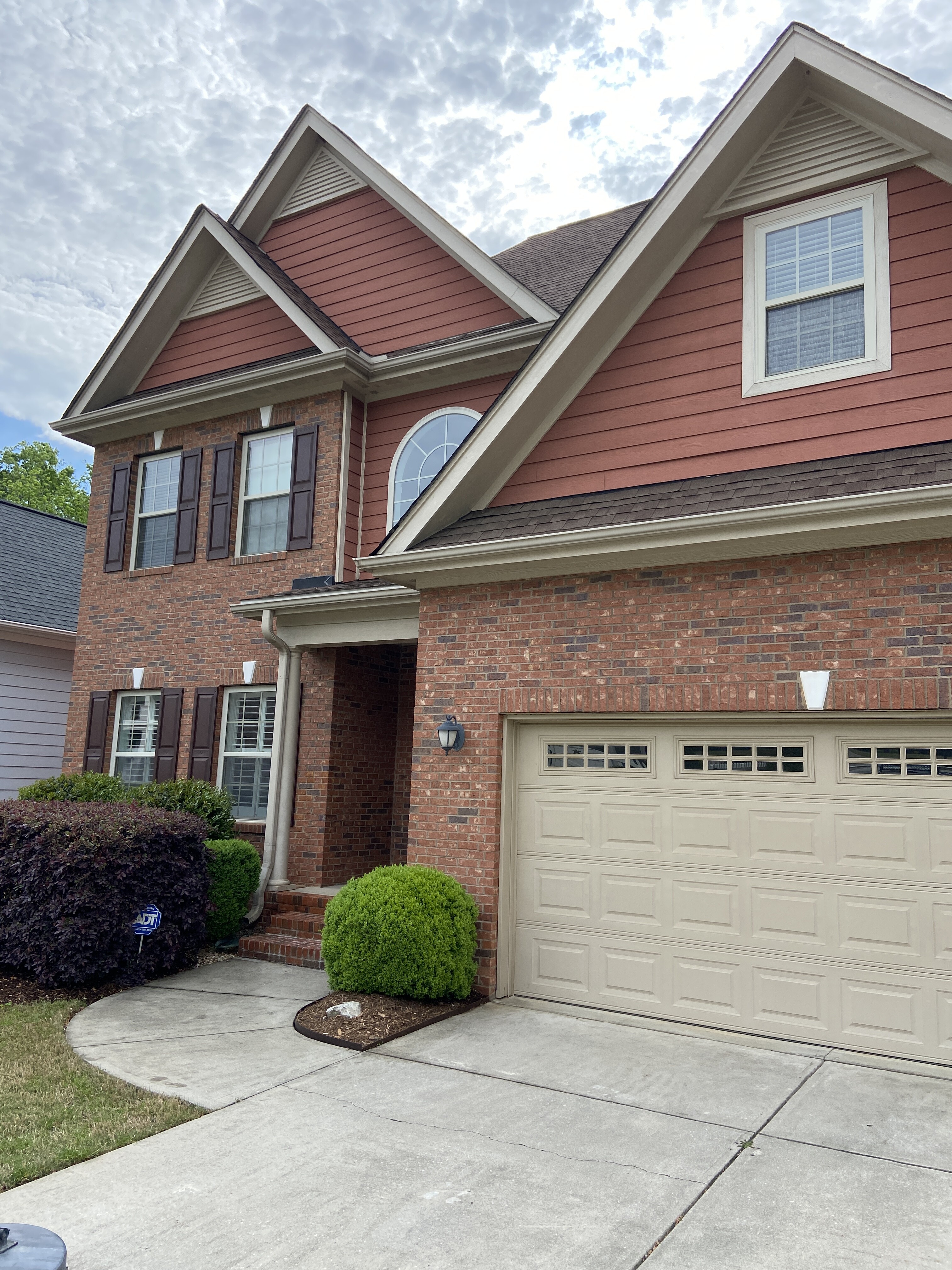

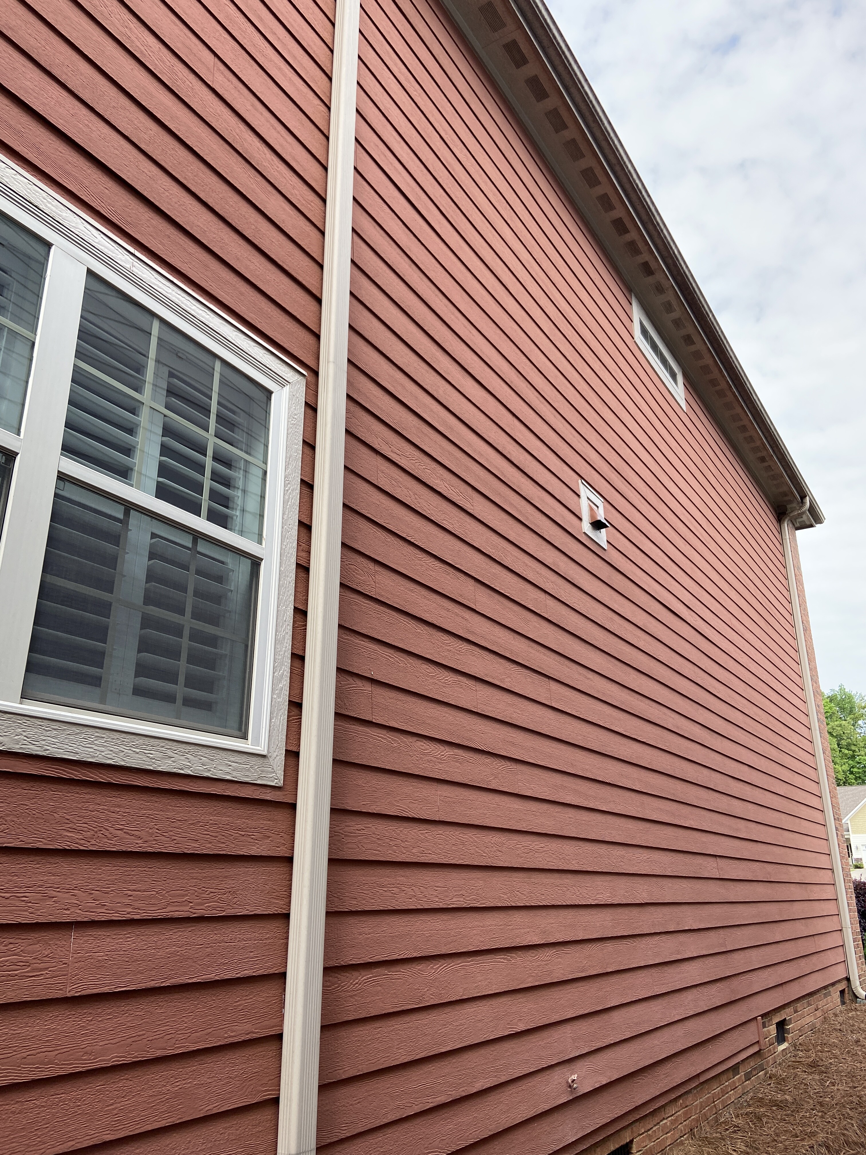

I do a fair amount of Hardie board with no problems, but I was nervous about this dark red one I did today. Went behind hvac unit and hit a spot with some straight SH and let dwell for about 15min. No problems, but still went with about a .5% mix since gutters and trim only things really dirty. Cleaned up fine with no problems what-so-ever.
LOL, neighbor came over to get card after walking out to get in car and seeing this.
Nice! You’re braver than I am lol.
That’s almost the exact shade of red as the one I did that faded and came back. It was older and oxidized though.
This one is about 10 years old, had just a little oxi but not bad. Houses close together, so doesn’t get a lot of sun except in the rear and more faded there. Took a boatload of before pics to CMA.
I do just what you did. I usually have to hit gutters and soffits twice because of lower SH. No issues though….
Since I’ve never seen Hardie board get nearly as bad as vinyl, I go even lighter, .3-.4%. I lightly mist it first, then hit it and rinse right away and rinse excessively. On average I probably spend an extra 15-20 minutes on those color houses just rinsing. I’ve done dark blues, olive greens, reds, you name it. Been doing this for going on 5 years and have yet to have an issue with any house. Maybe what I do is a bit overkill, but I rather spend an extra 20 minutes and know I won’t have an issue.
