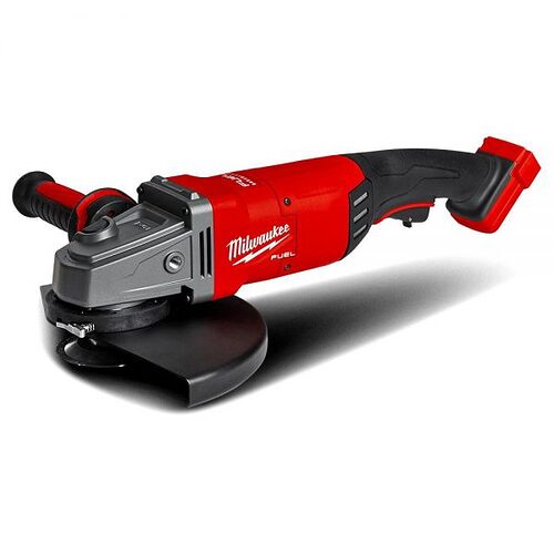

Any reason why you guys are using that style grinder/cutter?
I have polishers and sanders that look like that but usually go old school style for cutting and grinding.
Both tools are great. I could use either or. I like how small the 1/4 grinder is. Don’t need a beast to cut these washer hoses. They are soft so the m12 here works great.
I use both types depending on what I’m grinding or cutting. Sometimes a larger grinder won’t fit into a tight area to cut or grind.
