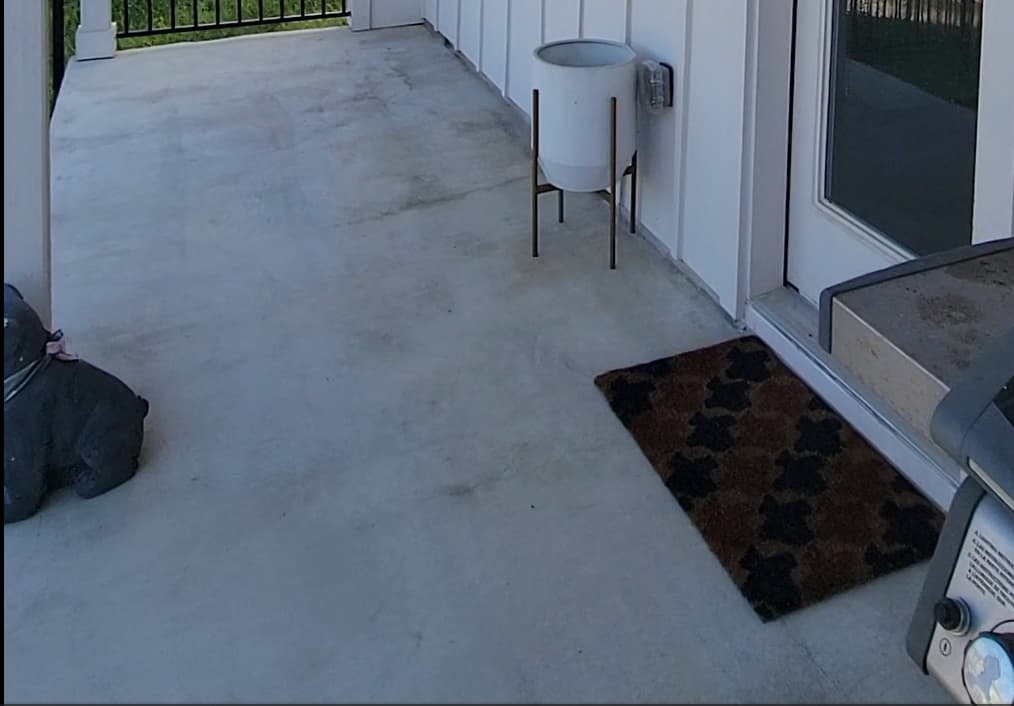

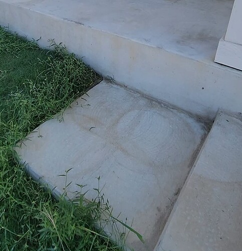

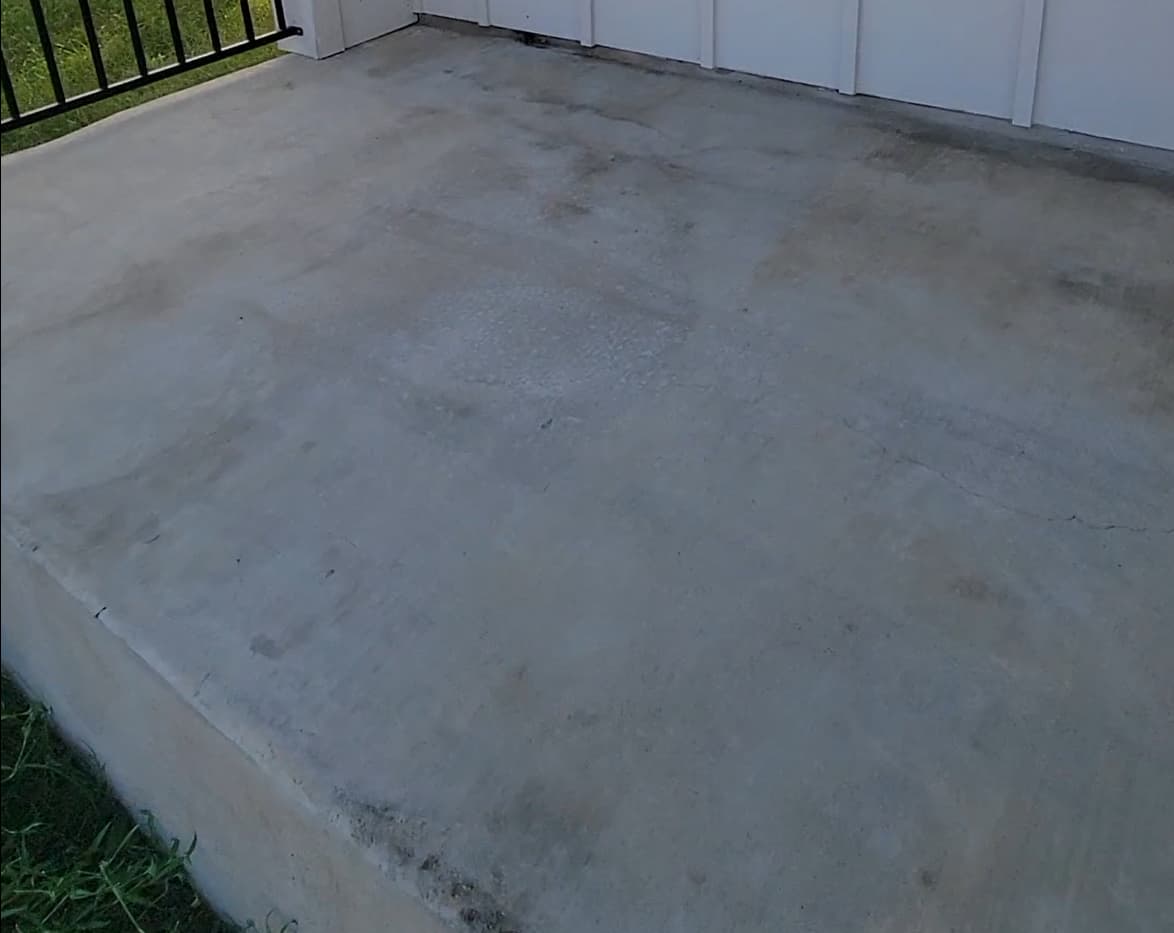

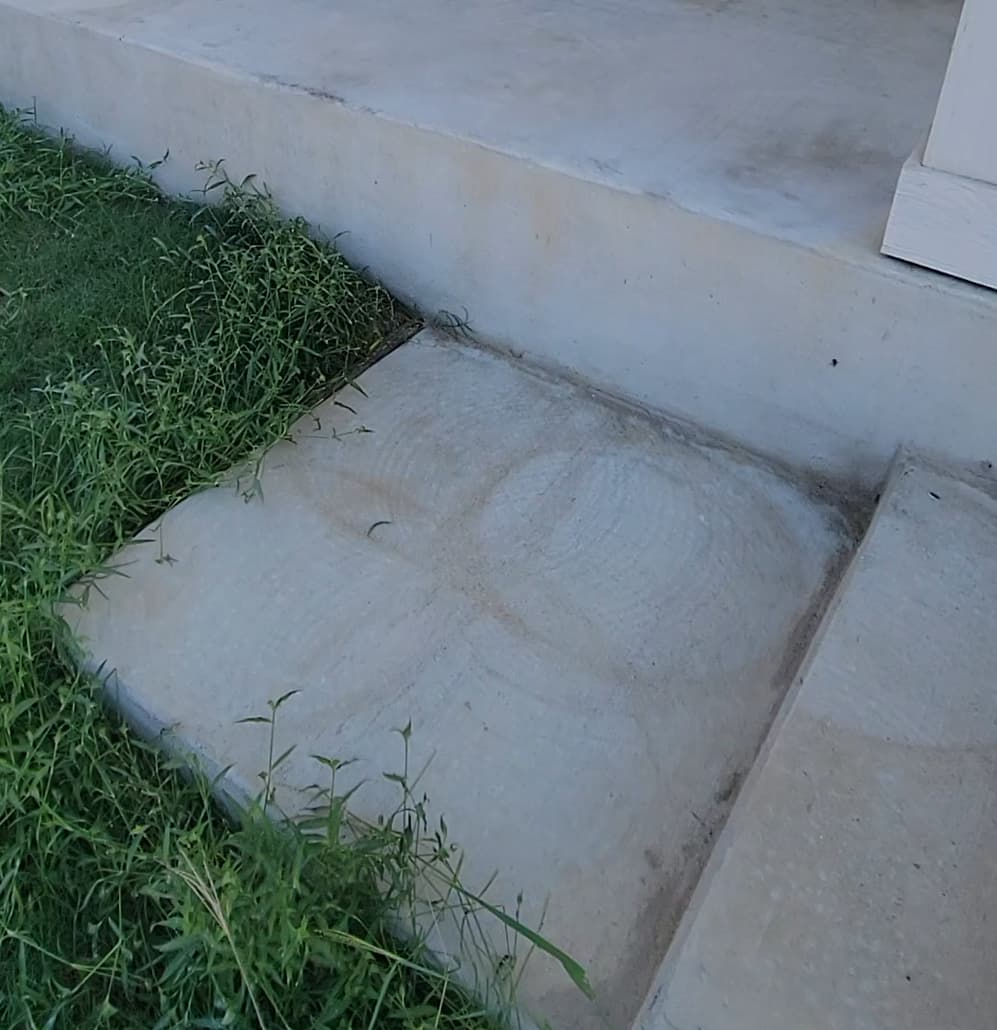

I think I might’ve removed the cream from my buddy’s concrete patio. He bought the house new 4 years ago, so I was confident it would be fine.
Can yall confirm what I’m seeing from the surface cleaner swirls and small tan areas? Would I still be considered liable given the age of the concrete patio? Or is it the builder’s fault?

2500psi with 0 deg tips??? Look at that pic of the step, that’s pretty badly etched. What equipment do you have and what tips in your surface cleaner?

Before filing a claim, I’d recommend going back out and giving it another pass. In the first photo, along the wall and about a foot out, it doesn’t even look rinsed… more like dirty water was left to dry. The steps also looks rushed, you can see on the top step the surface cleaner did its job, but only on 1/2 of it… just below there’s still a lot of tan and orange where it doesn’t look like the cleaner even passed.
Try pre treating the whole area, surface cleaning with circular motions instead of straight lines, and then post treating. Check it again the next day to see how it looks. If needed after that, you could use a turbo nozzle or chemicals to help blend any remaining discoloration.
