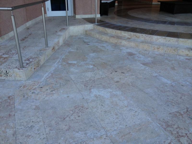

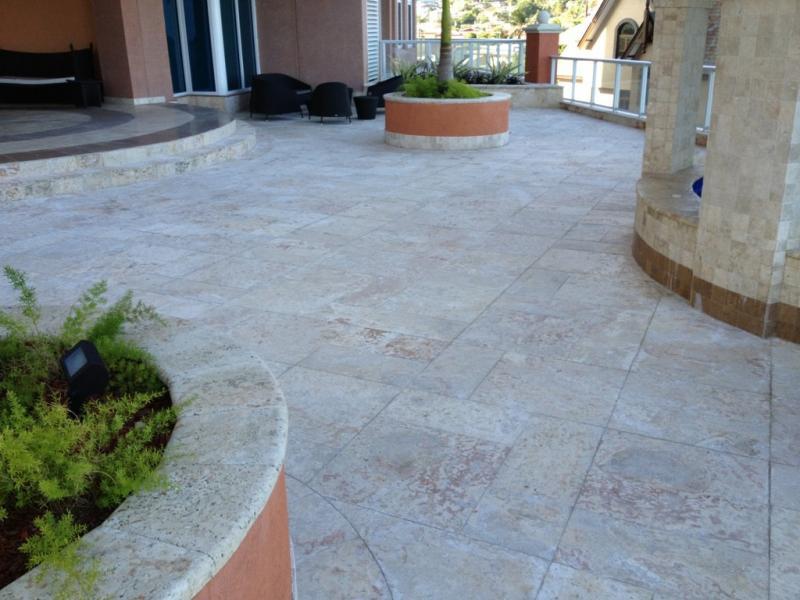

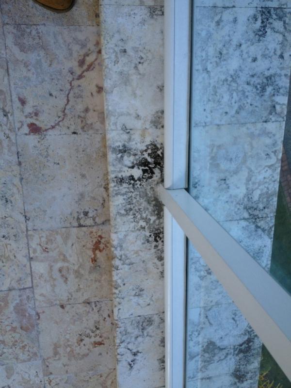

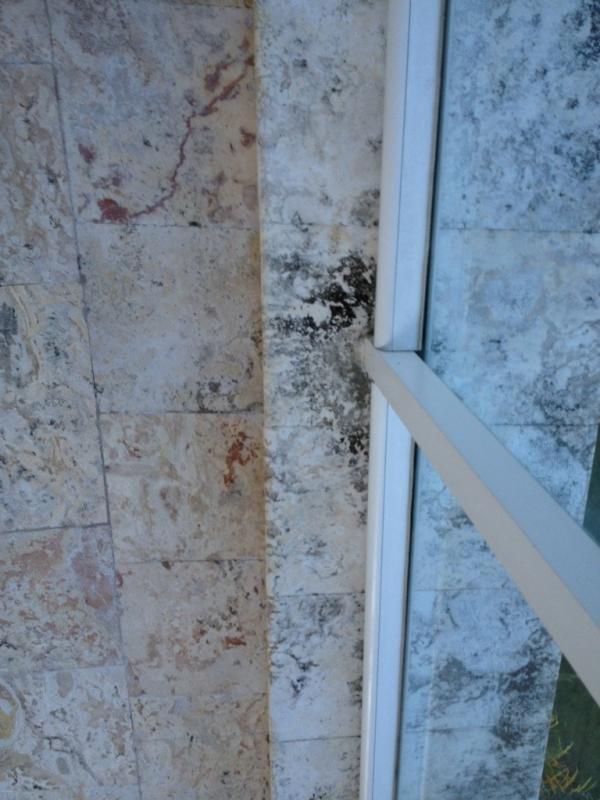

Few pictures from the visit. Did my research and called a supplier. Problem solved, tender submitted.

Job Description: Cleaning and Sealing of tiles at location.
Surface Composition and Properties:
Coral Stone: A natural organic stone which contains various marine fossils and minerals, along with other organisms that are often more than 65 million years old. This rock mainly consists of calcium carbonate and the fossil remains of marine creatures.
Types of Coral Stone
The Coral Stone comes in several colours, each of them with different densities and strength. The pink colour shade is due to the iron oxide with which it is mixed, the yellow are dense and highly resistant. The black tone, on the other hand, tends to be not very strong and is used above all in the cladding of pathways and gardens.
Main characteristics features that contribute to coral stones’ in its natural state are:
• Temperature resistant: Coral stones stay cool even when exposed to sunshine.
• Non-skid surface: Walkers, shoes and wheels do not skid on coral stone surfaces.
• Non slip material: Coral stones are inherently manufactured to be non-slip material.
Observations: Colonization of Gloeocapsa magma.
Gloeocapsa magma(MOLD):
This organism is slowly eating away at the calcium granules which can play a major role in causing decomposition.
Cleaning Recommendations; Steam Cleaning:
Due to the composition of this complex yet natural material we recommended that no acid or harsh chemicals to be used; however a mild alkaline can be incorporated into the cleaning. Natural surfaces require a natural cleaning; steam cleaning at quarterly intervals or when necessary as to kill and remove the residing micro-organisms within. With this process the surface keeps its true colour and superb properties.
Sealing; Not Recommended:
In keeping with the composition of this material and its present surroundings, there is no evident threat that renders jeopardizing its natural properties. It is a material that can be maintained, worked on and repaired to perfection, maintaining the beauty of the piece without synthetic alterations.
