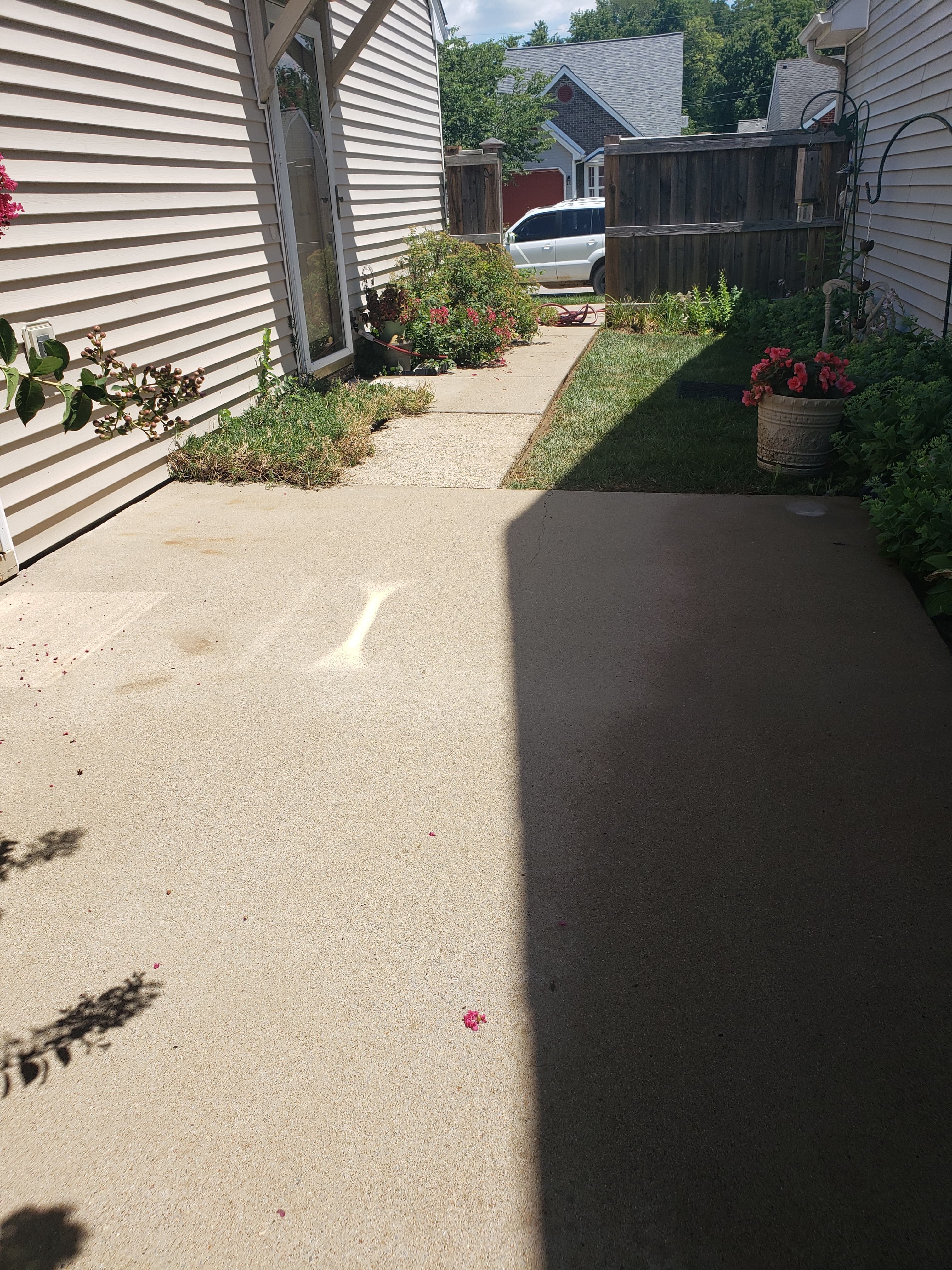

Here are the before pics. I used 3% SH mix. Then hit it with the surface cleaner.
Here are the after pics. I think it turned out well.
Looks good! Try the next one using just around a 1% mix and see what you think. For concrete, I’ve never needed more than that. I tried stronger mixes and all I really noticed was more suds since I use the same SH/surfactant mix, just different ratios when applying it. Didn’t seem to make washing any faster going stronger. Definitely not faster enough to justify using 2-3x more SH mix.
Will do! Thanks for the advice!
