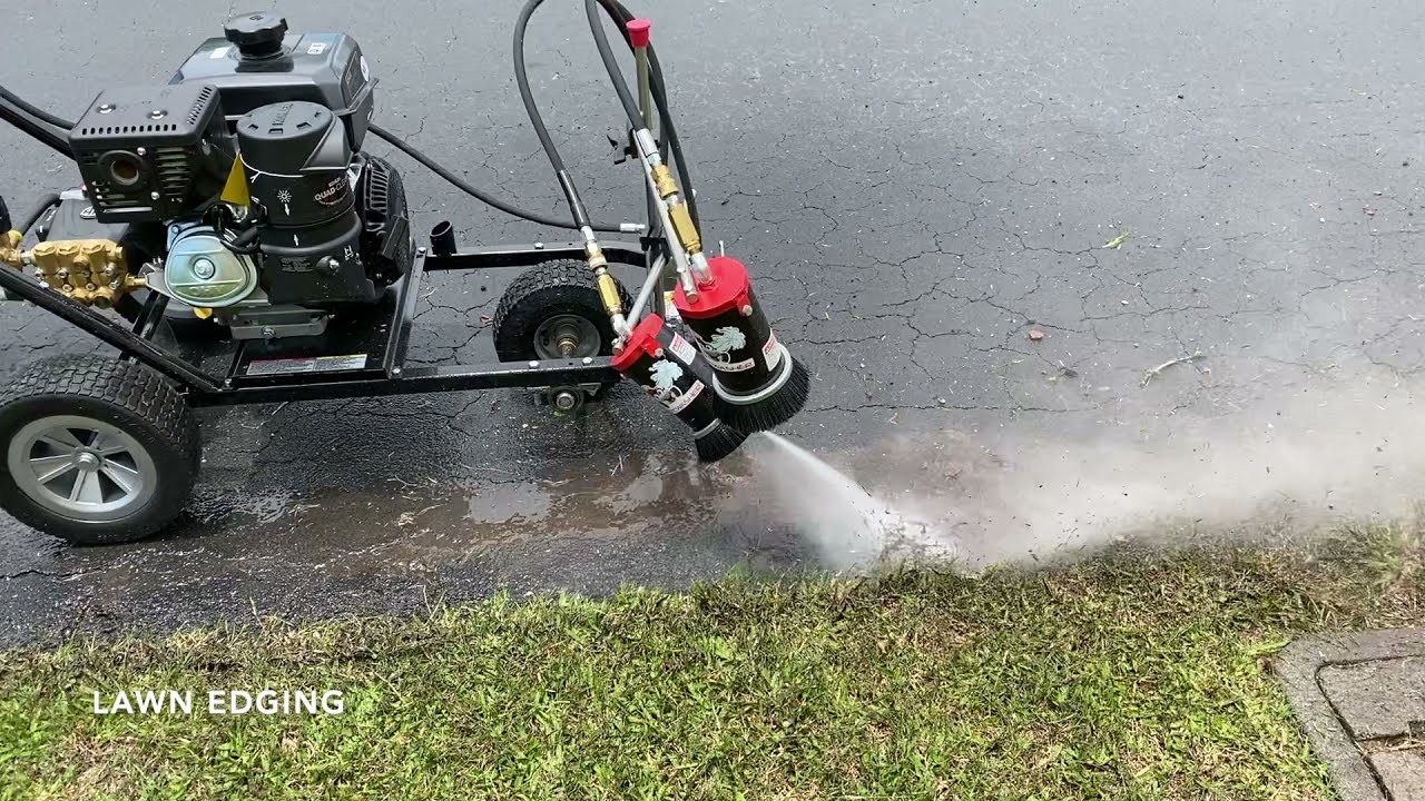

Twin turbo about the only thing i can think of that doesn’t involve a tig and some stainless. Suttner do them. Never used it, surely a bit quicker than a single.
I’ve got one. They suck
Yes this one! Shooting curbs with the Double Barrel - YouTube
This guy is so dialed in it’s not even funny.
That guy has not cleaned a lot of curbs, or if he has, hasn’t gotten very profecient with it.
What’s wrong with them?
1, they are super heavy
2, with the water flow cut in half it is faster to just use one
3, they are hard to hold steady as you have two different nozzles rotating at different speeds, think harmonic balance
So this was what had me thinking about it…
but I think you’re right, it would involve making your own possibly. Don’t do them enough for that.
