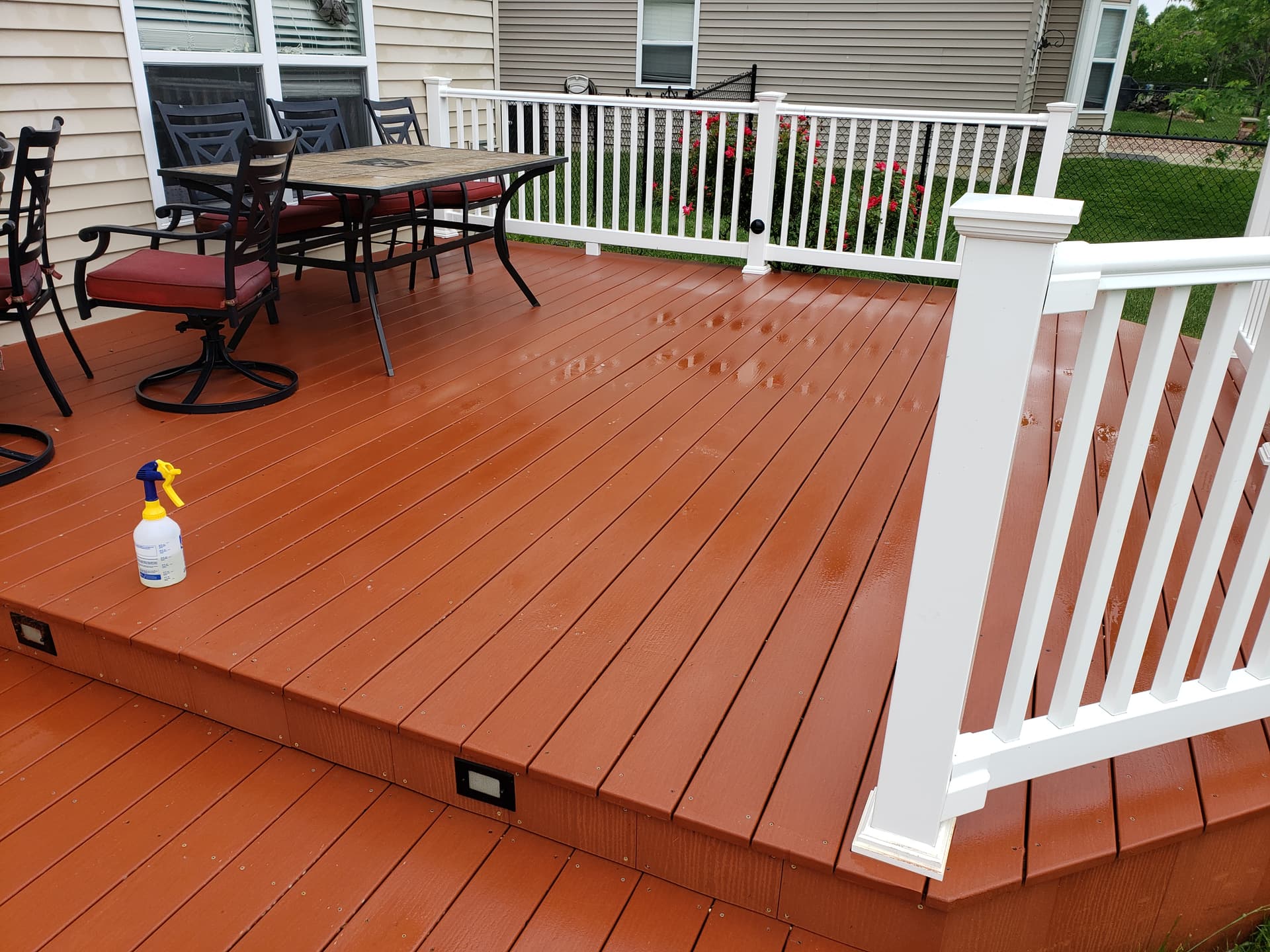

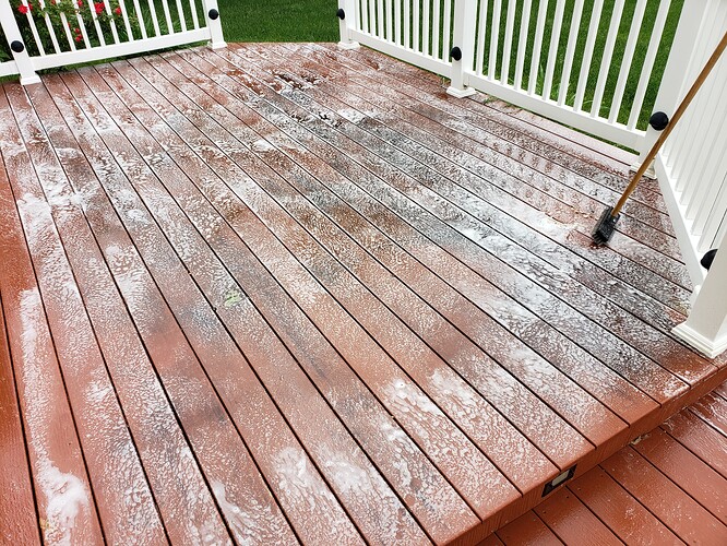

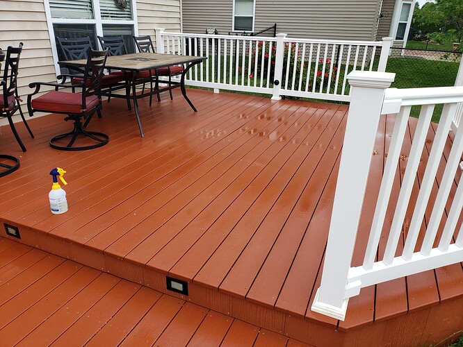

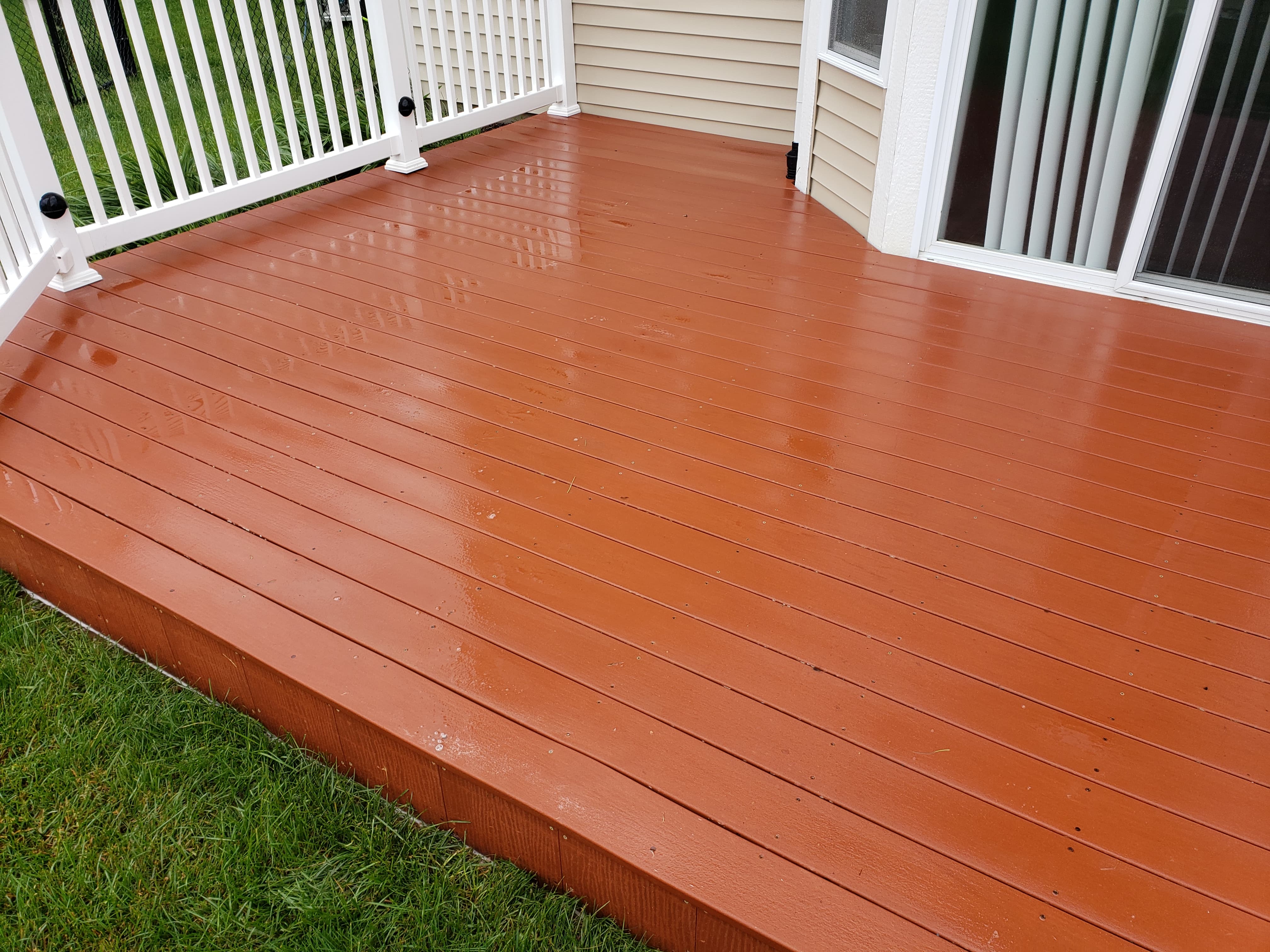

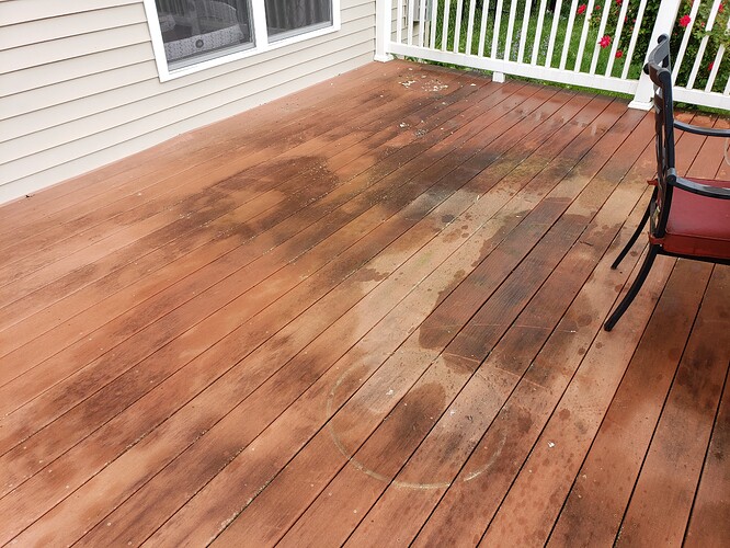

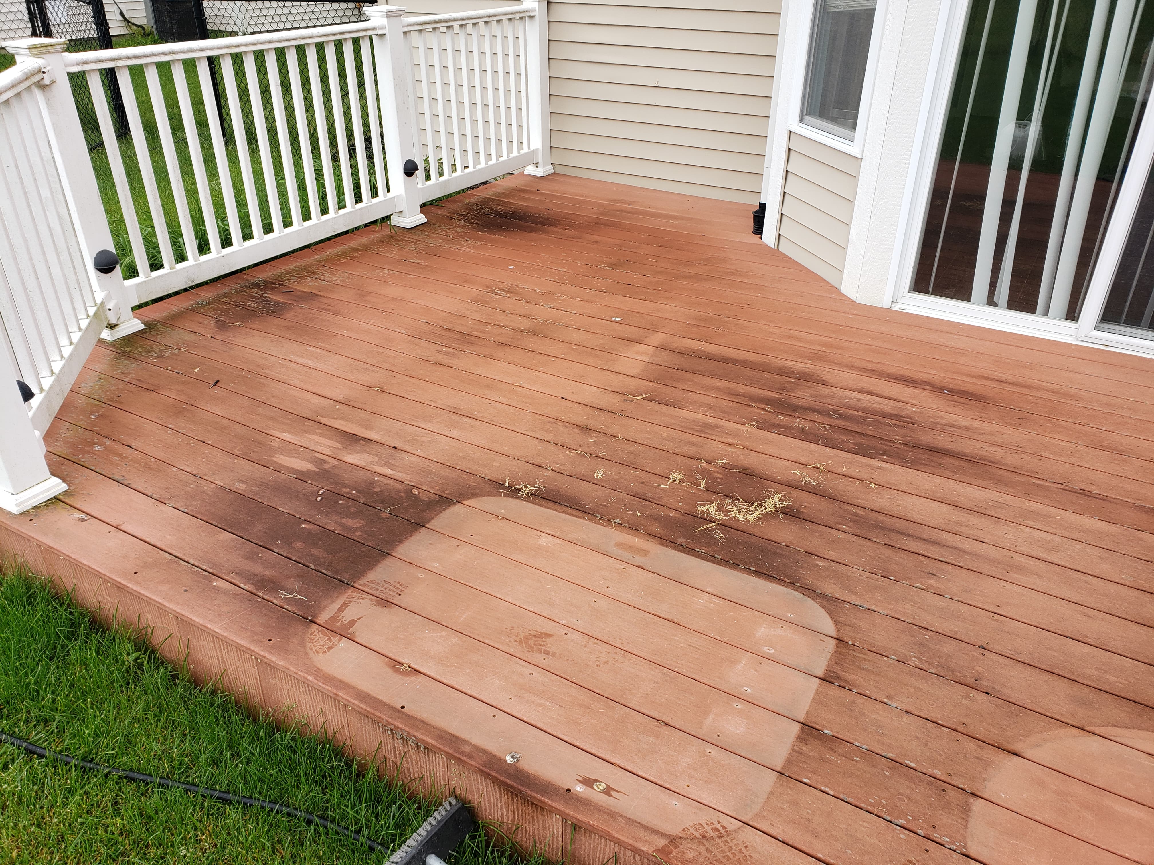

Just wanted to share my experience with a pretty nasty and stained deck I washed today. Process was pretty straight forward. 2% and some Elemonator, waited about 5 minutes, took a deck brush to thec worst spots, again, another 5-10 dwell then wanded at 2500 psi. I had a couple small spots that didn’t come clean, but a quick spray bottle with a 6% mix and they dissappear.

Do you have any pictures of the deck dry? They always look good wet.
By the way, I use a 16" SC on those and with my 4gpm it’s downtuned enough to work perfect. No hand scrubbing needed
Looks great.
I always recommend hitting the bad spots with a deck brush over pressure. It works great and only takes a few seconds.

No I don’t, but you’re right, the wetter the better!
It makes for better before and after pics this way. Also, its better to treat composite like wood, it can be somewhat soft, so too much risk in surface cleaning it. With a good pretreat it doesn’t take long with the wand. I started at 1200 psi, but the lichen was too bad so I swapped tips for 2500.
