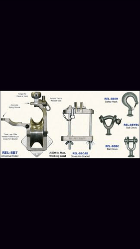

Get a leaf blower if u don’t have one will save alot of time and keep drains from clogging. We use x100 blocks to pull hoses up then secure it. No need for SC cleans up easy let the chemical do the work .

Not sure if I follow you on the blocks, what purpose are they serving for you?

These are the blocks I use they come in handy. Tie off the block drop down a tag line and pull the hose thru. Then tie off the hose. In Mills we use them alot.
