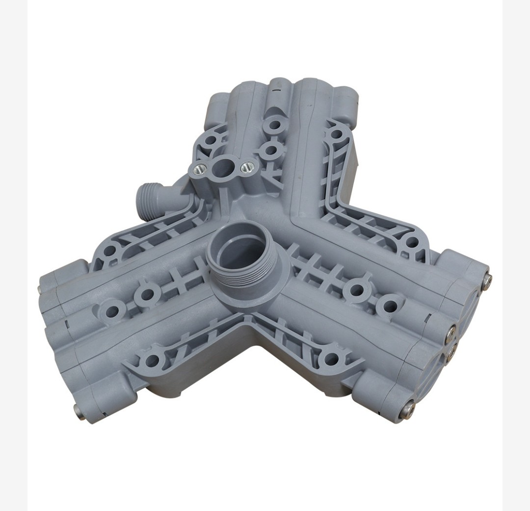

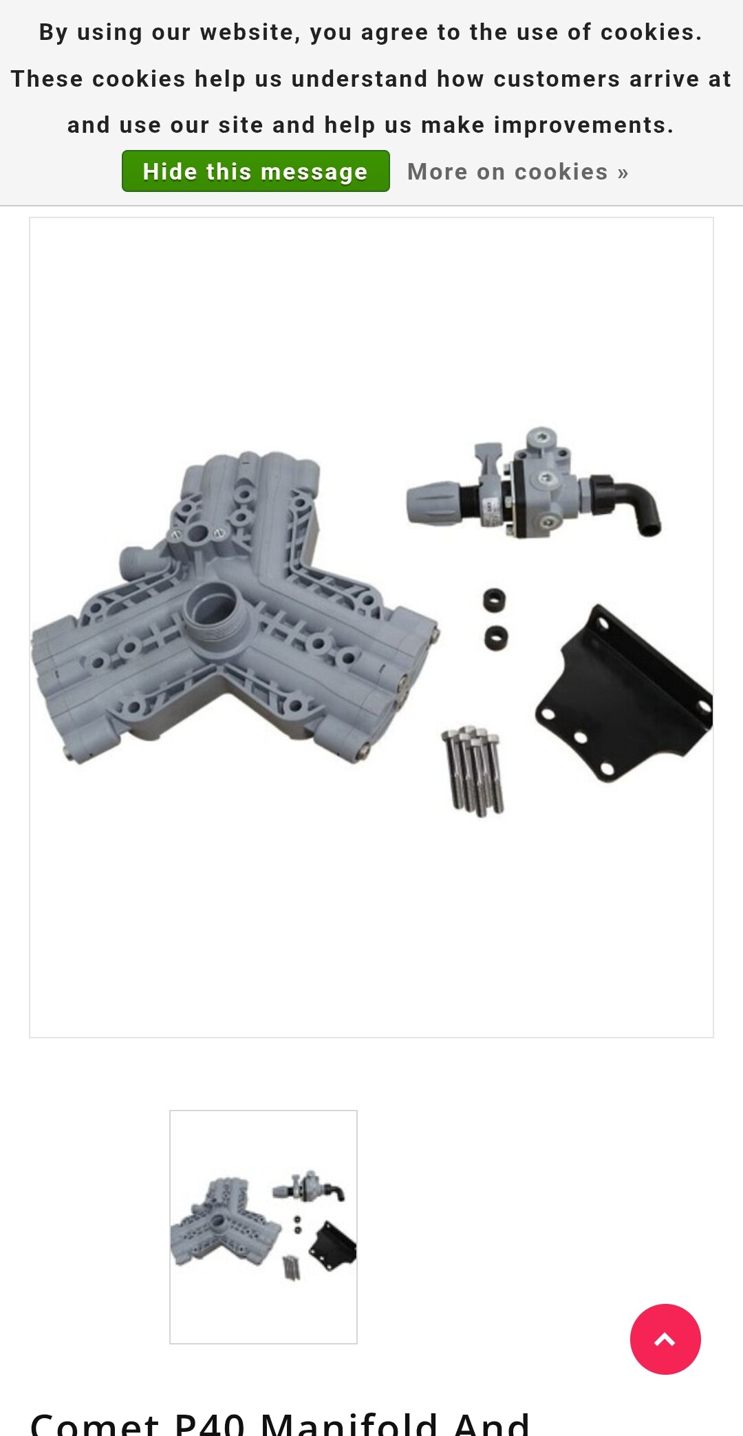

Comet P40 NEW Manifold
Anyone tried installing the new manifold on existing P40 pump?
Or do you need the new pump too?
I guess there is a retro fit kit
Anyone install this on their gas system?
The old one keeps breaking (plastic breakage)

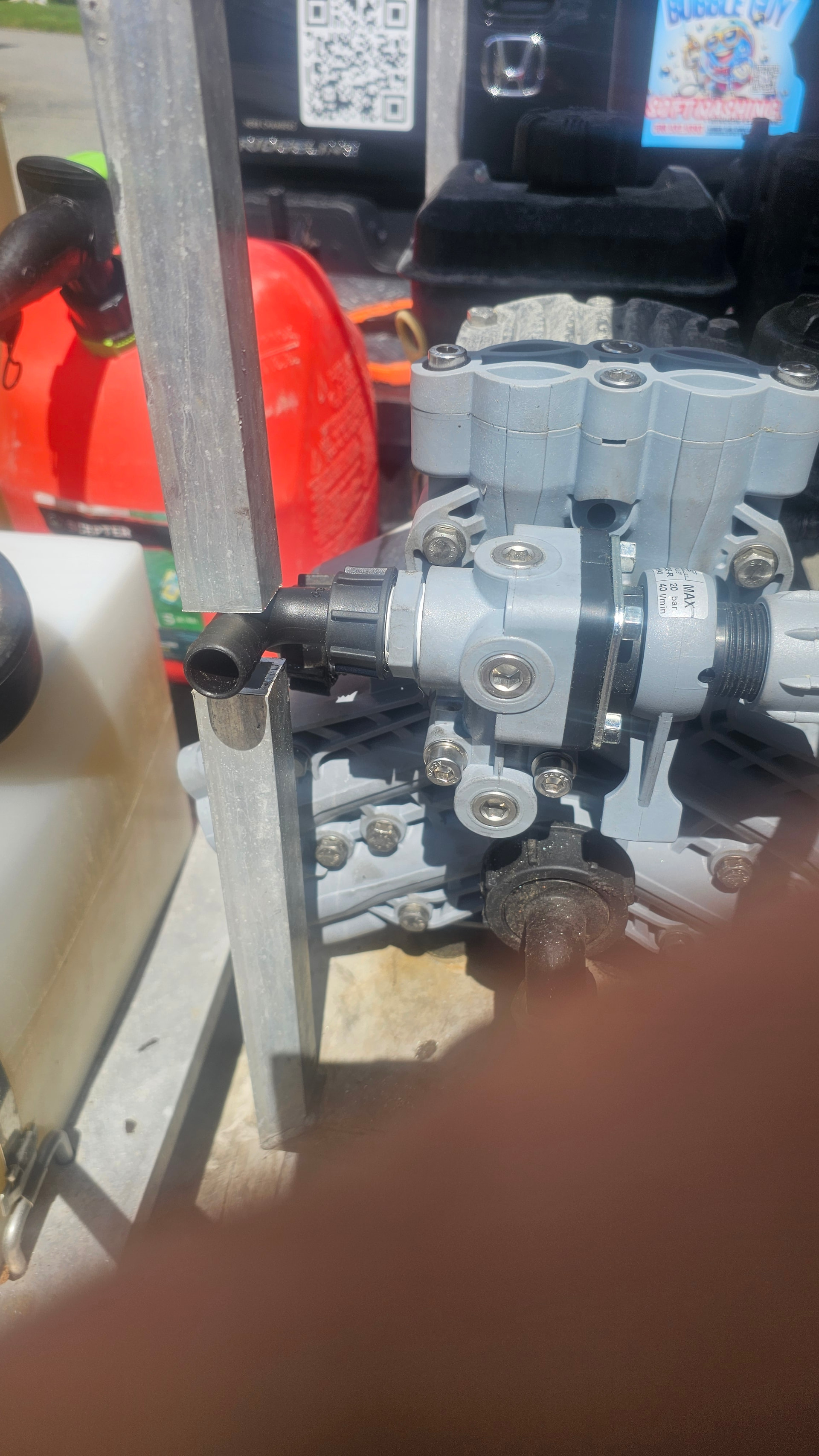

Well, I got the new manifold installed and primed.
After, multiple investigations, the only solution to install the new unloader was to cut my frame for the reel. I later reinforced the post with a metal strip.
But if anyone with the Stallion system and reel, you’ll have to do the same if you upgrade the manifold.
Now that it’s primed, I need to get pressure. But the thing is installed.

The new manifold been working great. Used it on maybe 6 or 7 jobs and a huge condo complex.
