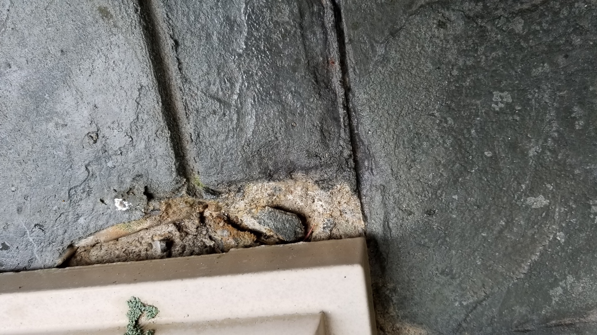

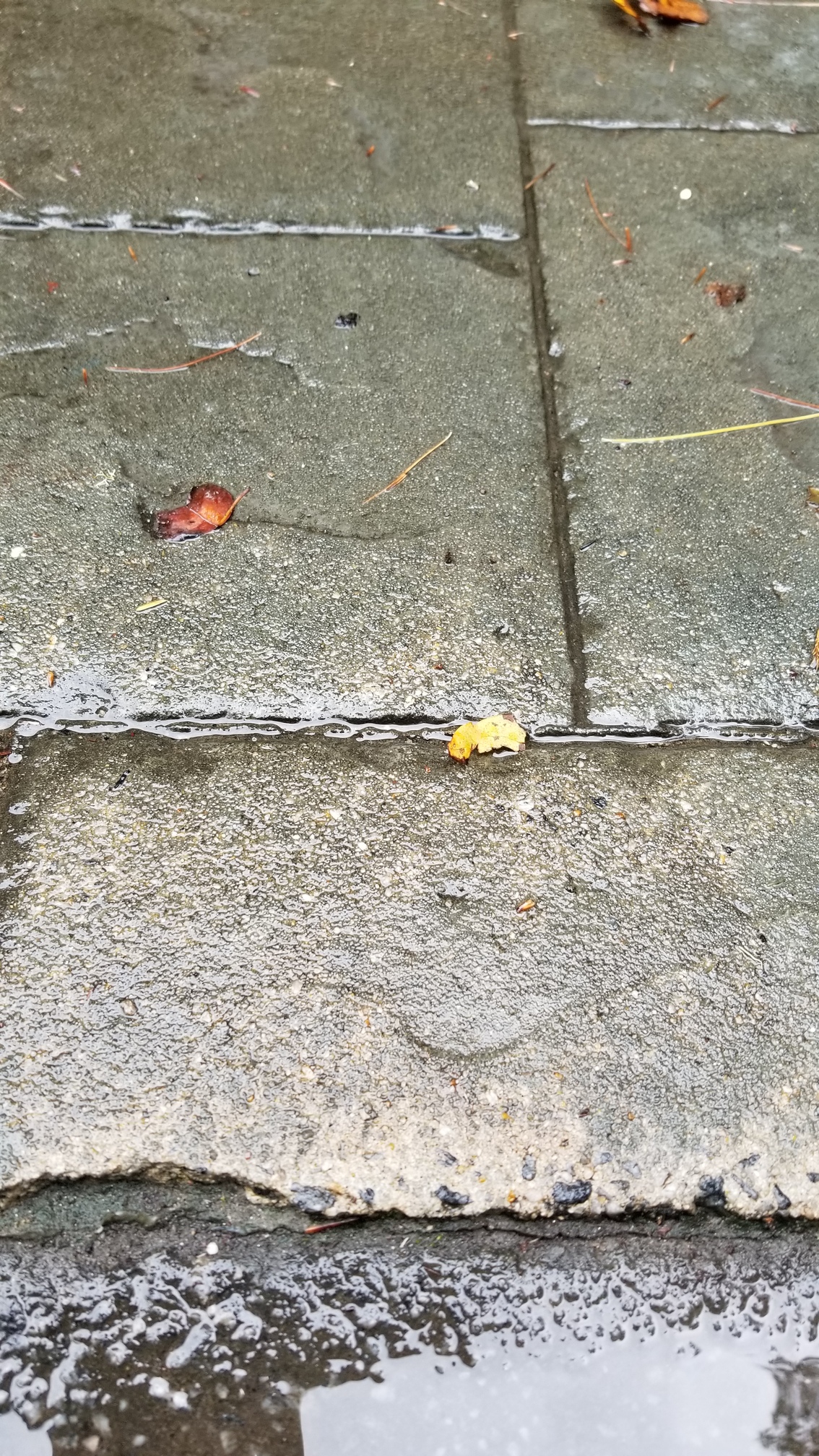

Hi all, I’ve been searching for a couple of hours now but can’t find the info I’m looking for. I’m estimating a house right now and the one part I’m worried about is a stamped concrete walkway, about 200’ long with lots of organics. The owner swears her husband has pw’d it multiple times, and that the concrete itself is colored. But from some of my pics I think it’s a surface-stain that was applied, and it looks like it’s starting to show some aggregate. The finish does not seem like paint, and is not flaking anywhere. But around the cracks I can see the actual color of the concrete.
I was thinking of a 2% pretreat, and dropping my SC down to about 2500 psi or even a touch lower. I’d love it if a pro could weigh in and let me know what they’re thinking on this one, I haven’t seen it before.

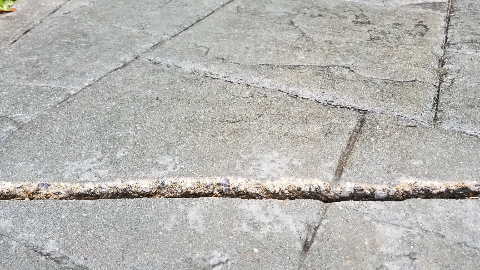

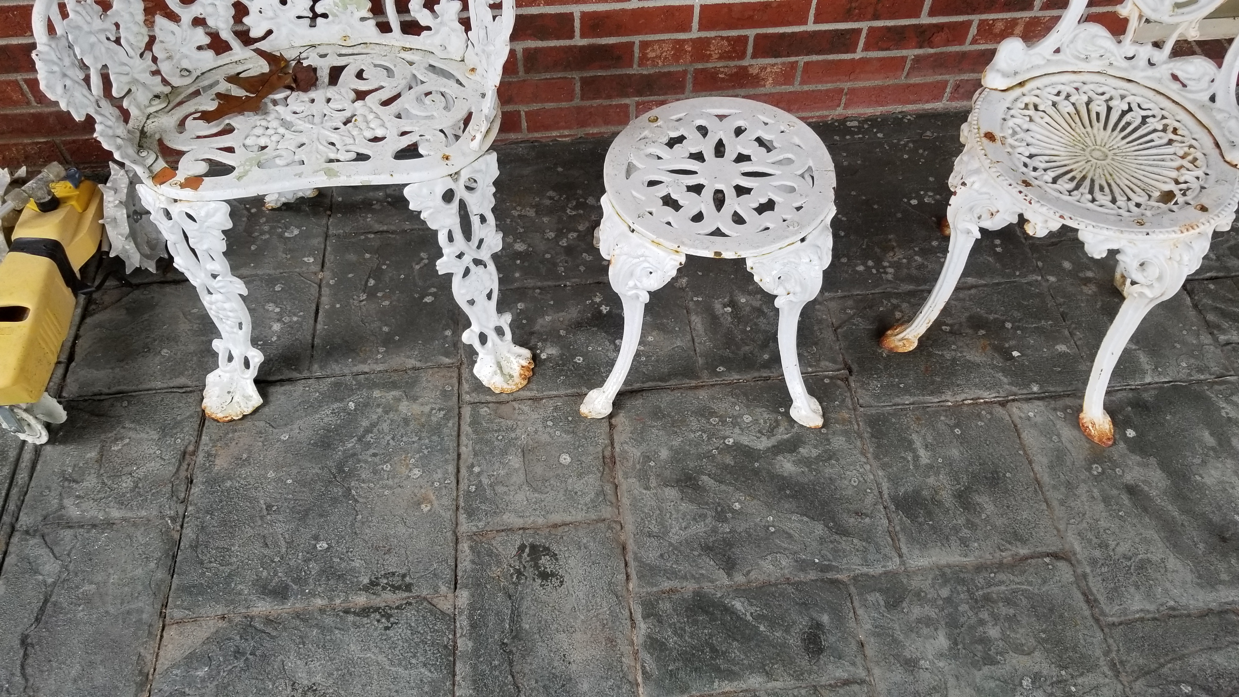

Here’s a couple more; it’s definitely colored intentionally, the grey isn’t just organics.
Should handle the 2% fine, but not even sure you need that strong, doesn’t look all that bad. I’d go a little lower on SC psi, maybe around 2000.
Ok, so interestingly enough I am wrapping up a commercial job that has pretty much exactly the same thing as your pictures. I wasn’t the one in the end to clean it as I hurt my back so I had to call in another company due to timelines. After they finished some of the color was lighter, so I believe you are correct in thinking its a surface stain. I personally would use more in the 1500 psi range with a 2-3% pretreat and give it some good soak time to hopefully avoid taking off less of the stain, but I’m so green at this that could be terrible advice. I wonder what others will say.

I soft wash those…
HW mix

The splotchy color is the sealer fading… Once they stamp the concrete pattern, they add a powder dye, then sealer. I know, cause we poured our own patio with a stamp, color, & solvent sealer 8 years ago. Use HW mix, medium pressure

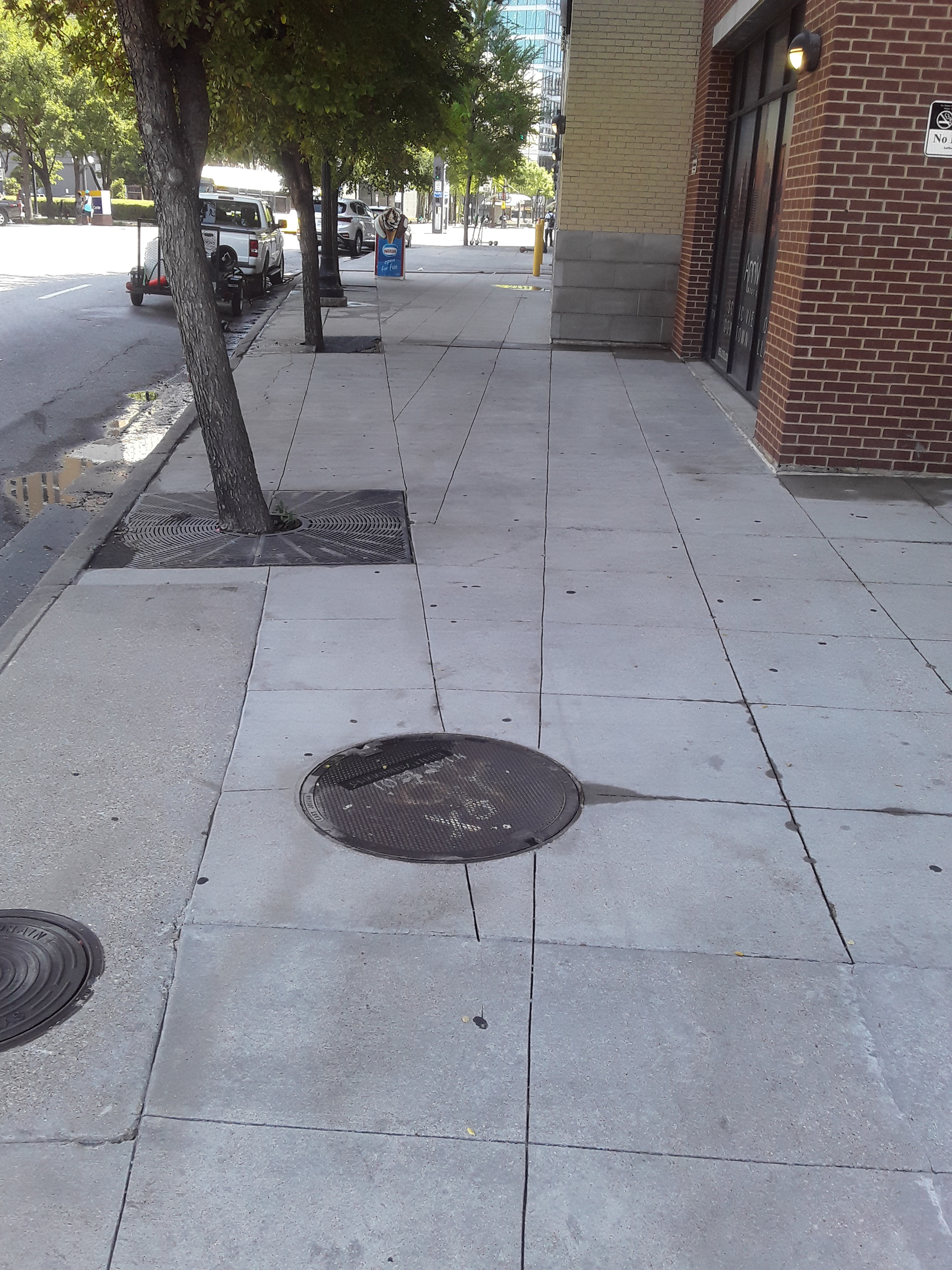

This is a stained sidewalk that I have washed several times. The first time I used 1% sh and it worked good, but a lot of pedestrians made faces at me. So, the second time I downstreamed straight simple green. The simple green worked really good! No organics on it tho.
Looks like good, ole fashion concrete with saw cuts.
Maybe stained with dirt. :smile: I don’t see any coloring at all.
What they wondered why it smelled clean? Care less what they think do what you know is right and stand by it. I get compliments on the bleach smell
It’s a gray stain. There are chips where you can see the natural color.
