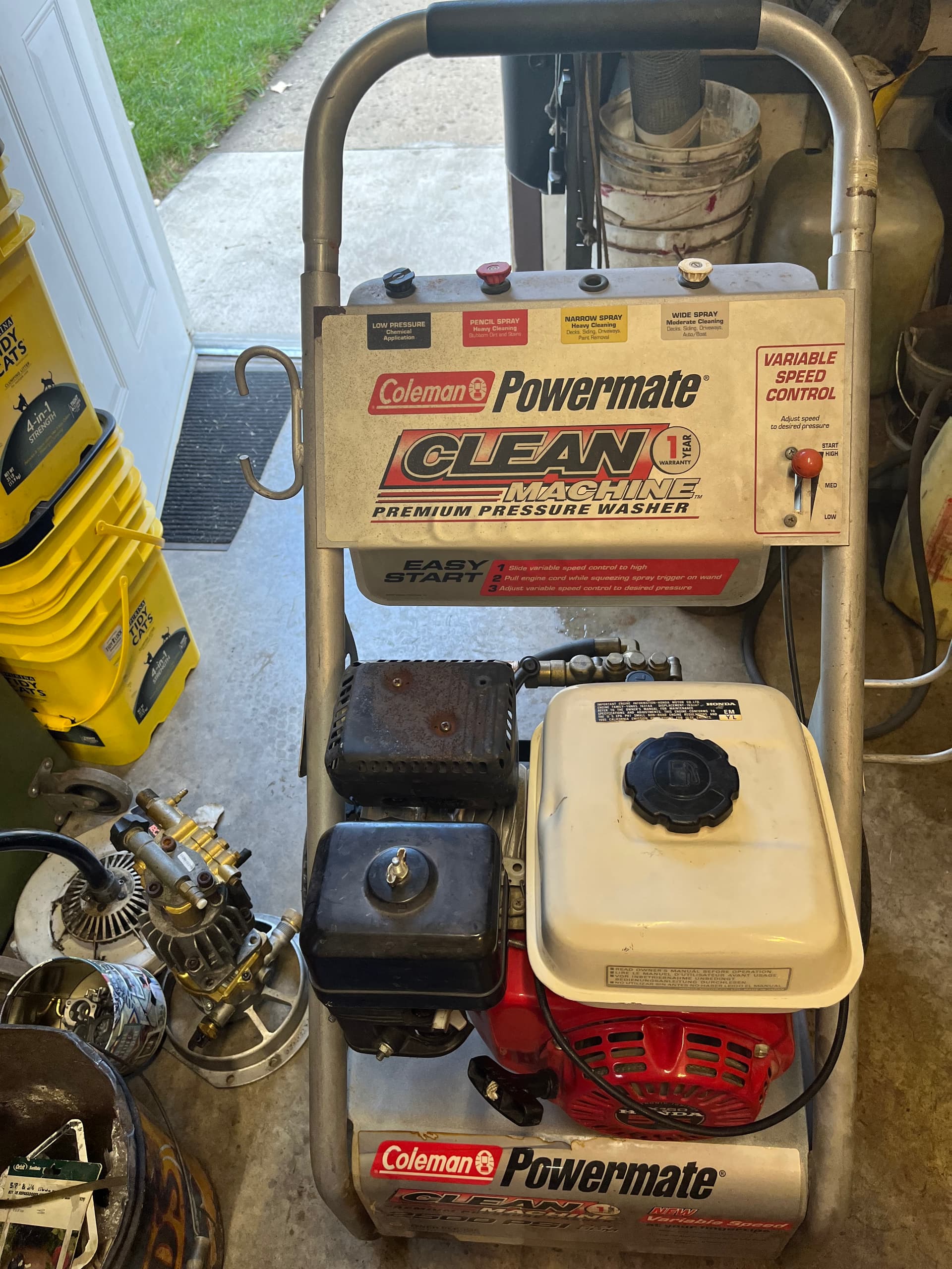

Picked up a Coleman powermate premium v CB lean machine.I believe 2500 psi, 5.5hp honda engine with a gx giant pump.So basically when you hit the trigger pressure has a 2 second delay b4 max pressure.Is this normal? Kinda nice in a way.Also every minute pressure is low fer 2 seconds then back to max. Any ideas?

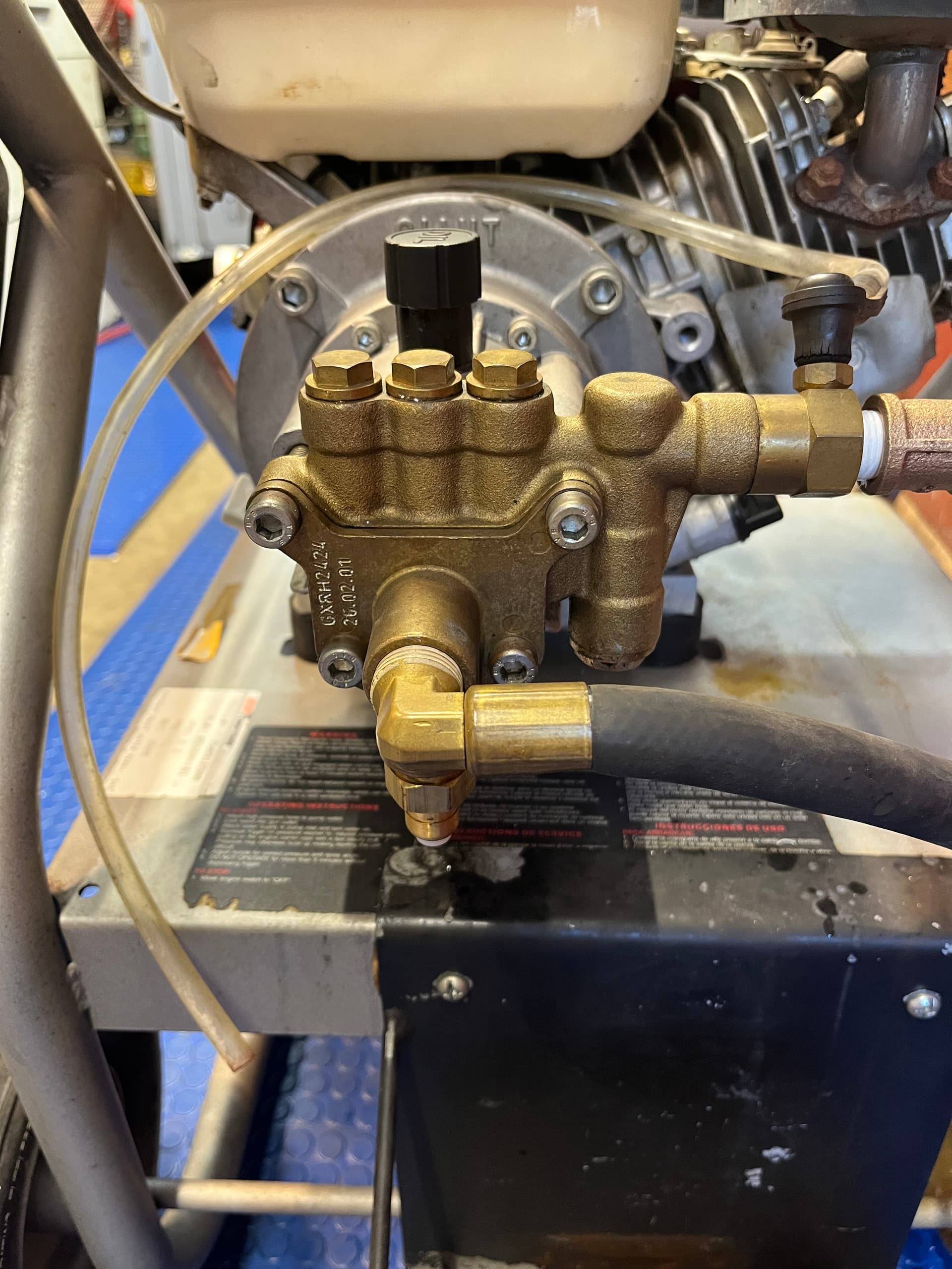

Another pic
Well i think i figged the prob, checked oil in pump and its a cream color which means water so ill assume a seal kit is in order hopefully no t too spendy
