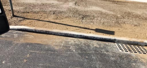

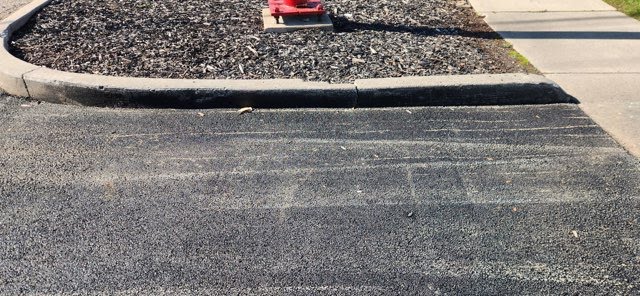

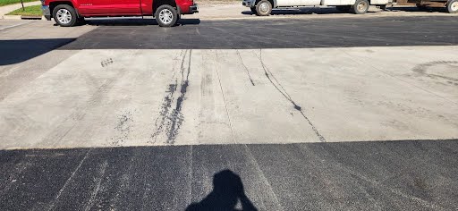

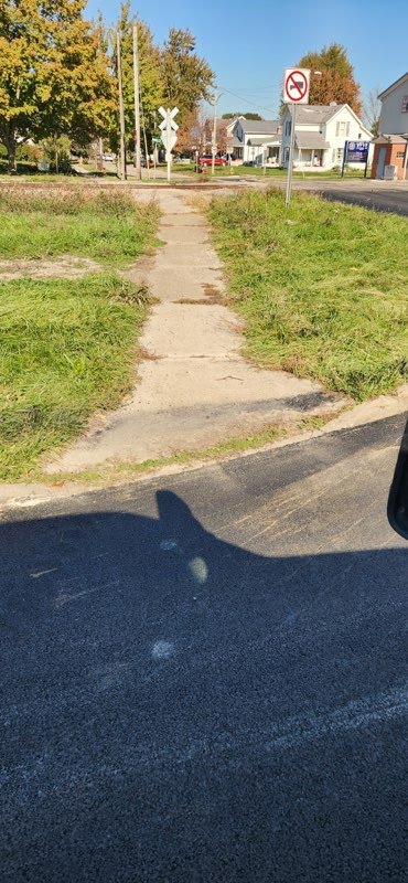

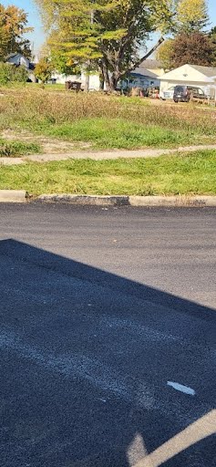

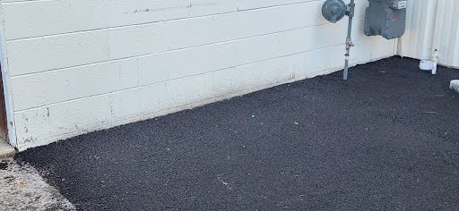

Prospect reached out to me about cleaning up the… I know it’s not called “overspray,” but I don’t know what else to call it… Left behind from this asphalt job. The asphalt was applied 2 weeks ago. How would you go about removing this? Turbo nozzle?

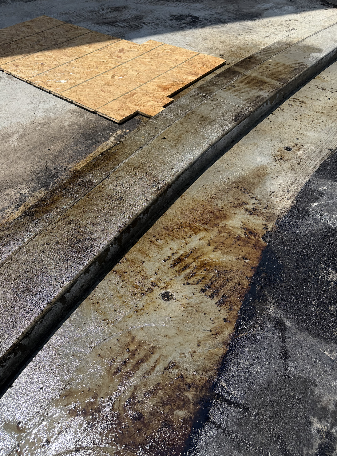

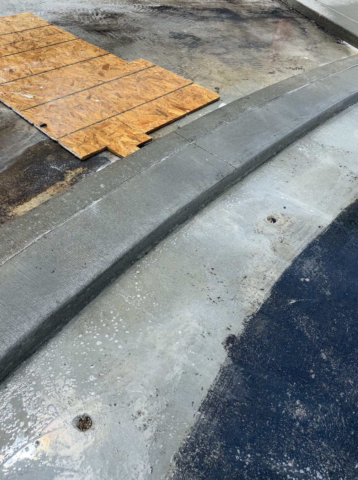

This picture shows the tack once i applied the chem and then the after
Wow, that’s incredible. What chemical did you use?
I don’t remember the name. I just went into the place and asked for tack remover
